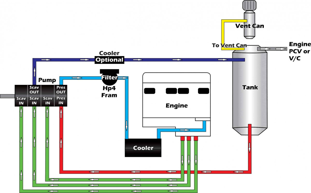

This is the schematic I intend to follow -
I'm not sold on the idea of running the stock pump in line with the external pump, whilst that may have 'been the go' 20 years ago on FH, technology and knowledge has come a long way since. The main selling point of the dry sump system for me is the horse power increase, leaving the old pump in place will cost unnecessary parasitic loss. The idea of redundancy is a good one but I have fantastic idiot lights and guages that tell me when shits going south... And with my speedway brain, I'd probably ignore them if the win was close

Looks about right.
prob not the filter you will be using, but I looked up the Z154 specs and they are full flow. No built in bypass, guess that's coz there is a bypass in the oil filter adapter, that spring loaded ball bearing thing.
I use the syntec ryco filters on my good cars, which they have the meshed pleats, synthetic media which flows higher and lower micron filtering as well. They are built stronger than the OEM ones too for higher oil pressure.
I have tried most of the internet forum "must have performance filters" all were bs and false advertising I might add. I found the ryco synthetic ones in super cheap or repco or some shop an recalled LP uses them on his VP and VR. Indeed they are as advertised.

Yes the Z154 has no bypass filter because it is external, the stock factory oiling system is bypass filtration. It's well known that not all the oil will go through the filter on OEM type oil systems.vlad01 wrote: Thu Feb 08, 2024 4:47 am Looks about right.
That oil filter mount is set up to use a Ryco Z9 (3/4-16 in threads which I believe is the common Ford filter size) or equivalent, a proper decent size filter. They also have the internal bypass.
