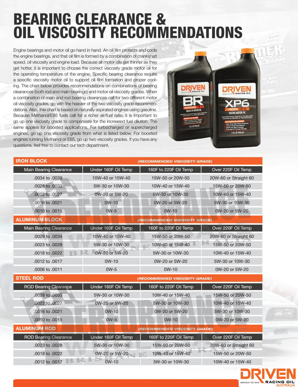

When you look at the V6 bearing clearances then it makes sense they run much thinner oil.
Posts: 8600
Re: VR Ute
According to that chart, 0w10/20.
The V6 runs 0.8- <1.5 thou on the mains. About 1- <1.8 thou on the rods.

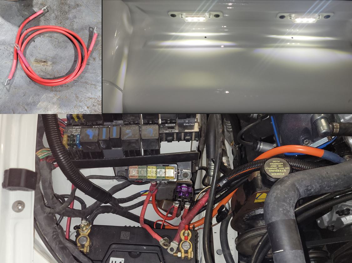

This is the upgraded wiring for the alternator. I know in some vehicles there can be a decent voltage drop across this wire so hopefully this won’t happen here and along with the Maxifuse it’s another dodgy issue with this ute put to bed. 100 amp fuse was the biggest they had locally so that’s what in it for now. I am also not a big fan of having heaps of terminals mounted on the battery positive, so have tried to minimise this and have since crimped the two wires in the one lug. Another way is to run a battery isolator switch if you have the room, but I have made this area too cluttered already by upping the size of the cables – and to be honest I think I have made it look very untidy compared to the factory offering.
I will probably cover that orange earth cable in black heat shrink as it definitely does look out of place.
Another thing I found wrong with this ute was the lights. Apart from the blue H4s and the H1s jammed in the high beams, this ute also had no number plate lights. One light assembly was missing, and the light that was fitted definitely wasn’t from a Commodore. But it was never going to work as the terminals had been cut off so nothing was connected. So I have mounted some generic LEDs in there instead which will get rid of the factory festoons. I don’t think it looks too out of place.

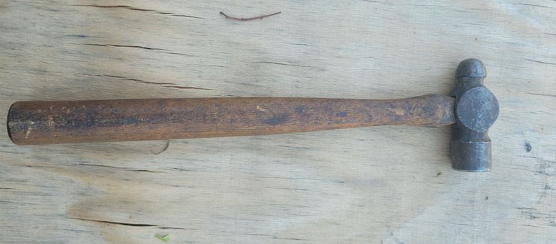

After the discussion on here about gaskets, thought I’d post this up.
I had to make the throttle body gasket and they are not that hard to make. Grab yourself a 3 or 4oz hammer and a small sheet of marine red or Klinger – there’s heaps of options for gasket paper - and it’s easy enough to just tap them out.
In a past life this hammer has knocked out literally 100s of gaskets from timing covers to water pumps, manifolds, sumps, engine covers and exhausts.

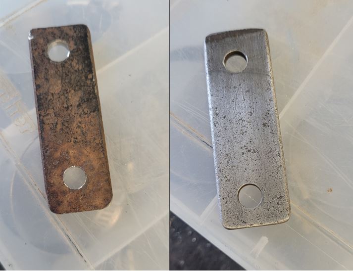

As a side note, I had to make a few brackets so did a little test on some rusty steel. I soaked this piece in CRC Evaporust for a few days then lightly cleaned it up with scotchbrite.
I rate it – it would work pretty good for small parts you can soak.

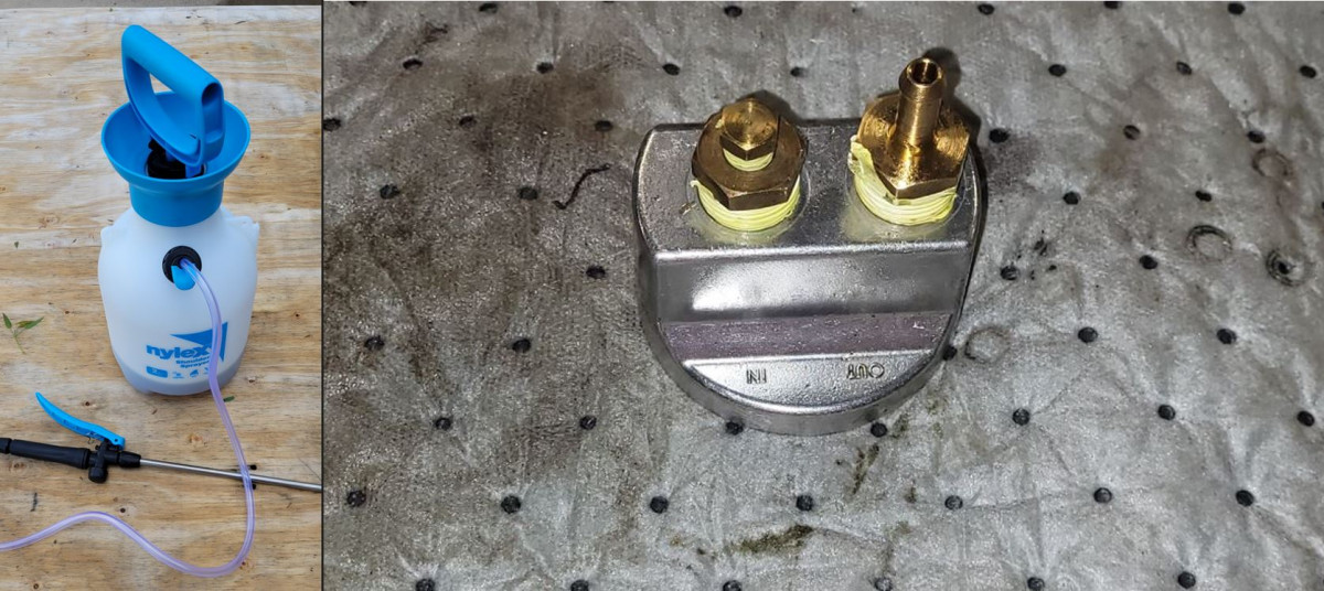

You see/hear of a few people having issues priming Holden v8 oil systems. I have absolutely nothing against packing the gears with Vaseline or assembly grease as this works (and have used the Vaseline in the past myself). But I now use a weed sprayer, which is not my idea, but I think it’s great - it’s cheap, it’s simple and effective and it works. I just bought the cheapest half decent one I could find at Bunnings.
I have an old remote oil filter adapter and use that to connect up to the oil pump in place of the filter and reverse flow oil back through the pick-up to prime the suction - I rotate the engine anti-clockwise back a little as the oil is going in. And with the same adapter, I pressure feed the rest of the oil through the other fitting to prime the oil galleries – so long as the oil is clean this does no harm and I figure the engine won’t make any pressure until the galleries are full anyway. But I leave the priming until the last minute so the oil doesn’t completely wash away all the assembly lube. I am certainly not infallible but the weed sprayer works. I think half the problem is the oil has to go turn up from the pick-up then down into the pump suction. So this dead leg is the part you need to prime which if using Vaseline you haven’t filled that section with oil at all. But any leak on that gasket between the block and the pick-up and the shows over.
I have a mate who has just primed his 304 with a weed sprayer just in through the oil pressure sender hole with the filter in place and it did the lot including the suction in one hit without barring the engine over backwards. With the timing cover off, and cam chain and pushrods removed, he spun the cam with a socket in a cordless drill and confirmed he had oil pressure so clearly it worked.
Anyway that’s Holden v8s for you. No engine is perfect. Everyone might have their own particular method of what works for them and the weeds prayer works for me.
