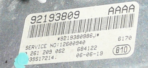

will try and get a pic of the PCM for ya

Re: Memcal ID Tool with Data Version 1.00
2006 VZ SV6 Ute
190kw V6 5 speed Auto
- Posts: 4853
interesting, VY V8 manual is 92111922 wonder if there auto/manual variants or crossover between VY/VZ
