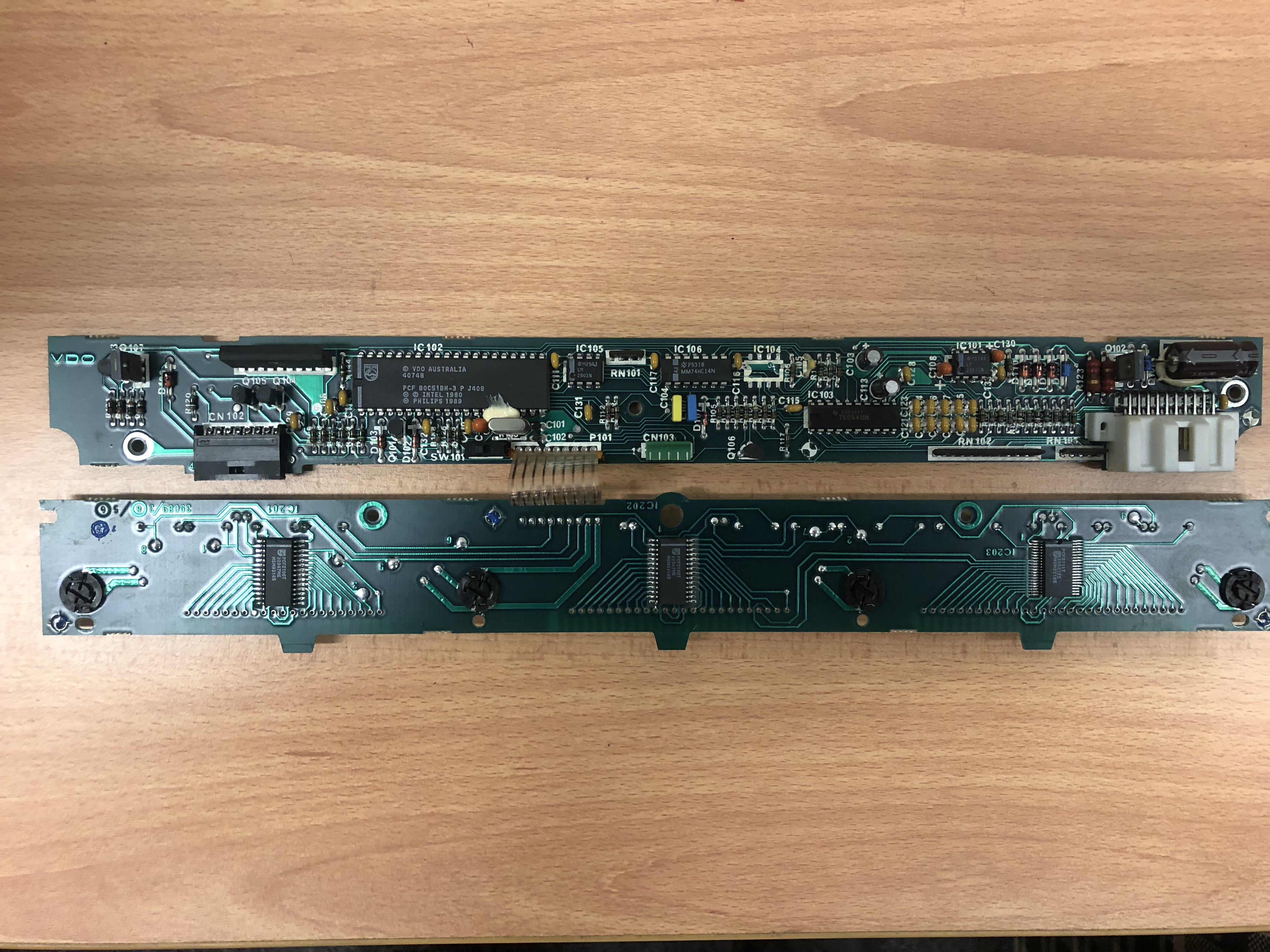

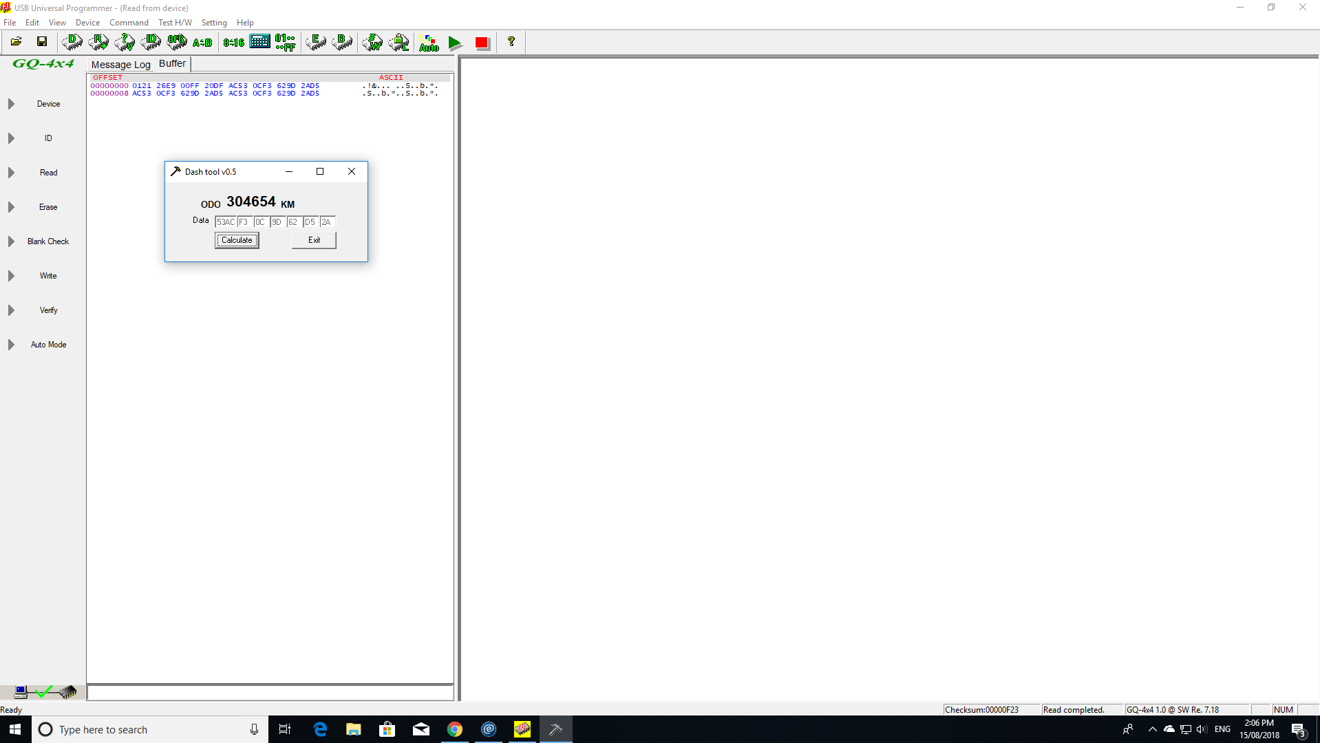

Right, so had a few spare minutes today (chained to the desk) and thought I'd have a play, I pulled the X24c44 and took a read, using the dash tool I loaded the kms from the chip (last observed odometer reading) and don't understand what I'm looking at?? Some of the bits line up but not all, any ideas?
Posts: 2605
oh, to confrim, that chip is from the 104 location...
Posts: 8996
