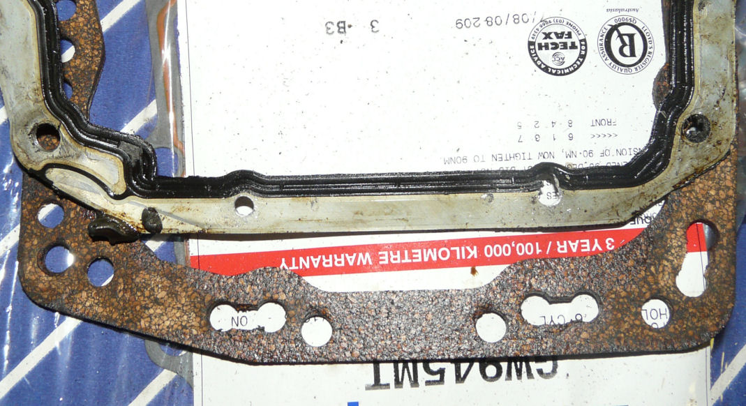

is the gasket type just a gasket with the oring seal on the bottom of it? So it could go on any sump?
Re: The1's Daily
Heres a picture i have which shows what i had to do to make the VN-VR sump work on the ecotec, and its got the ecotec gasket above it ....
the rubber is on both sides on the inside, so should seal the whole way round unless the block bolts are through holes.
it didn't have the rear holes drilled either, but they were in the block and as i used a steel VN-VR sump i added them in the right location to make sure it sealed properly!

I hate those cork gaskets. The OEM is not even cork lol.

The1 wrote:is the gasket type just a gasket with the oring seal on the bottom of it? So it could go on any sump?
should work on all ecotec without O ring groove machined in the sump
Re: The1's Daily
i've never had an issue with a cork gasket if installed properly ?vlad01 wrote:I hate those cork gaskets. The OEM is not even cork lol.
Re: The1's Daily
Could have been replaced before.Holden202T wrote:that doesn't make sense, the motor i put into my torana was from a VS and it had the metal gasket with rubber seal, and i believe it can't have been a VT motor cause it had no EGR on it ??ejukated wrote:VS and early VT use the o-ring. Later models use a gasket
unless its had a pan replaced at some stage in its life.

Re: The1's Daily
The sump gasket was revised in 1999 so a lot of the series 3 got them and series 2 vt onwards.
- Posts: 8122
Re: The1's Daily
I was talking to a tech at Holden yesterday and we were talking after market sump gaskets when he did mention that Holden recalled vs to early vt due to leaky sump o rings. They retro fitted the revised type.

Re: The1's Daily
Yep spot on vlad thats correct.
