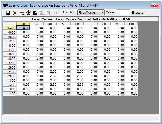

assuming you are using E85 AFR table values, you shouldn't need to change the lean cruise from what a stock VR table is, generally the numbers range from .2 up to 2 or so .... which means it adds that amount to the open loop AFR table for that load point.....
as far as what is best for your motor is hard to say, but generally if you can feel lean cruise turn on its making it too lean, it feels like a little stumble like its missing .... hard to explain.....
below is the standard settings from $11P CAKH bin file for lean cruise.
you'd probably want to change them to maybe 1.5-1.6 for E85 which if your targetting 9.7 at cruise this would make it 11.2-11.3 target AFR in your logs.
also depending on your cam and diff gearing you might not want it enabling that low in the revs....
but honestly, don't even think about enabling lean cruise till your tune is 100% sorted in the AFR and VE tables for E85, as like the others have said, your just asking to burn shit up!

Ok cool thank you 202 thats what i thought it may do hency y it targets a lean af i have no need for lean cruise atm id rather spend my time sorting out this 0-100kpa map as is and with the e85 afrs in place before attempting to use it
One other question i have is what are all the afr tables that need to be changes i know of the 0-100kpa and the boost map but the only other one i know of was the idle afr is there any other afr tables that are there so when im ready to change them all over i can make sure that i get them all
