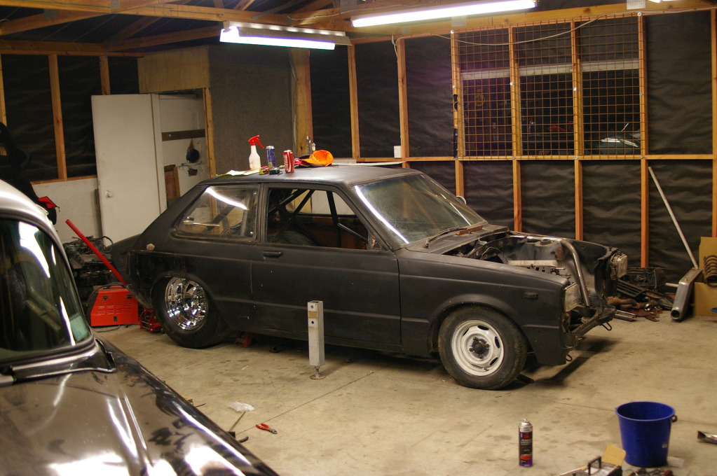

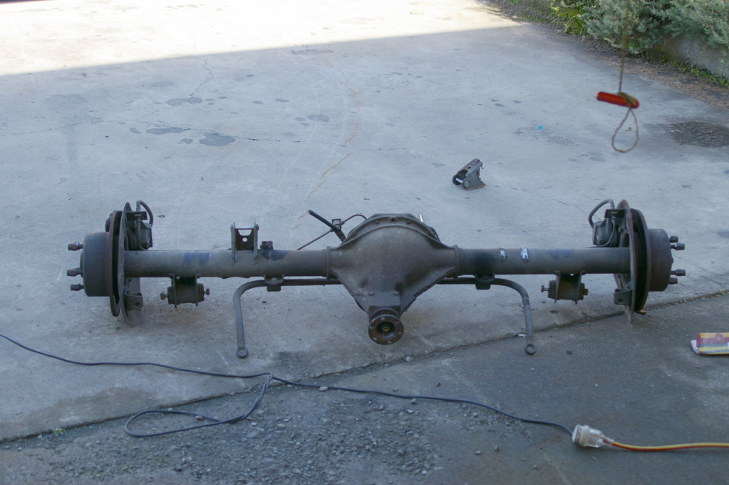

haha yeah its like 900mm flange to flange LOL took 275mm off each end

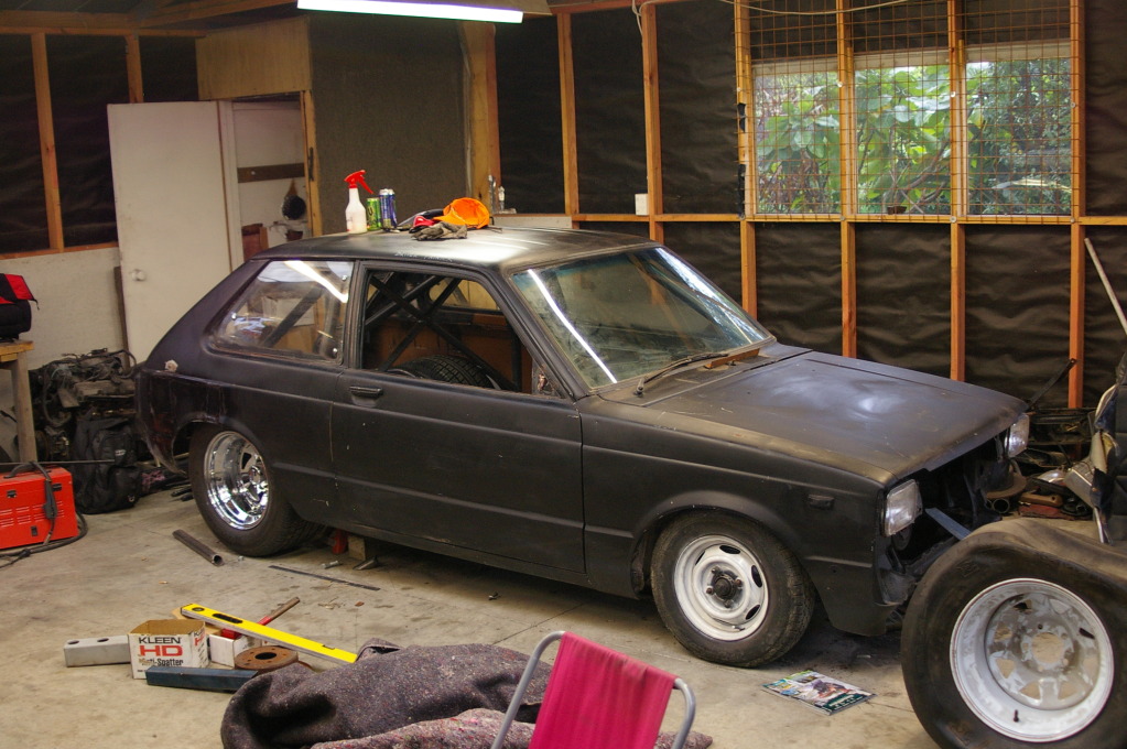

back into work on the starlet have a month before it has to be out the shed so going hard getting it all on suspension and the motor fitted.

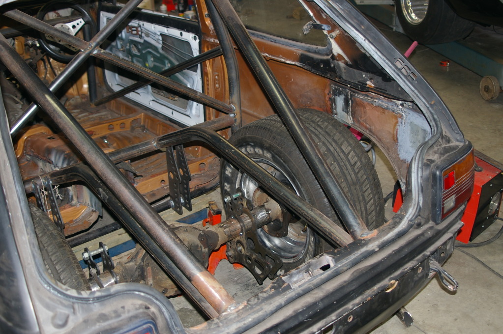

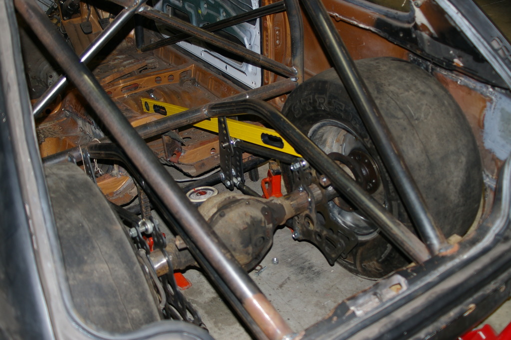

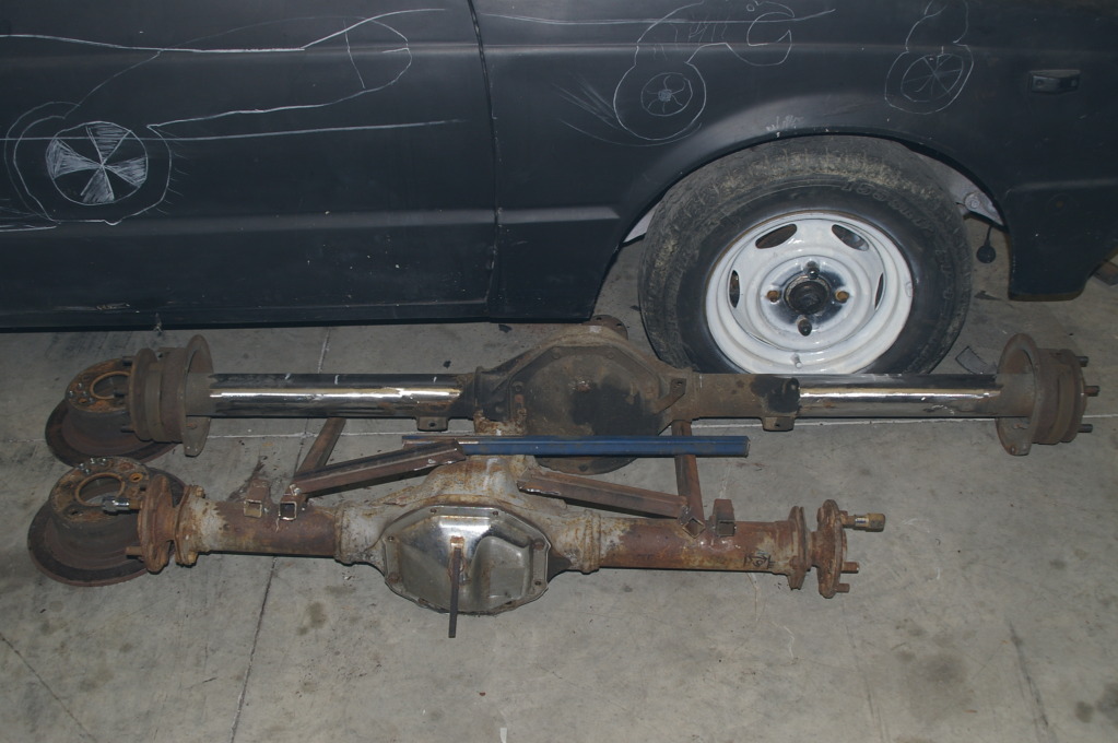

first on the list the diff .it took ages to get it all cleaned of mounts etc
quite a bit too long compared to mock up diff LOL

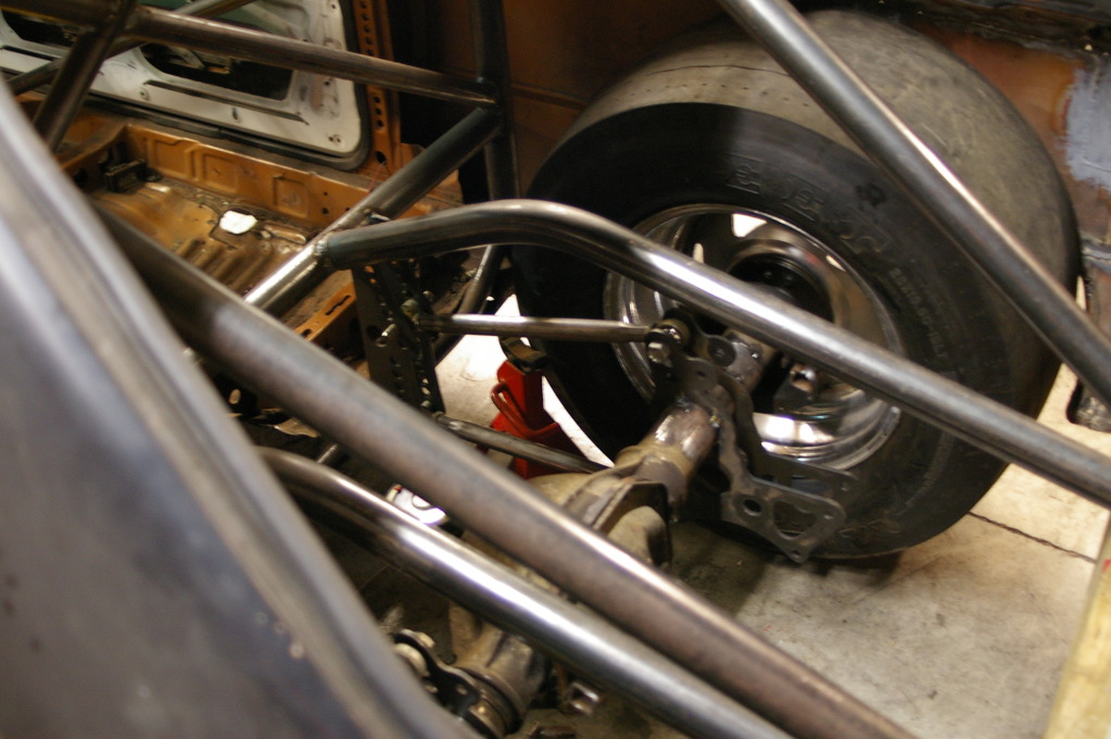

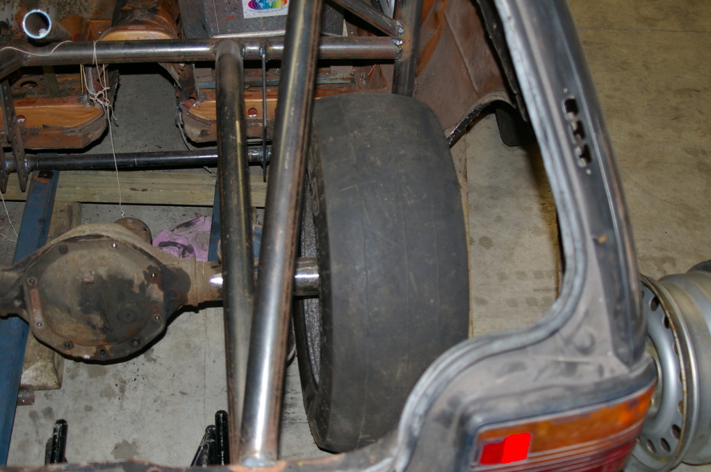

after a bit more trimming and chopping here it sits freshly cut 4 bar mounts slid on and cut to length
sideon

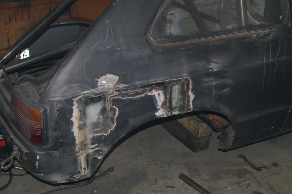

now that the diffs out ive welded in all the guard patches fully

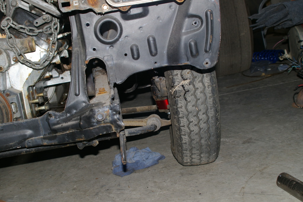

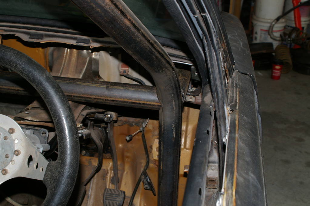

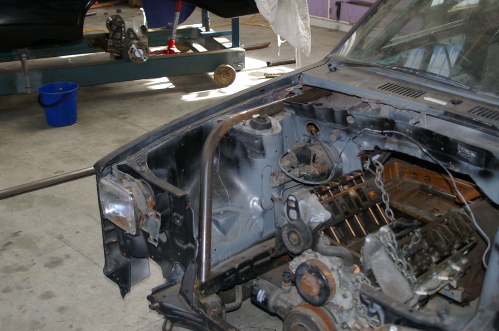

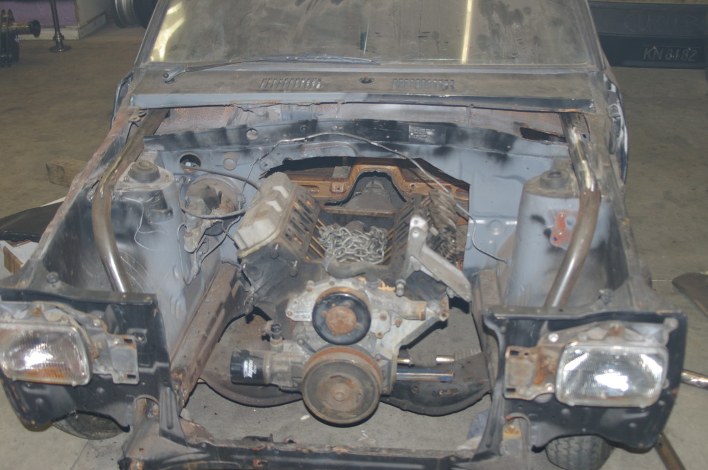

also started fitting some more bars in the front

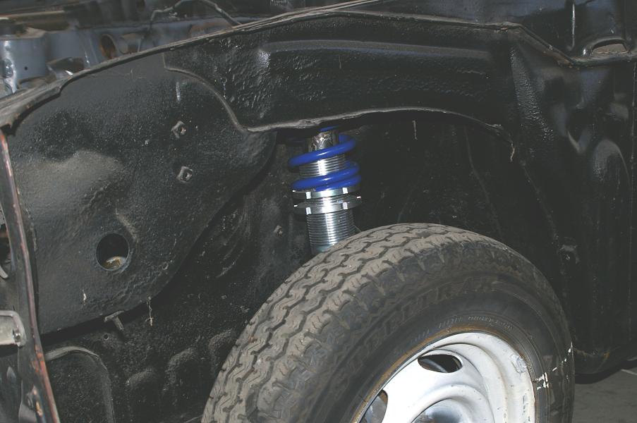

and fitted my RCA's and coilovers in the front have to remove the 2 in 1 antiroll bar/ radius rod for something more suitiable

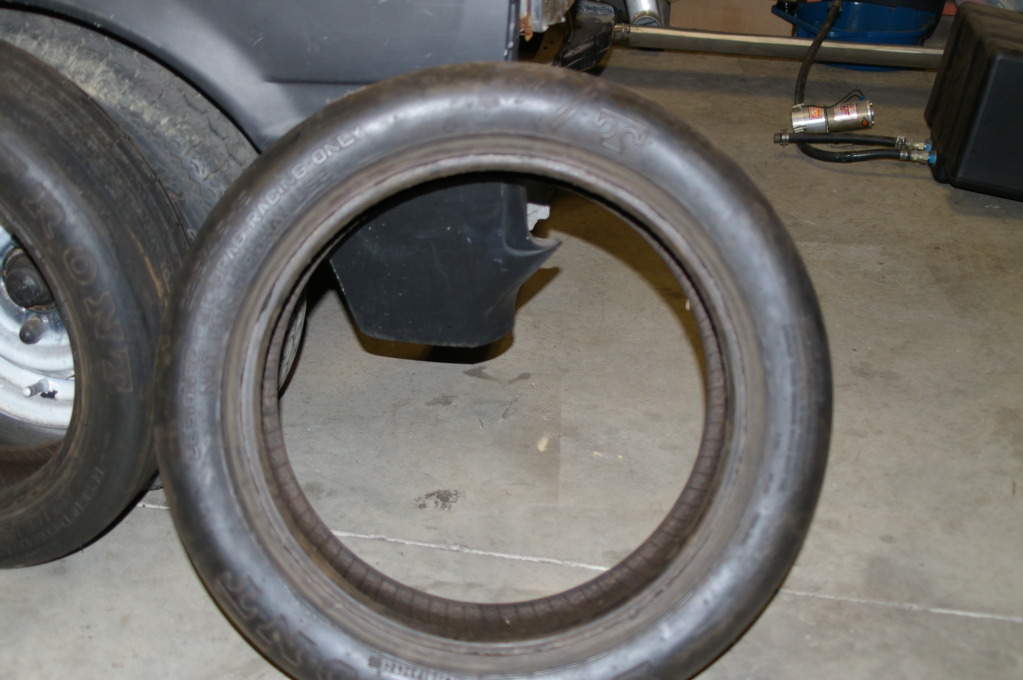

next on the 2 get list widened rims heres 7" vn wheels with 26" drag tyres like the vb runs obviously wrong offset and not wide enough LOL

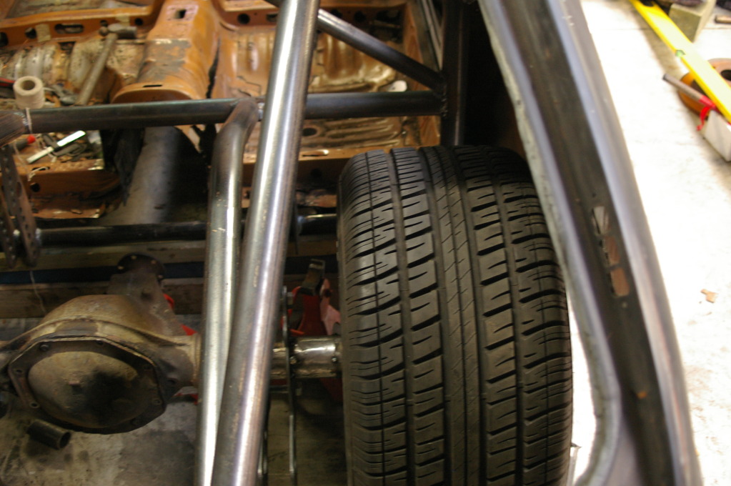

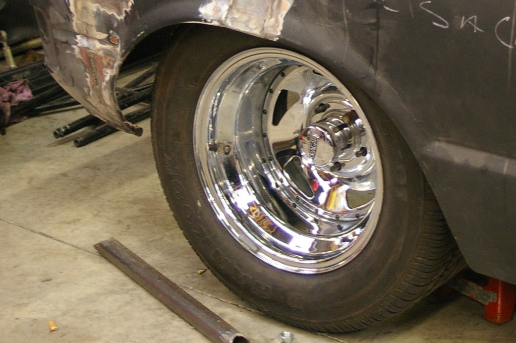

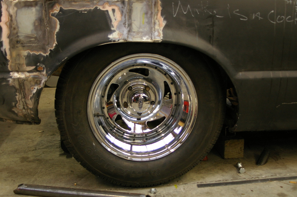

new 10 inch rear wheels bought bonus they are fitted with new 295/50/15's street tyres :mrgreen:

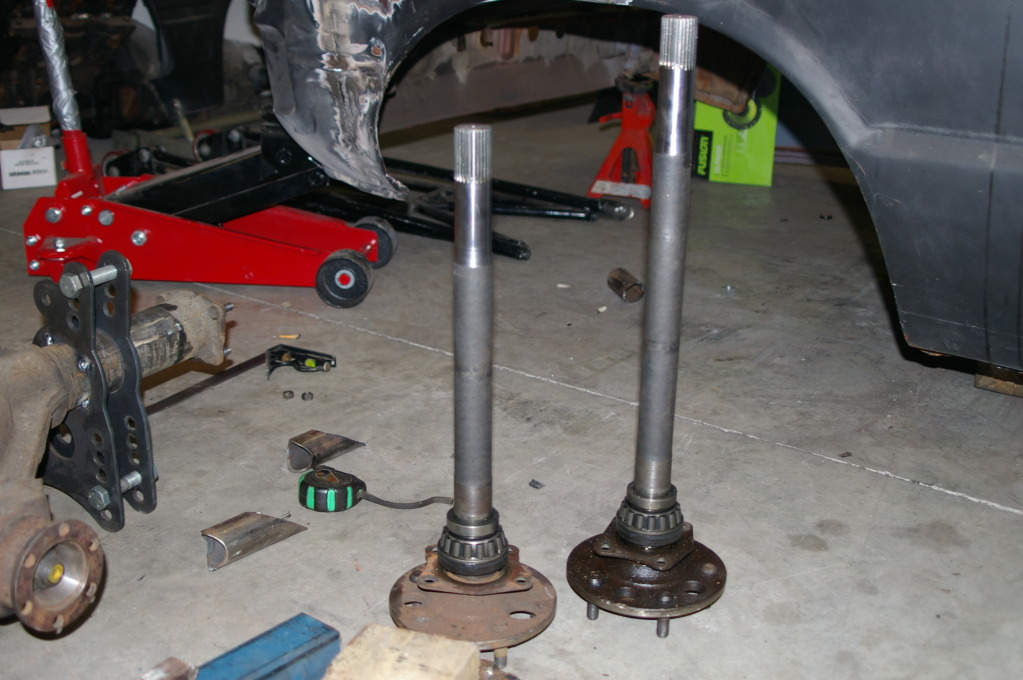

axles
engine is also mounted and my 4 bars should be ready tomorrow

are the axles 31 spline ? (looks like it from the size of the main shaft)
Posts: 5630
Re: DELCOS NEW RIDE
nah 28 spline still.when i go fast enough to warrent 31 spline ill get a full spool made and some new axles

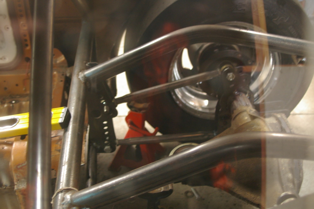

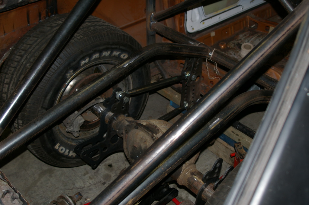

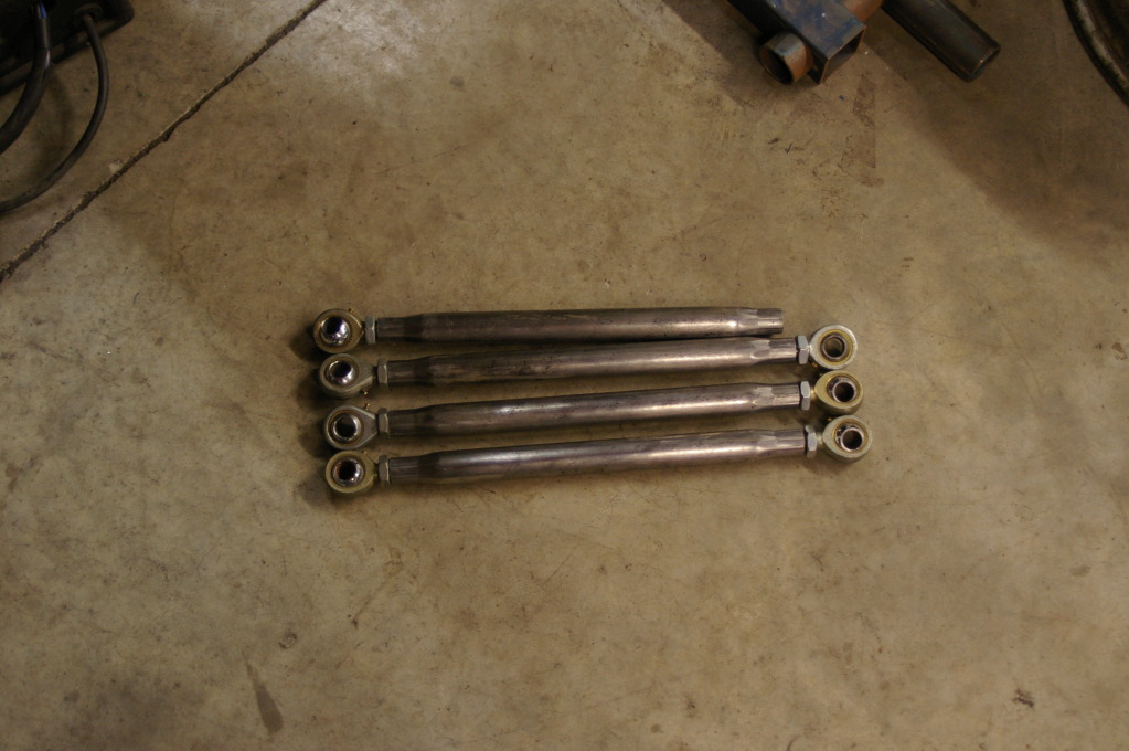

bars arrived :D
all measures perfect 2 degree pinion angle level lower bar and an I.C (instant centre) right where the grey jig leg is, perfect :driving:
