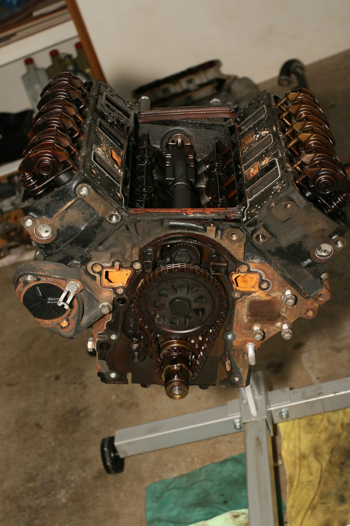

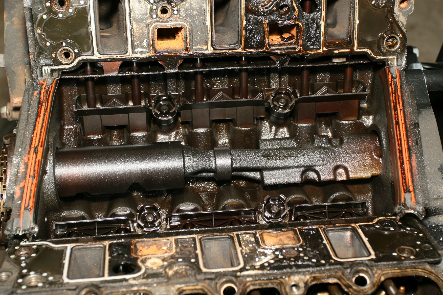

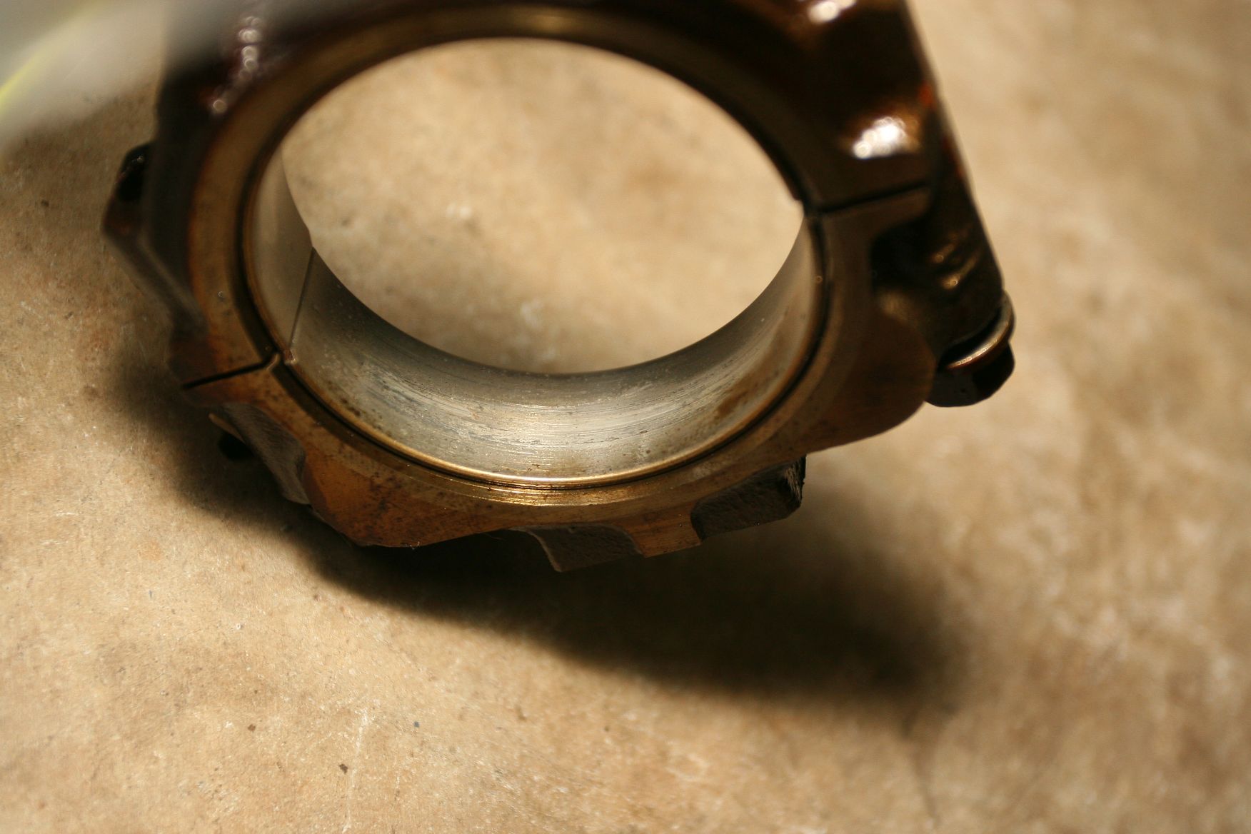

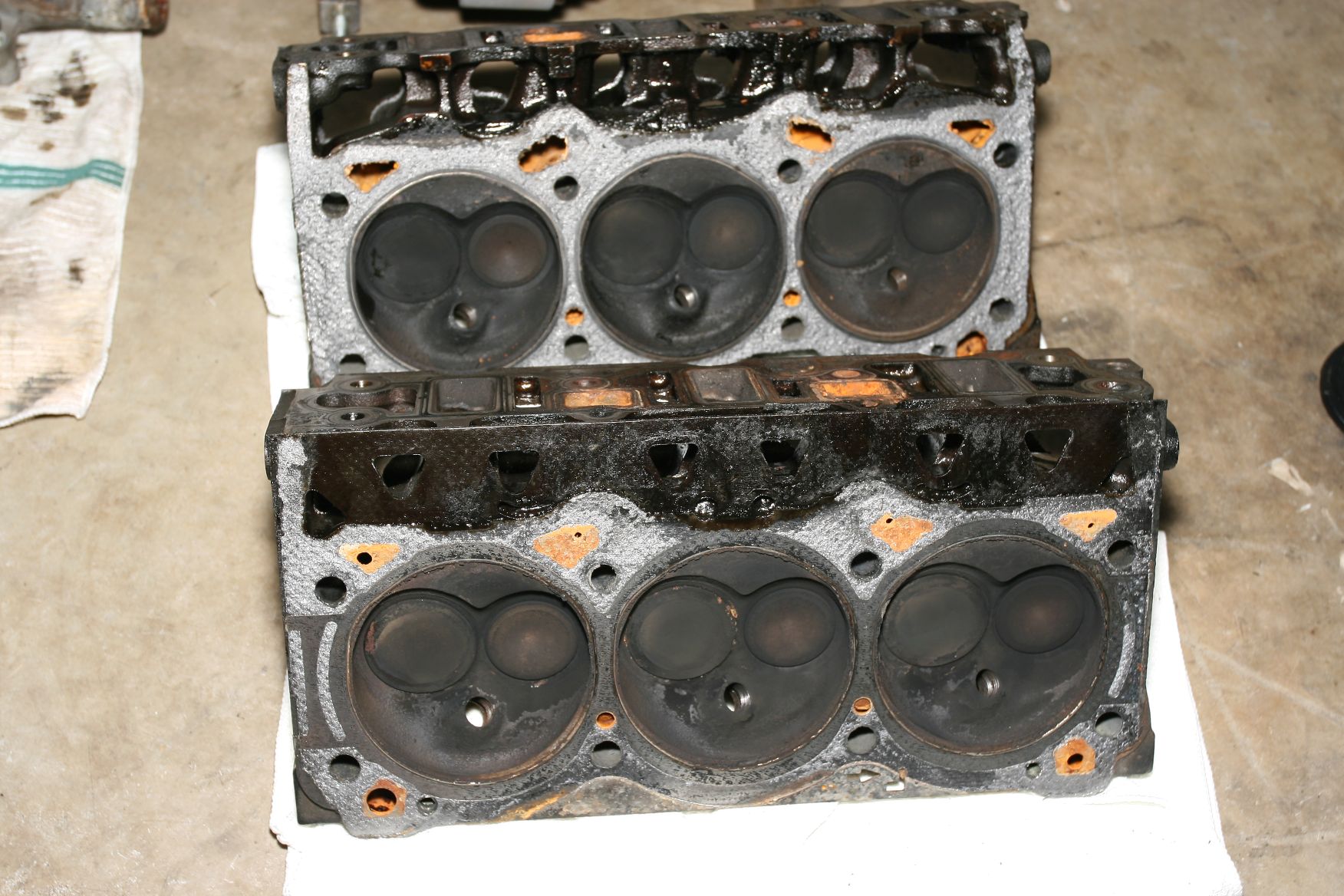

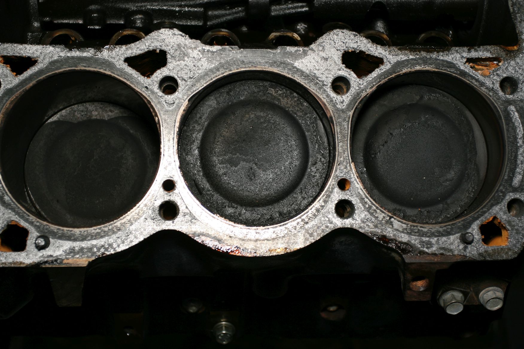

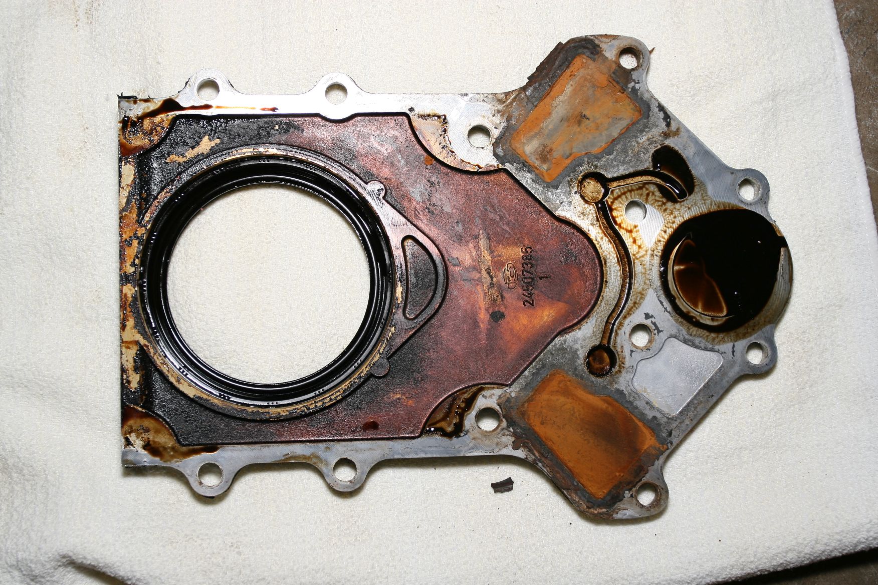

pulled the L67 down, only crank and ballance shaft left to get out, only #6 spun bigend bearing. Though havn't pulled the Main caps off yet. I wouldn't say the bolts on the mains both cap and side were tight, side ones were like butter. So perhaps allowed the crank to move back and forward?
Gaskets shot as expected for plastic ones, looks clean the internals All lifters look ok, though not sure inside i have new ones anyway #6 on the left who did the bigend #6 top end looks different colour, like its was running hotter? Would have been out of timing with bearing gone? Other side head/pistons Cam #3 & 4 are like this, the others are ok (just lack of oil cause this?)
