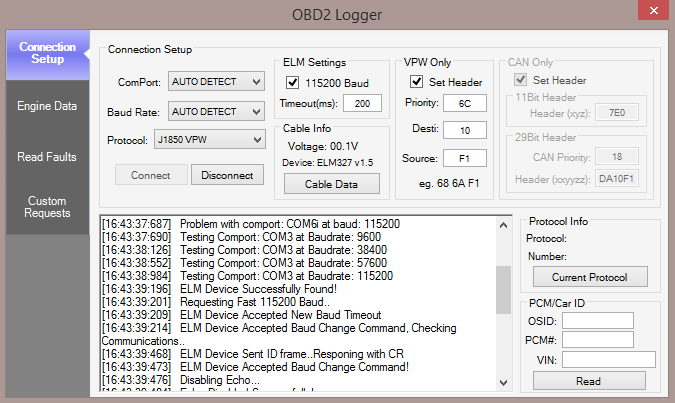

Did a little bit of work on the obd2 app today. The autoconnect feature should work great. I actually noticed a couple of my bluetooth comports popping up as "4i,6i" ect so it even accommodates for any unavailable ports.
And initiating the 115200 baud should work much better now. Some ELM clones dont actually accept the commands, so this feature must be turned off!
Should hopefully fixup anyone having issues with connecting or monitoring all data.
And, currently Im only working on the VPW protocol as I only have access to a ls1 pcm!

Few little errors in the recent one I added.. forgot to add the header updater to automatically do all header changes between requesting vin, faults ect. Will update with latest version soon, just adding a few last things.
Also, the engine data reading looks to be sitting at around 45-60pids/s.
Could probably increase that with some threading of the control updates.. and it will probably severely diminish if I dont thread the gauge updates too. Currently it only reads engine temp and coolant temp. But the "custom send" function works correctly now too so custom sends can be done from there.
If anyone is having issues with connecting, please post up any issues! Iv tried it on 4 lappys here and seems to be running strong!. But not all ELM devices are the same or support the same commands, so be good to be able to add some sort of feature/bypass for those.

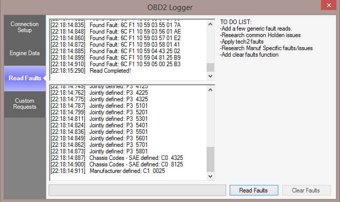

Heres the faults that the app pulls from a PCM on bench:
[22:02:32:362] Manufacture defined: P1 0125
[22:02:32:372] Manufacture defined: P1 0225
[22:02:32:386] Manufacture defined: P1 0325
[22:02:32:398] Manufacture defined: P1 0725
[22:02:32:411] Manufacture defined: P1 0825
[22:02:32:423] Manufacture defined: P1 1201
[22:02:32:439] Manufacture defined: P1 1325
[22:02:32:449] Manufacture defined: P1 1701
[22:02:32:462] Manufacture defined: P1 1825
[22:02:32:475] Manufacture defined: P1 2125
[22:02:32:487] Manufacture defined: P1 2225
[22:02:32:500] Manufacture defined: P1 2301
[22:02:32:513] Manufacture defined: P1 2525
[22:02:32:525] Manufacture defined: P1 3125
[22:02:32:537] Manufacture defined: P1 3225
[22:02:32:549] Manufacture defined: P1 3425
[22:02:32:562] Manufacture defined: P1 5125
[22:02:32:575] Manufacture defined: P1 5225
[22:02:32:587] Manufacture defined: P1 5425
[22:02:32:599] Manufacture defined: P1 7125
[22:02:32:612] Manufacture defined: P1 7225
[22:02:32:625] Manufacture defined: P1 7425
[22:02:32:636] Manufacture defined: P1 7525
[22:02:32:649] SAE defined: P2 3025
[22:02:32:660] Jointly defined: P3 2525
[22:02:32:673] Jointly defined: P3 2725
[22:02:32:685] Jointly defined: P3 3225
[22:02:32:697] Jointly defined: P3 3525
[22:02:32:710] Jointly defined: P3 3625
[22:02:32:721] Jointly defined: P3 4125
[22:02:32:733] Jointly defined: P3 4225
[22:02:32:746] Jointly defined: P3 4325
[22:02:32:758] Jointly defined: P3 5101
[22:02:32:770] Jointly defined: P3 5201
[22:02:32:783] Jointly defined: P3 5301
[22:02:32:795] Jointly defined: P3 5401
[22:02:32:808] Jointly defined: P3 5501
[22:02:32:820] Jointly defined: P3 5601
[22:02:32:835] Jointly defined: P3 5701
[22:02:32:848] Jointly defined: P3 5801
[22:02:32:867] Chassis Codes - SAE defined: C0 4325
[22:02:32:875] Chassis Codes - SAE defined: C0 8125
[22:02:32:885] Manufacturer defined: C1 0025

Ahh... now Im confused whether I read that right?
So looking at the first fault: 6C F1 10 59 01 01 25 F9
Is the fault code P0125?
Is byte 5 (start at 1)the byte that designates P1,P2,C1 ect. Or is that the upper nibble of byte 6, and the fault is the lower nibble of byte 6 plus byte 7?
As seen in this log dump, not sure what byte 5 is exactly designating, is it identifying a specific component?
[10:28:00:958] Found Fault: 6C F1 10 59 01 01 25 F9
[10:28:00:970] Found Fault: 6C F1 10 59 01 02 25 2D
[10:28:00:982] Found Fault: 6C F1 10 59 01 03 25 61
[10:28:00:995] Found Fault: 6C F1 10 59 01 07 25 4C
[10:28:01:007] Found Fault: 6C F1 10 59 01 08 25 EF
[10:28:01:020] Found Fault: 6C F1 10 59 01 12 01 6A
[10:28:01:032] Found Fault: 6C F1 10 59 01 13 25 D5
[10:28:01:044] Found Fault: 6C F1 10 59 01 17 01 0B
[10:28:01:057] Found Fault: 6C F1 10 59 01 18 25 5B
[10:28:01:070] Found Fault: 6C F1 10 59 01 21 25 8C
[10:28:01:082] Found Fault: 6C F1 10 59 01 22 25 58
[10:28:01:094] Found Fault: 6C F1 10 59 01 23 01 E7
[10:28:01:107] Found Fault: 6C F1 10 59 01 25 25 A1
[10:28:01:119] Found Fault: 6C F1 10 59 01 31 25 38
[10:28:01:132] Found Fault: 6C F1 10 59 01 32 25 EC
[10:28:01:144] Found Fault: 6C F1 10 59 01 34 25 59
[10:28:01:157] Found Fault: 6C F1 10 59 01 51 25 A7
[10:28:01:169] Found Fault: 6C F1 10 59 01 52 25 73
[10:28:01:181] Found Fault: 6C F1 10 59 01 54 25 C6
[10:28:01:194] Found Fault: 6C F1 10 59 01 71 25 D2
[10:28:01:206] Found Fault: 6C F1 10 59 01 72 25 06
[10:28:01:219] Found Fault: 6C F1 10 59 01 74 25 B3
[10:28:01:231] Found Fault: 6C F1 10 59 01 75 25 FF
[10:28:01:243] Found Fault: 6C F1 10 59 02 30 25 F8
[10:28:01:256] Found Fault: 6C F1 10 59 03 25 25 A2
[10:28:01:268] Found Fault: 6C F1 10 59 03 27 25 3A
[10:28:01:281] Found Fault: 6C F1 10 59 03 32 25 EF
[10:28:01:293] Found Fault: 6C F1 10 59 03 35 25 16
[10:28:01:306] Found Fault: 6C F1 10 59 03 36 25 C2
[10:28:01:318] Found Fault: 6C F1 10 59 03 41 25 10
[10:28:01:330] Found Fault: 6C F1 10 59 03 42 25 C4
[10:28:01:343] Found Fault: 6C F1 10 59 03 43 25 88
[10:28:01:355] Found Fault: 6C F1 10 59 03 51 01 57
[10:28:01:368] Found Fault: 6C F1 10 59 03 52 01 83
[10:28:01:380] Found Fault: 6C F1 10 59 03 53 01 CF
[10:28:01:392] Found Fault: 6C F1 10 59 03 54 01 36
[10:28:01:405] Found Fault: 6C F1 10 59 03 55 01 7A
[10:28:01:419] Found Fault: 6C F1 10 59 03 56 01 AE
[10:28:01:431] Found Fault: 6C F1 10 59 03 57 01 E2
[10:28:01:443] Found Fault: 6C F1 10 59 03 58 01 41
[10:28:01:456] Found Fault: 6C F1 10 59 04 43 25 02
[10:28:01:468] Found Fault: 6C F1 10 59 04 81 25 B9
[10:28:01:481] Found Fault: 6C F1 10 59 05 00 25 B3
Updated the fault code lookup.. seems to make more sense now... still dont know what byte 5 is doing
