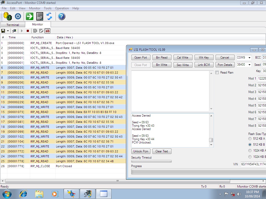

When you first turn an ls1 pcm on there is a 10 sec security lockout ,after that you get 2 attempts in quick succession then your locked out for another 10 sec .
I couldnt get my seed key finder working any faster than planethax's

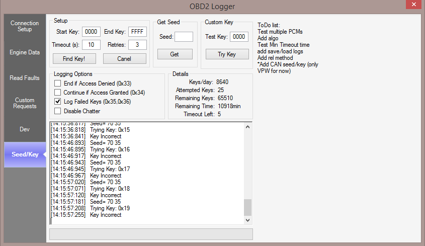

vn5000 wrote:When you first turn an ls1 pcm on there is a 10 sec security lockout ,after that you get 2 attempts in quick succession then your locked out for another 10 sec .
10 Second security lockout... guessing it must throw a 0x33 for security denied. Will still try it out anyways...who knows, could be an exploit right at the beginning if requested fast enough? (yeah I know, hopeful thinking).
Id be interested to see what the tech2 does for writing when the pcm is just turned on before writing.
So at 10sec a key, would be a max of 8640 per day. Could take longer than 6days in total then.
I guess manually extracting is an option as well.

After the first ign on 10 sec timeout you get 2 attempts every 10 seconds until correct key is rxd by pcm , and from memory the 2 x 2701 commands need to be within 1 - 2 sec of each other
0x37 security timeout
0x35 wrong key
0x34 correct key

vn5000 wrote:After the first ign on 10 sec timeout you get 2 attempts every 10 seconds until correct key is rxd by pcm , and from memory the 2 x 2701 commands need to be within 1 - 2 sec of each other
0x35 wrong key
0x34 correct key
Will implement and test that out today. :thumbup:

Post by Tazzi »
From PlanetHax:
67 02 34 = correct key
67 02 35 = incorrect key
67 02 36 = incorrect key, second try, wait 10 seconds
67 02 37 = incorrect key format - out of bounds (00-FF)
