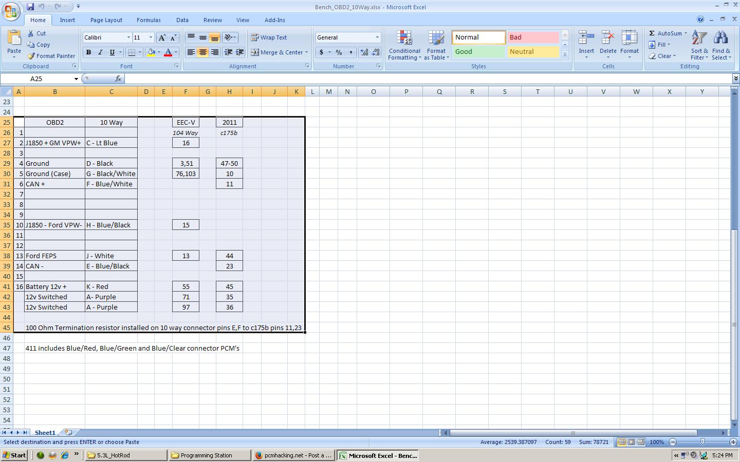

In-Tech
- Posts: 785
- Location: California
Is this any different? When I was doing testing, it took all of this for me to make it work everytime. FEPS was 18v. Pay no attention to the wire colors, that is what I used on my universal 10 way at the time.
- Posts: 3626
- cars: VE SS Ute
- Location: WA
In-Tech, yep, thats another confirmation of pinout. The only thing that varies between diagrams is how many ground points are being used.
But we made progress!
After a bit of guidance with sending correct diagnostic commands and protocol headers ect.. we finally have communication!
Something that is important though, is I needed to power the ECU Battery power first, and then attach the ignition wires otherwise the ECU did not seem to recognize it was actually on. After doing that, and correct diagnostic requests... we finally got a response
