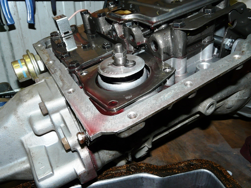

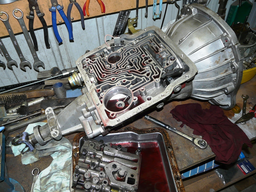

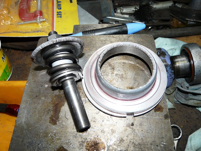

on that note, i pulled the trimatic out today and got her apart partially and found some stuff that was not how it should be hahahaha....
so the servo piston (bottom left of pic) has split in half
thats all i've found so far, hopefully thats all it is, will be giving everything a full clean out though as theres grey gunge all through it.
have found from a quick search on the net that you can get steel billet ones of these so that might be the go!

Ouch. The std servo was only meant to be in a grocery getter.
Re: My Delcoed Rides
yes true
i have ordered an ebay steel billet one !! hopefully last a bit longer!

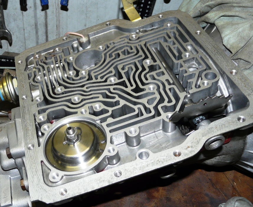

thanks to a super fast ebay store i have already recieved the servo piston i ordered on friday
so i thought i should try and get the tranny back together seeing how my brother said he would be able to help me put it in tomorrow night!!!!
old cast alloy v's new billet steel
fits just like a bought one, albiet a tad harder to get in with two sealing rings now instead of the one ring on the alloy unit.
while it was apart i added some size to the 2nd and 3rd clutch oil feeds to get it shifting a bit harder - the holes were only one size larger than stock which i believe is about a stage 1 type of shift firmness, and while 1-2 shift was pretty good the 2-3 has always been a bit slow so hopefully it will be a much improved beast
got her all back together and its sitting on the bench ready to install!!

That is fast service.
Did you open the 2-3 feed port to 5/32", which is the same size as the gasket, or did you go bigger?
