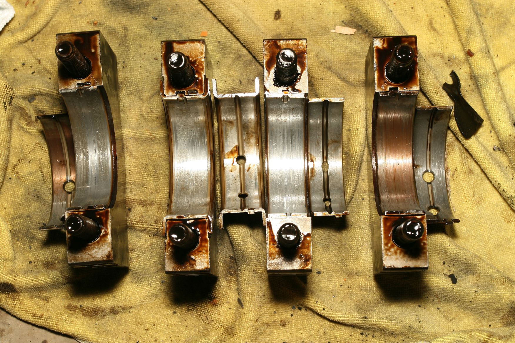

Re: The1's Daily
i wouldn't stop you from buying them for me vlad i always like free stuff
here's a pic of the mains wearing the inner front and cap on the rear
