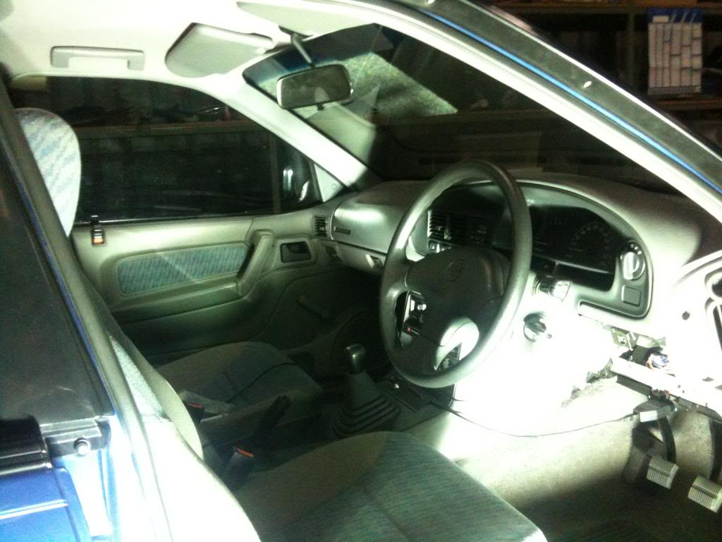

have been experimenting with different glues on an old steering wheel, concluding none work very well for the application.

got the glue, worked really well !
so looks pretty much done with steering wheel fixed.

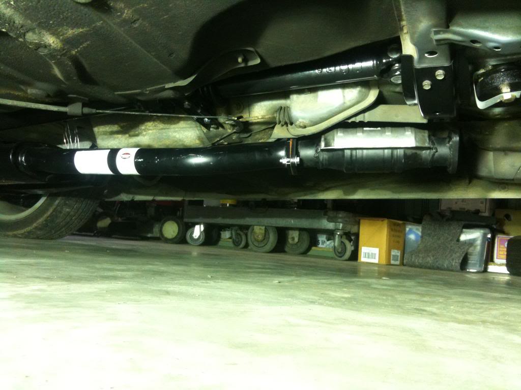

fitted most of the exhaust, Y pipe will go in latter once its gets the outlet up sized.

Got the y pipe enlarged on the exit. Thanks HQ355 for the help
still have the cat to mod as the catback needs rotating , so the flange will be ground off the cat and new one welded in place but 20º or so rotated.
