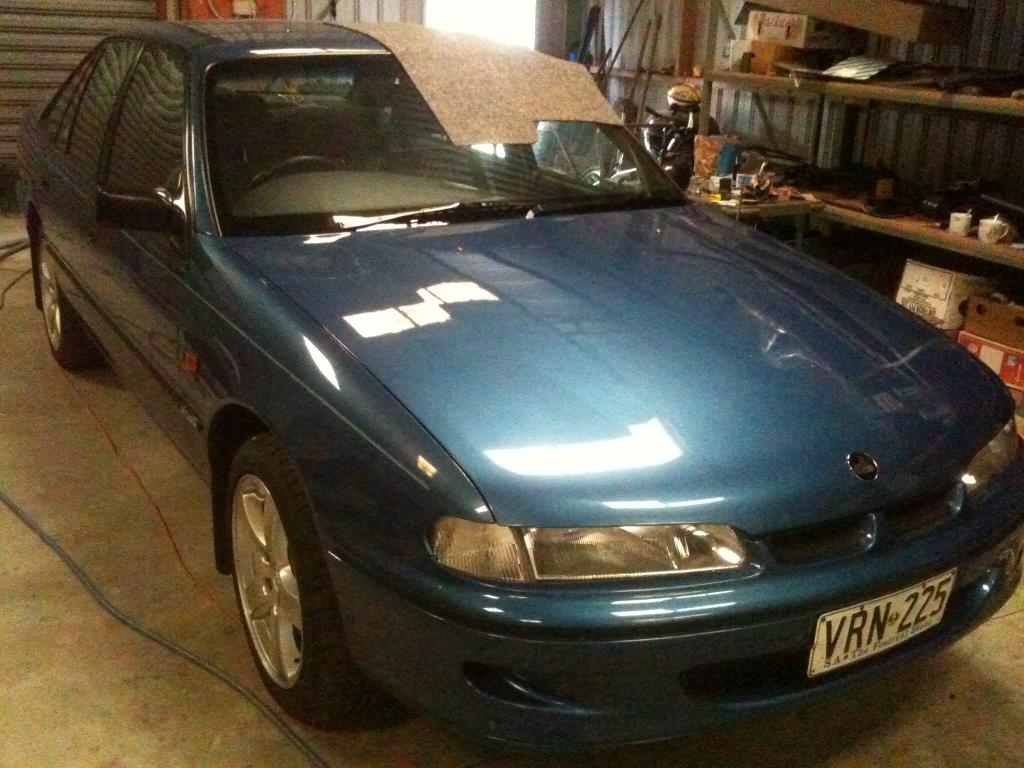

on the home stretch now.

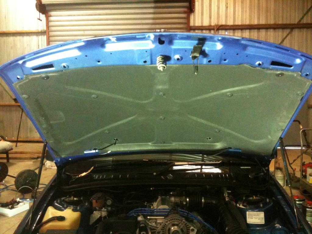

Just radiator, tyres and wheel alignment to sort, and then just a hand from someone to drop the bonnet back on and I can do the final touch with a new bonnet insulation mat.
RWC, rego and then fun times :thumbup:

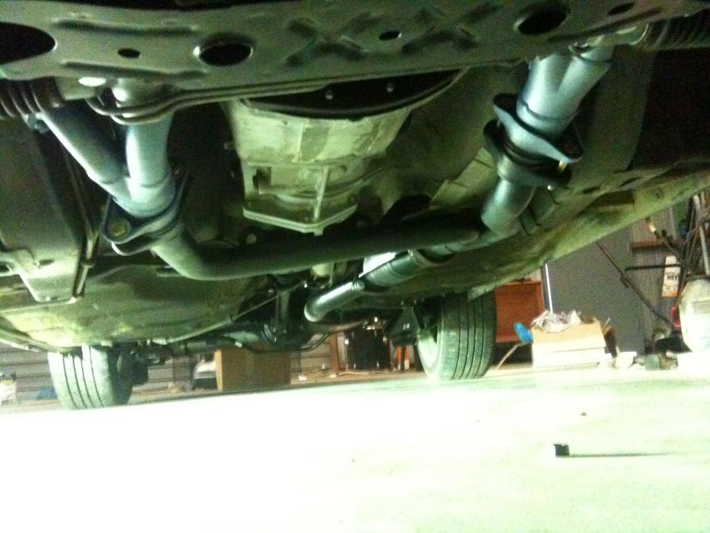

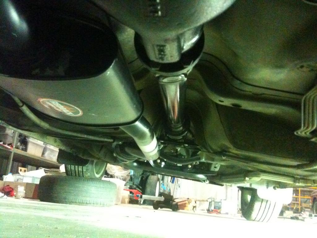

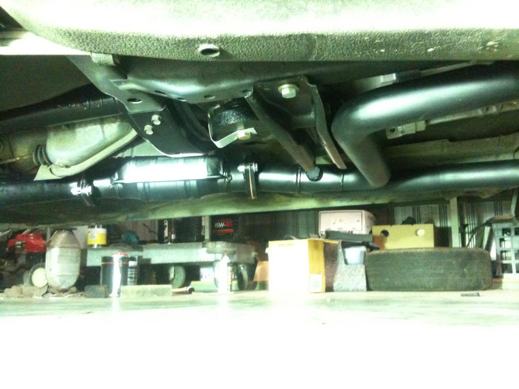

Once again big thanks to HQ355 for helping me mod the exhaust. :punk:
very quite for a sports system! I like it. I took it a bit over 4k in the video but so quiet, the VP at 4k is about to explode with the racket it makes with same extractors and stock exhaust.

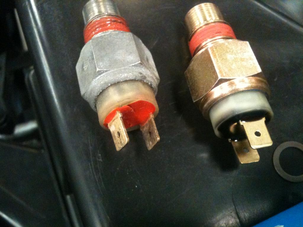

So I replaced the reverse switch as you can see the old one's terminals were hanging by a thread.
Out with the old, bit of a clean to get all the yucky tyre shine stuff off.
Not too shabby 8-)
Yep, china crap :lol:
