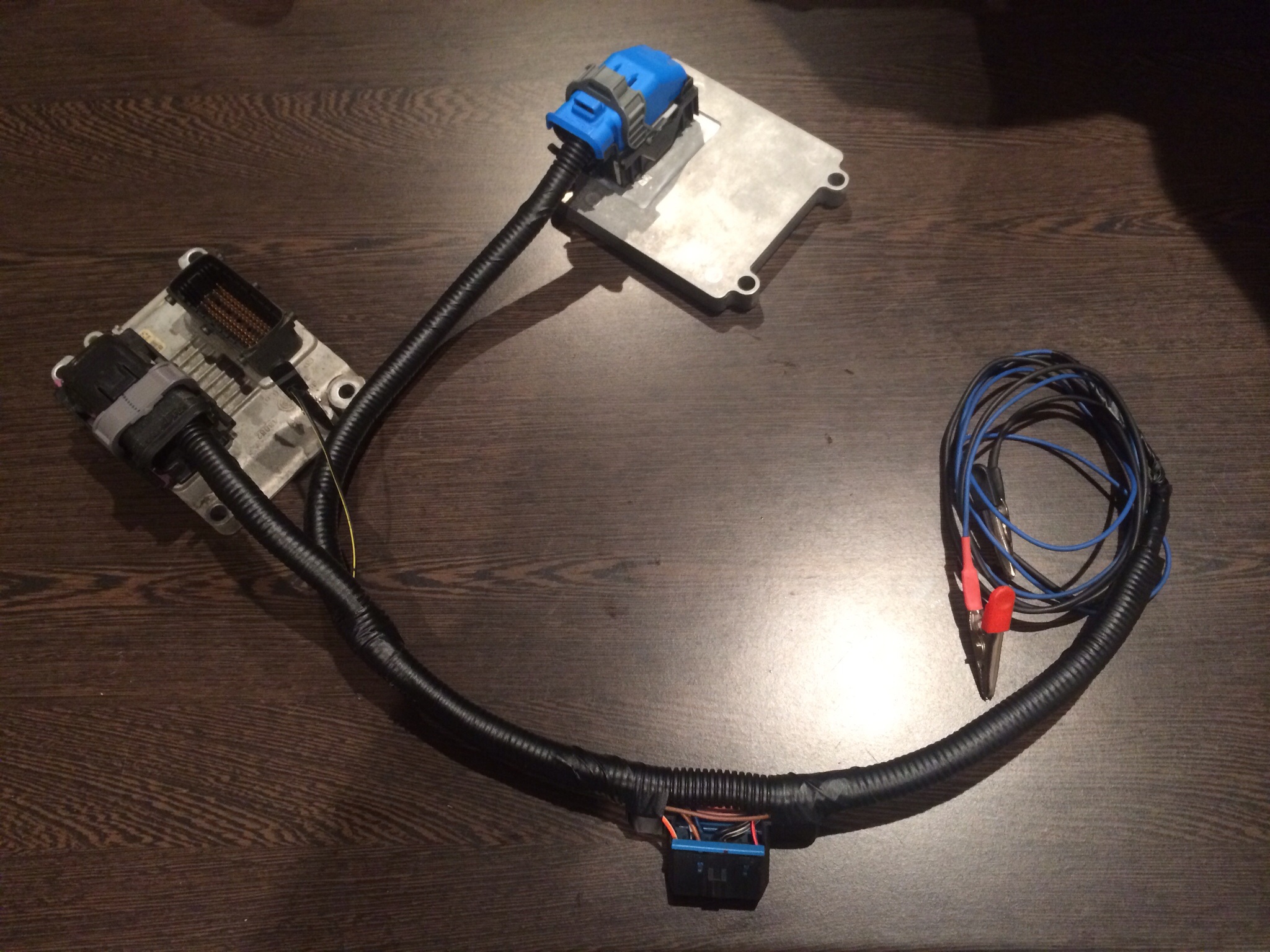

VX L67 Getrag wrote:sorry been busy these are the exact wires the E55 VZ ecm needs;
Pin B3 - Pink - Ignition
Pin B23 - Brown/Black - Can Hi
Pin B25 - Black/Yellow - Fuel Level Sensor for Ground
Pin B36 - Orange/Black - Batt Supply Voltage
Pin B55 - Brown - Can Lo
Allways wondered about the ground wire, I have a clip onto the body of the ecu for mine, works perfect
Bench harness
Bench harness
Posts: 3552
cars: VE SS Ute
Location: WA
Post by Tazzi »
Looks good Matty! Will have to look into making something similar!

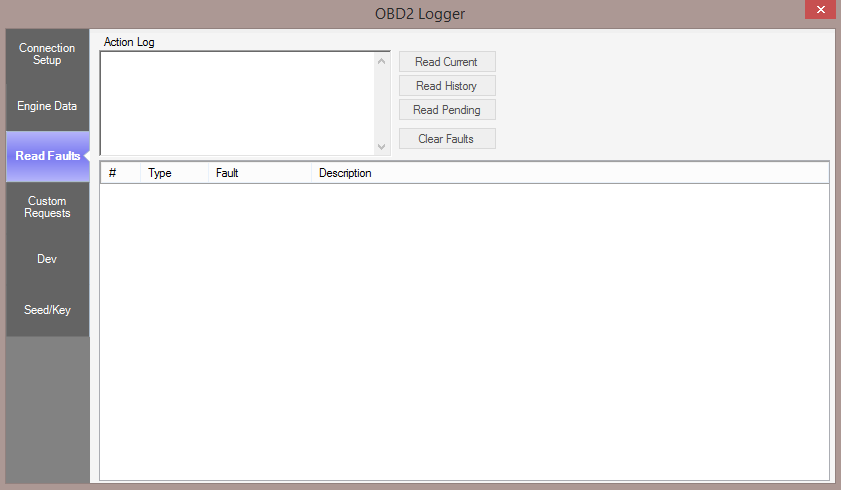

Fault section is now re-modeled. No internet connection required or pop ups for view fault codes. All (Most) fault codes should be defined now!

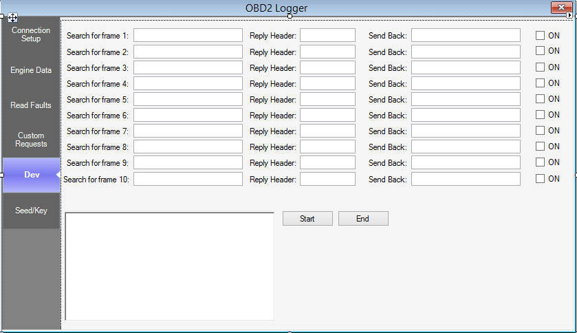

And also a little bit of custom reverse engineering abilities.. for those who are daring.. (Still finishing off)
Can be used to mimic a pcm, send custom data depending on a specific frame ect, the applications are endless.
