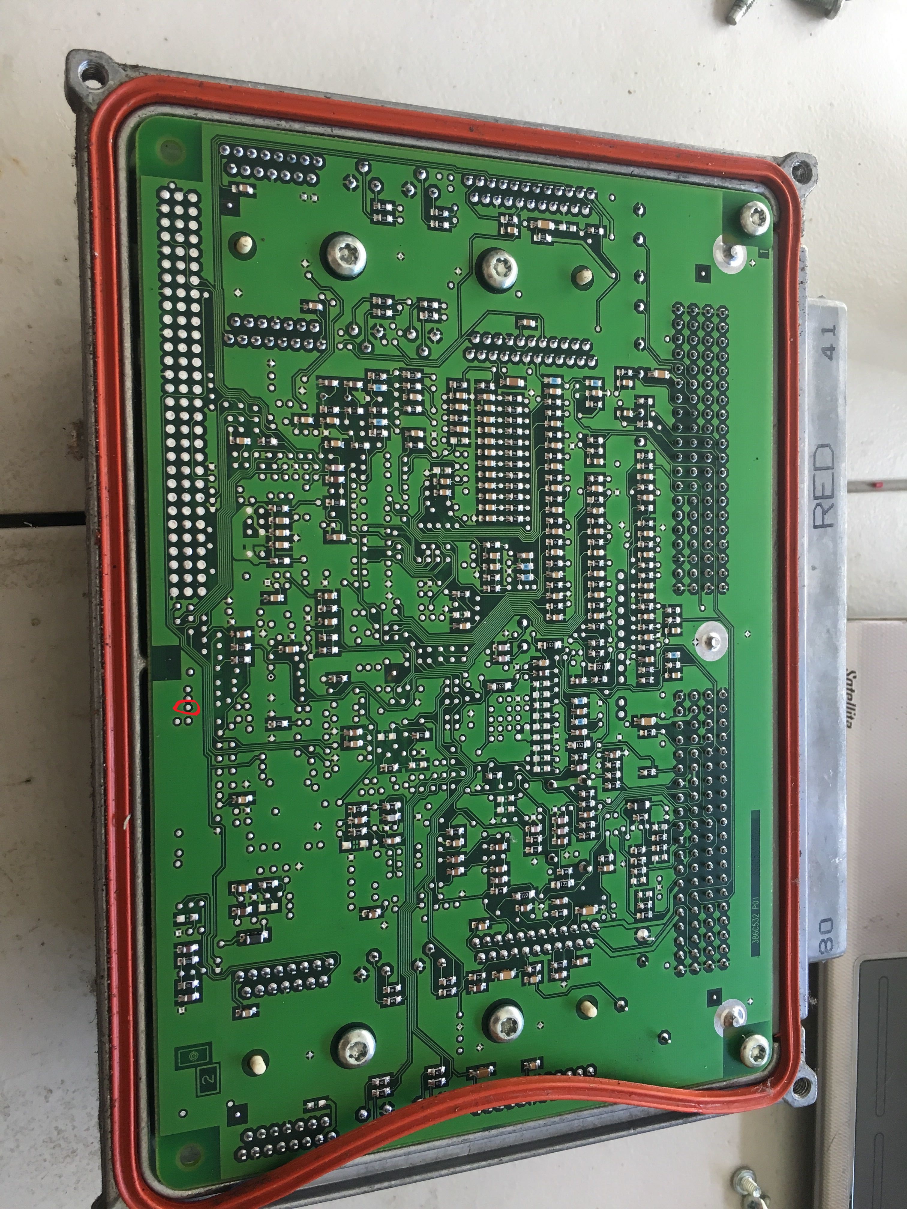

What is the PCM service number and what OS did you flash on it with EFI Live? When the seed shows up as FFFF on a 512K most of the time its due to flashing a 99/00 OS onto a 01/02 pcm or vise versa. The offset changes where data is written and a lot of times a check byte will not line back up correctly and will cause this issue.THEFERMANATOR wrote:Don't think so. I just went back in and read it out using the stock key with no problem. I even went and flashed a different cal file in it making sure there was no locking protection enabled, and it went through without a problem. I have 2 identical PCM's setting on my kitchen table, a 35 amp power supply, bench harness, and tuning equipment. My V2 will read either PCM without problem(only 1 is licensed to my cable), I can connect my TECH 2 to either without issue, and I can even read the properties out of either PCM without issue, but I cannot read the file out of the PCM that is licensed to my V2. When I last flashed it, the seed key showed up as $FFFF if that helps. $2B76 is the seed key showing up for the PCM with a fresh TECH 2 flash in it.DavidBraley wrote:Is it possible EFI Live somehow locked the bin file the last time it was used to make changes to the PCM?
You can also go into EFI Live in the FLASH tab and under Pcm Security check to see if there is a "Tuner Lock" in place on the PCM that was done by EFI Live. If it reports an unlocked status that means the seed/key is stock or the PCM is already unlocked(meaning the key is 0000). If it shows there is a tuner lock then just remove it.
You can always ground the pin in this picture and then read the pcm with another tool or do a complete flash if you'd rather just over write whats on it. With the pcm turned on ground the pin for 1/2-1 second and then read or write the pcm. It will allow you to temporally bypass the Seed/Key unlock.
