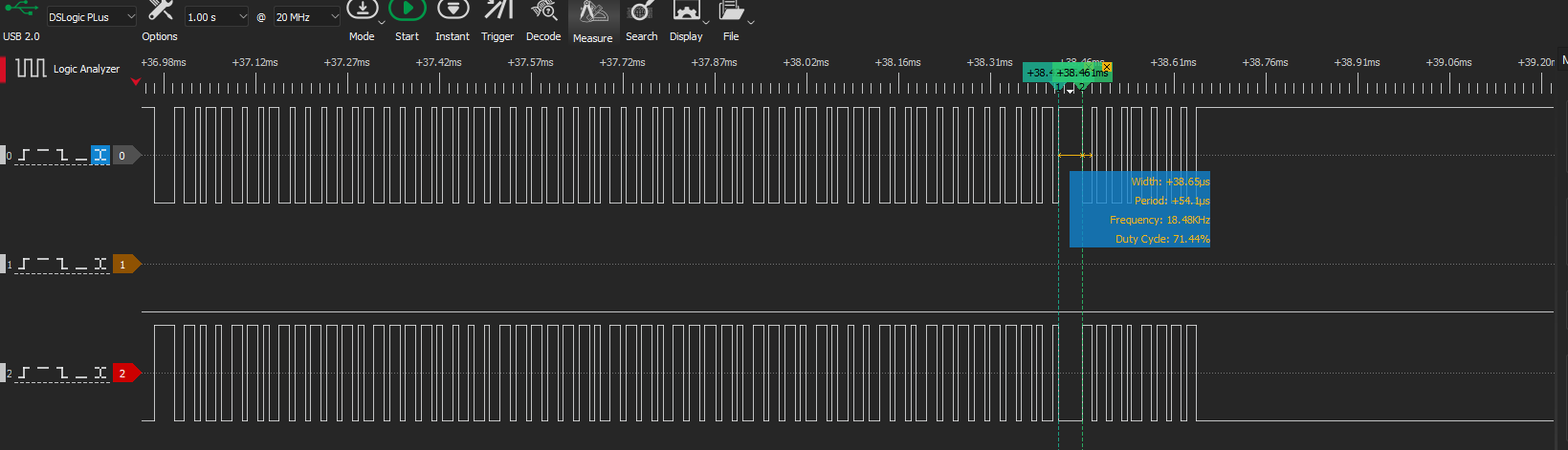

As I was not expecting any of this, I had to whip out the scope to spot what was going on. Below is a picture of both PWM negative and positive wires, I have highlighted the end of the last bit of a message sent to the ecu, and then the start of the IFR response. You can visually count 8 bits that occur (00010000= 0x10). Everything before that is the actual frame sent to the ECU.
I was surprised to not find a single person talk about this online, I realise its explained in the J1850 documents, but its not exactly well explained plus it doesnt stick to the standard very well. Ontop of that, the IFR appears to be completely pointless, I can send any single byte to the ECU after its sent its message back and it accepts it. Most J2534 tools and also ELM cables send 0xF1, but I sent every value from 00 to FF and every single one was accepted.
The IFR is controlled by a single BIT in the first byte of the header frame, bit 3, if this is 0 then an IFR is required, hence a byte of 0x64 (0110 0100) and 0xC4 (1100 0100) both required the IFR. Supposedly multiple bytes can be sent as an IFR, but these bytes are never passed back to the scantool, so its absolutely pointless.

I find your research fascinating. Curious though, red highlighted bit isn't bit 5?
Posts: 3626
cars: VE SS Ute
Location: WA
Post by Tazzi »
Cincinnatus wrote:I find your research fascinating. Curious though, red highlighted bit isn't bit 5?
Bits are one of these weird things that has some rules to follow.
When dealing with bits where the Most Significant Bit (MSB) is first, you always count from right to left.
So there are 8bits, but common programming terminology counts them as 0,1,2,3,4,5,6 and 7th bit which is a total of 8.
Hence my highlighted red bit is bit 3 :D
