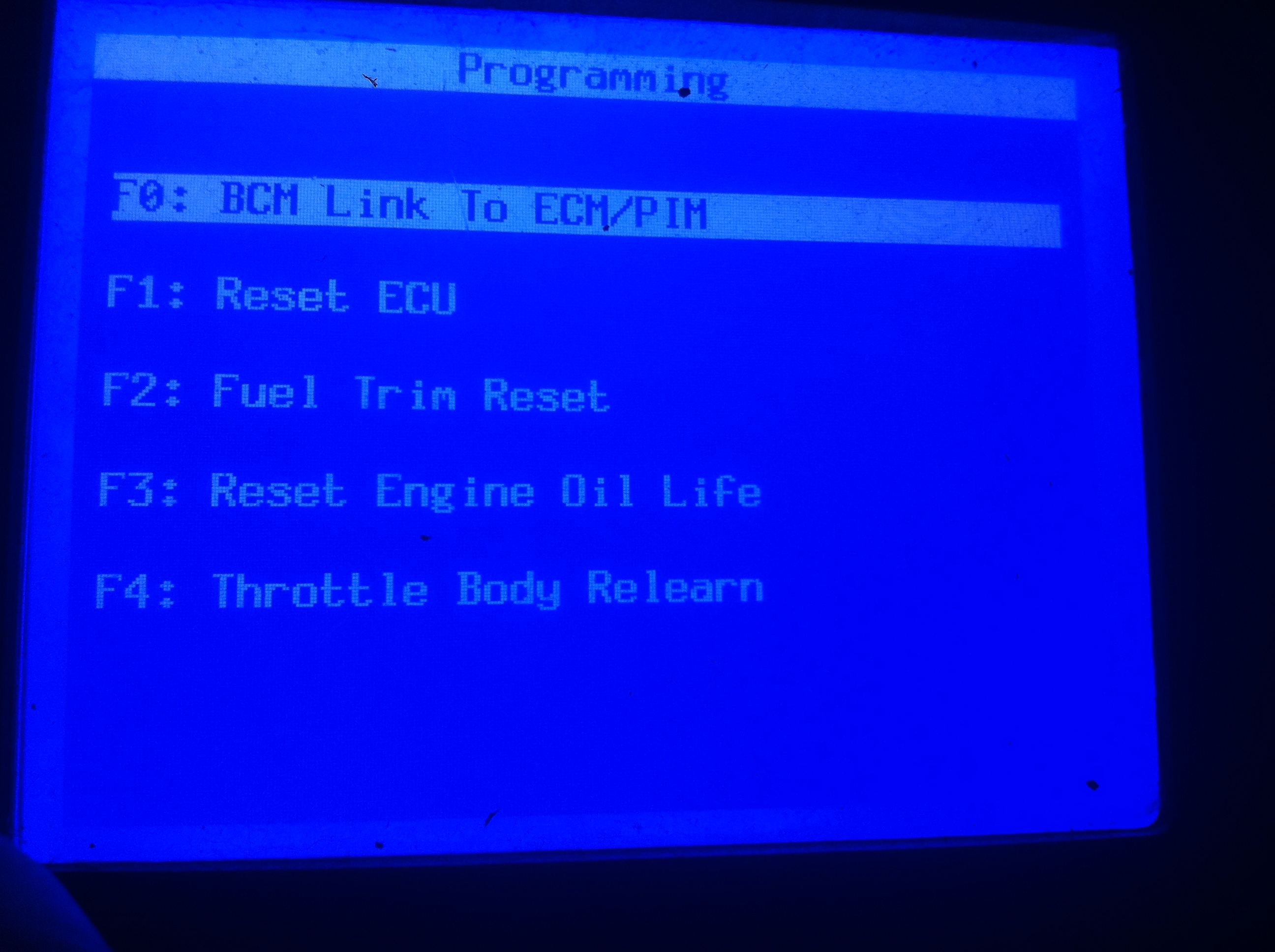

Iv got some interest in this BCM relink with PIM/ecm. But since the BCM is on ALDL.. I figure both ALDL and CAN are required at the same time here to capture whats going on? But.. the CANDI module is connected so it cant do anything over ALDL??.. eh duunnnooo. Might try capture something with the ecu unplugged first so I dont go killing it quicker. Unless some special communication directly between the PIM and ecu occur.. and only special commands to the ecu/pim are required?

I was under the impression that the PCM links to the PIM... I know if you swap PIM to another car... engine wont start.
maybe the pim and ecm connect via the bcm ?!?!

Post by Tazzi »
Holden202T wrote:maybe the pim and ecm connect via the bcm ?!?!
Jayme wrote:I was under the impression that the PCM links to the PIM... I know if you swap PIM to another car... engine wont start.
In the holden documentation.. it goes ECU to PIM to everything else including BCM. From what it shows, the ECU has no direct connect with anything else.
So.. Id assume the ECU and PIM configure them selves first.. then the PIM would then communicate with the BCM and match up there... using the vin or security code or something.
Hence the when clicking the "unlock" on the key or trying to start the car.. the key sends the encoded security.. the bcm picks it up.. sends it to the PIM, and the PIM then sends it to the ecu. If the ecu doesnt respond with 4seconds of the code, then pim shuts off injectors (thats all from memory btw.. It might be slightly different but I read that a couple days ago in the docos.)

Post by Jayme »
