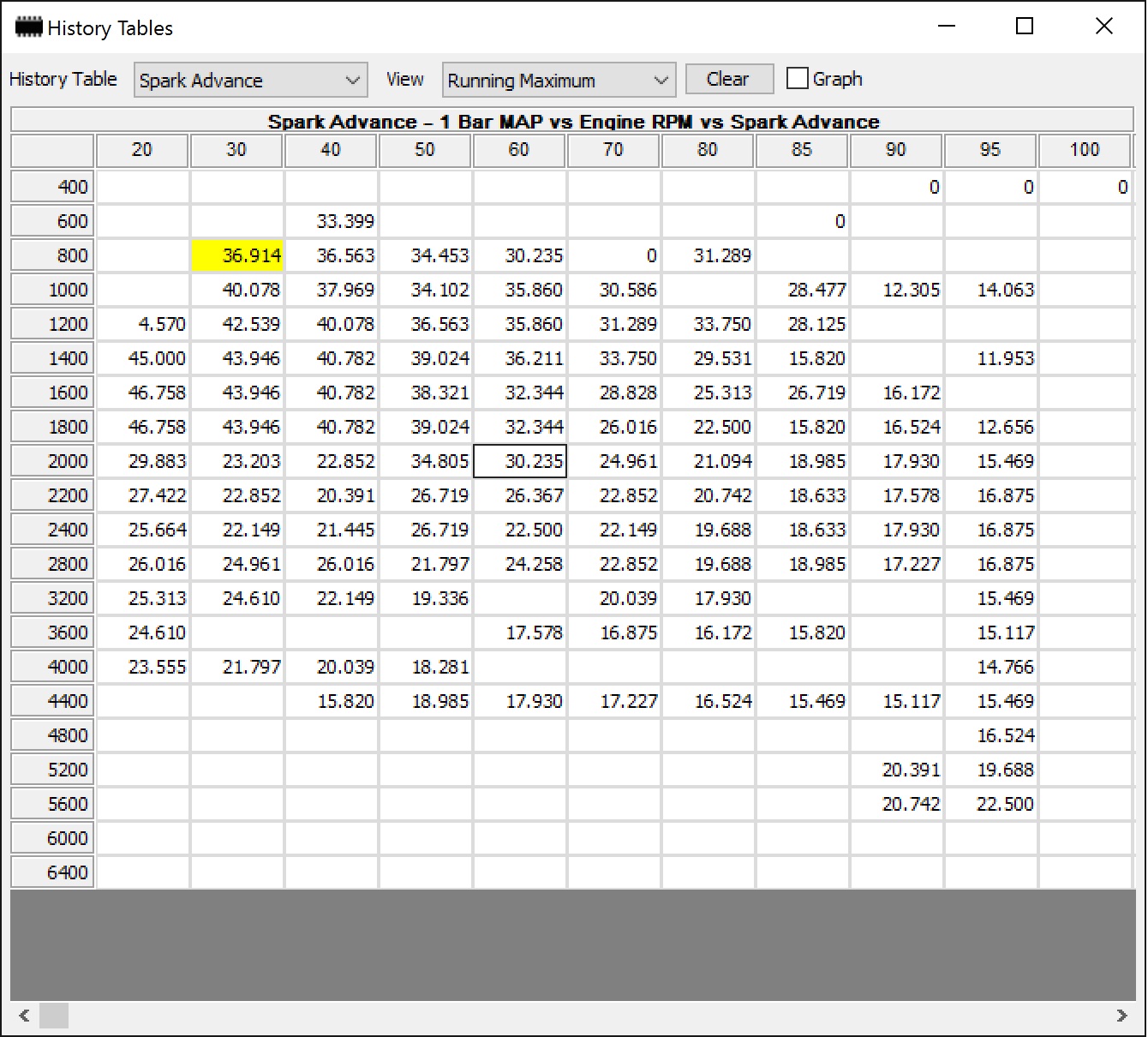

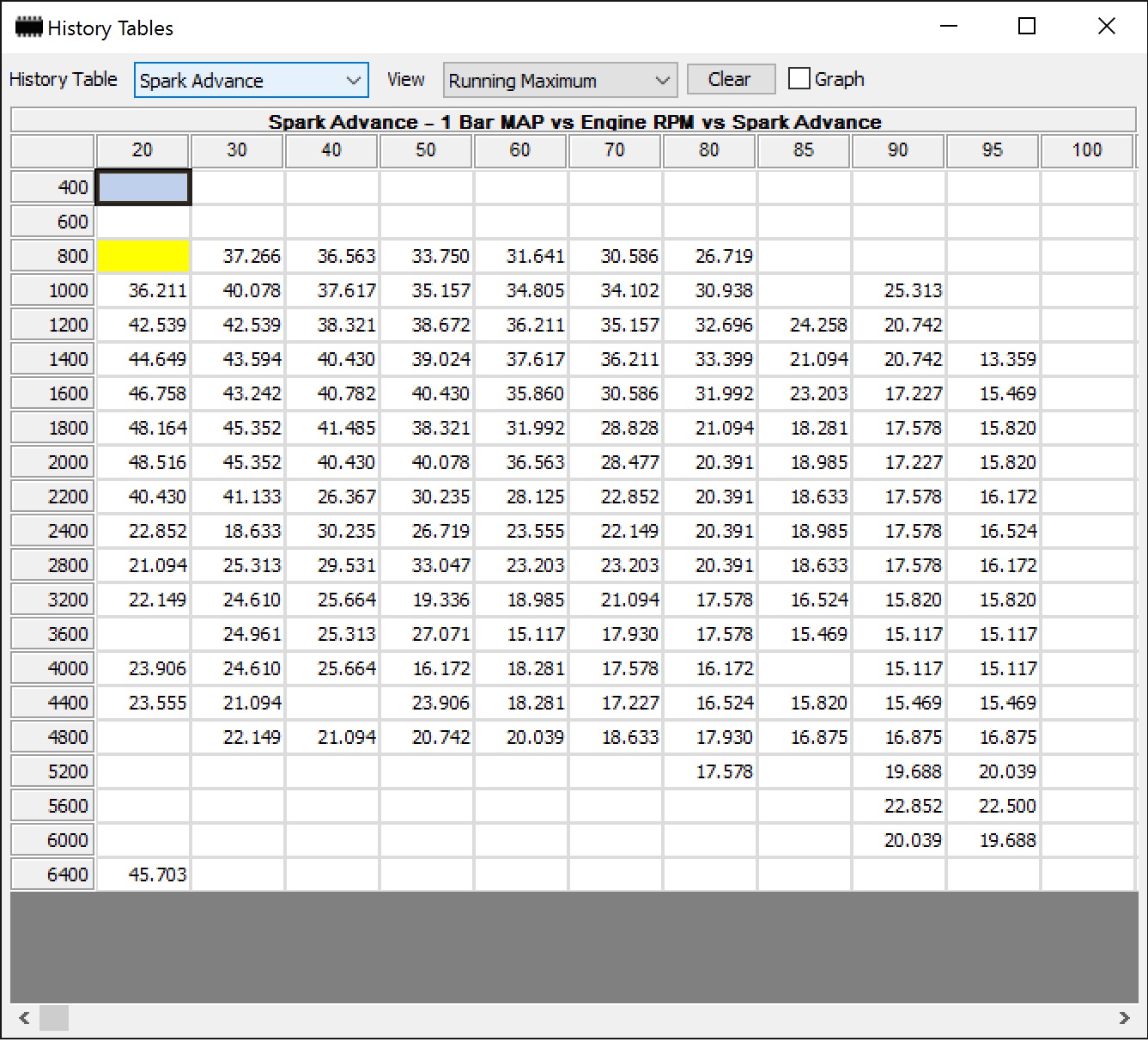

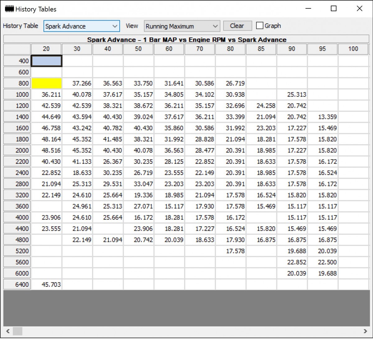

- Posts: 4853
Re: The1's Daily
it wont be pure, prob 10L of 98ron left in the tank, down to empty and 50km left on trip computer, i put 35L in and ill run that down then give it a full tank.
I had the tune perfect on 98ron, ive found after 2 days to work and back overall fuel adjustment of 27% more and 2-3% in WOT areas reduction, so 27% more fuel in general areas and 25% at WOT.
Ive run it straight up with the same spark and found a loss at WOT and no change in general areas. I tried increasing the WOT areas by 2-3 degrees past normal 98ron limits but no gains either and a few spots it set off knock, set for next week drop the spark and see if that changes anything, currently im running stock spark gap. Both tests are run in the morning on the same road with ruffly the same intake temps 15c
Perhaps when i get a fresh full tank in it'l change a bit? Perhaps dropping the spark will improve it? Or perhaps it's just a fuel that loves compression, either high compression N/A or Forced Induction.
- Posts: 8600
Re: The1's Daily
yeah I found the same, more timing up top killed off power. The timing need to reduce.
I think you would of picked up on false knock probably from the excessive piston side load of already being past MBT with stock spark and even more so by you increasing it. I tried 40o at WOT on my VP with no knock at all just to test its resistance. I know I hear audible knock from 98 around 26o with hot intake so this proves its virtually can't be set off.
You yield best performance from e85 with 13:1 CR and upward. Still there is gains at low end regardless.
- Posts: 8600
Re: The1's Daily
Try reducing the timing down overall by 4-5o which is what dynosim is suggesting.
