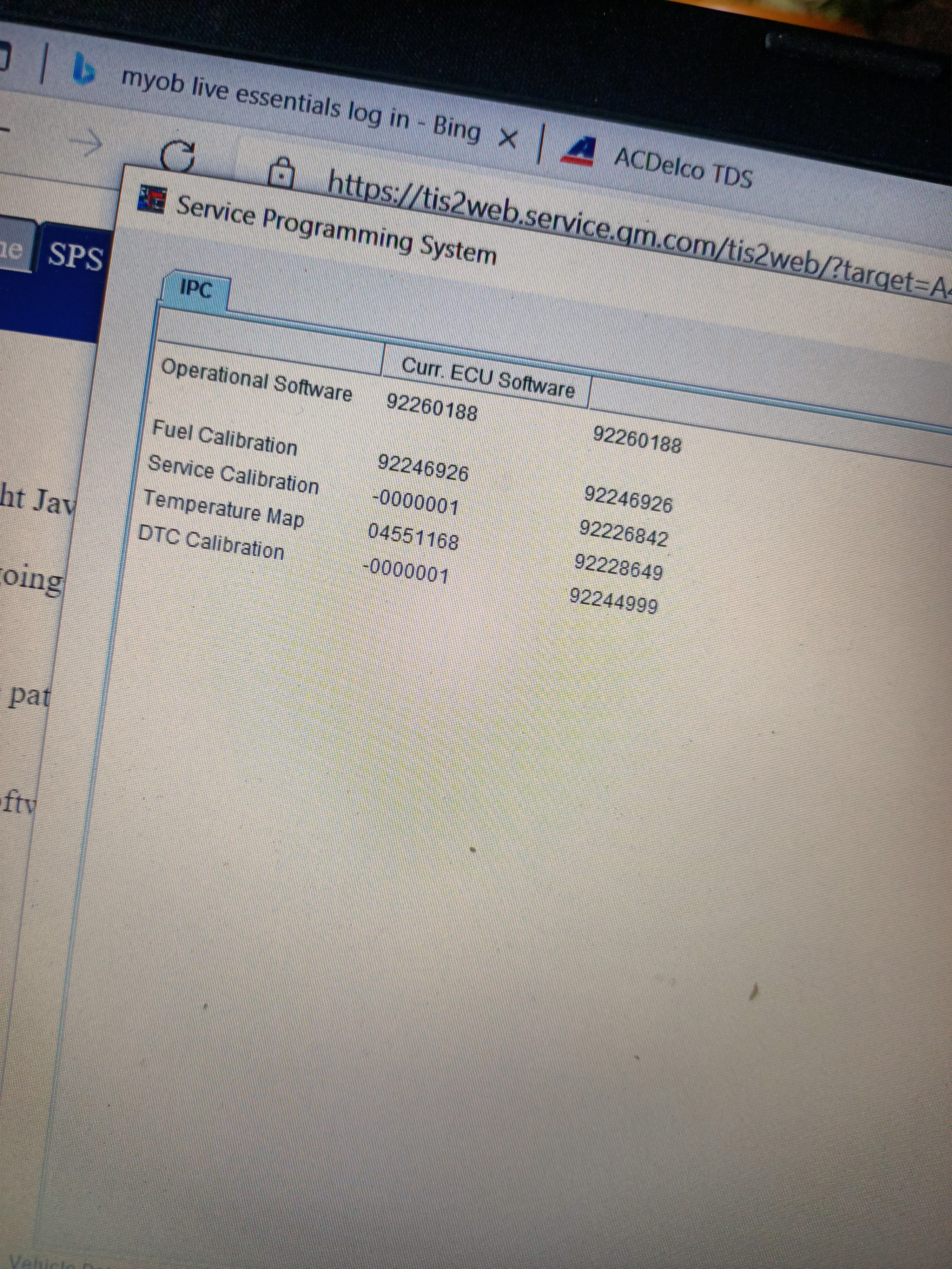

Hi , would anybody have a bin file with these software numbers?
