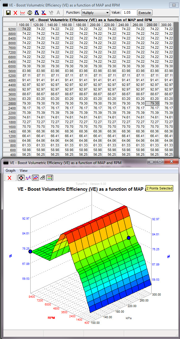

ok Six Shooter, i understand your pain with the injector displacement calc, and everyone has their opinions, i honestly feel the best way is to go for a 100kpa peak of 85-90-100 or whatever number you prefer and tune injector rate to get that, then once you are happy with that side of it get your 100kpa (20-100kpa ve table) column and copy it across into the boost ve table, as per the tuning guide, and you should find it will be pretty close right from the beginning.
also just to show whats happening with the boost multiplier ... as VL400 said it uses this as part of the internal calc and if you really must you can change it to get more or less of a percentage change at certain boost levels. so with the standard numbers in it, i have used the values to multiply the boost VE table just so you can get a visual idea of how it is being offset (note this might not give exact results of what the ecm actually does internally)
so the below is from the tune i run on my 18psi turbo Gemini.
20-100kpa ve table
20-100kpa ve.jpg (489.68 KiB) Viewed 5680 times
then the 100kpa column from above is copied into all the columns of this table as outlined in the tuning guide.
normal boost ve.jpg (424.64 KiB) Viewed 5680 times
i have then applied the boost multipler percentages to the respective columns in red to show you what sort of results your actually getting in the delivered pulse width at the injectors.
boost ve multiplied.jpg (483.06 KiB) Viewed 5680 times
also keep in mind this table is normally flat across the kpa range, you might find like in delcowizzids case you have a increase in them, this is probably due to not having rising rate regulator, and with a rising rate regulator it might go too rich as boost increases so you might need to drop the values across the kpa range.
at the end of the day theres so many factors, cam/head efficiency, turbo flow pattern, exhaust system restrictions, fuel system capabilities etc etc that every second persons tables look and work totally different.
the end goal is to have the wideband AFR's match the commanded AFR's and everything is happy.

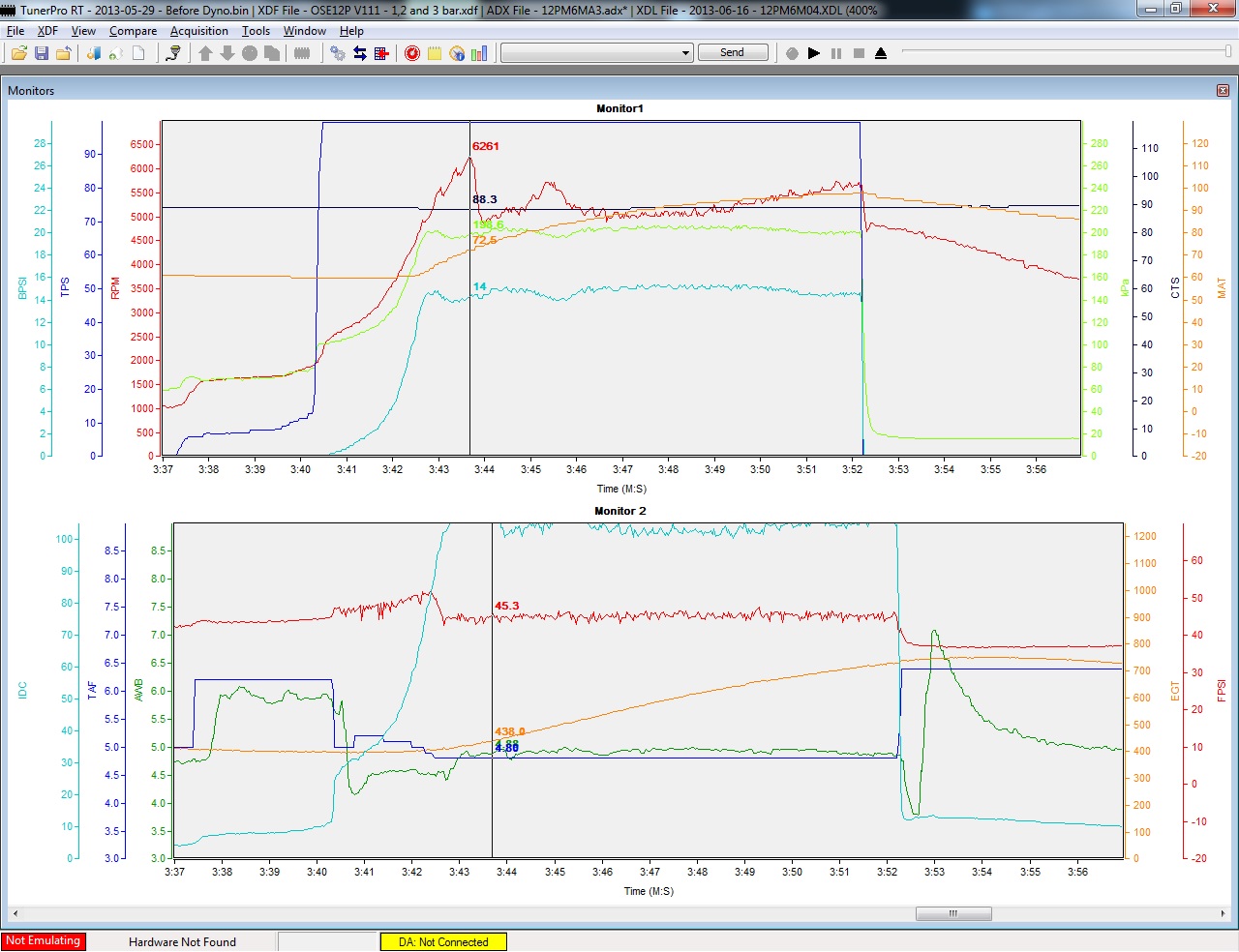

the below datalog is a 1/4 mile pass from the above tune, it shows in the bottom monitor how closely the target and wideband AFR's are with this setup.
the above setup is also actually with a rising rate reg, and you can see from the FPSI trace pressure drops as boost comes on, this was a fuel system on the limit of flow for methanol (need 2.3 times more of it than petrol) and from changing to E85 i have got my fuel pressure back under boost now!

Holden202T wrote:ok Six Shooter, i understand your pain with the injector displacement calc, and everyone has their opinions, i honestly feel the best way is to go for a 100kpa peak of 85-90-100 or whatever number you prefer and tune injector rate to get that, then once you are happy with that side of it get your 100kpa (20-100kpa ve table) column and copy it across into the boost ve table, as per the tuning guide, and you should find it will be pretty close right from the beginning.

20-100kpa ve table

I've done EXACTLY what you describe, get the 100 KPA numbers that I wanted, in my case I looked for 12 AFR on my WB, and without AE, though I do want to do that set up again once I get back to $12P, and give it a little more effort. I copied over those 100 KPA values to the boost table, and then started increasing the columns a little at a time to get the in boost AFR to where I wanted, once I hit 102 VE, I stopped, because I know the North American ECMs just truncate that to 100% VE, and I still wasn't getting anywhere near enough fuel. I actually didn't know about the boost AFR table until afterwards, but it was set in the 12s, and I was lucky to get near mid 13s at just 5 to 7 PSI (140 to 150 KPA) boost pressure. A few times I actually hit higher boost pressure and leaned out into the 15s. :shock: I have to control boost pressure with my throttle angle, since my base wastegate pressure is about 9 PSIG.
I understand the function of the multiplier, it's just like any other GM code, it multiplies the current VE value by the multiplier value, pretty self explanatory.
So from what you show, the boost VE table is rather useless, and could be completely eliminated, then point the multiplier at the 100 KPA value being used at that RPM, just like stock boosted code does, at least in the North American ECMs anyway, they work that way. I mean really what's the point in having a full 3D table that is the same as a 2D table, or a column of an existing table, that uses those exact same values?
