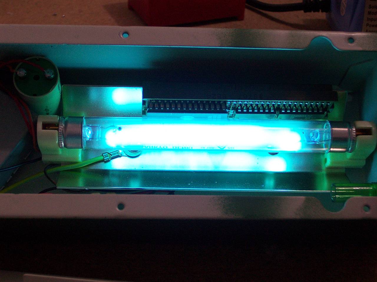

Righteo then. Time to take the plunge. Got the memcal with the lid pulled off and sitting in side the UV eraser as we speak. Too big to go in the draw so I took the top off the eraser and put it right against the tube. Gunna set location $09 bit 7 so when throttle is closed the spark occurs at the distributor reference point. Put it back in the car later this afternoon and see what happens. See if it idles nicer with my add-on ignition box. No turning back now. I feel sick.
memcal 001.jpg (112.98 KiB) Viewed 7758 times
