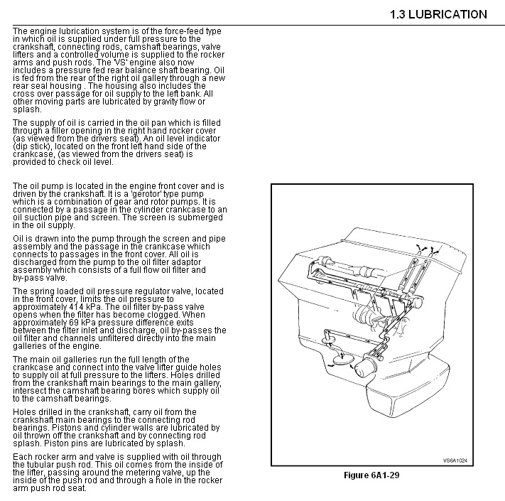

Only looked at this diagram. Looks like it would regulate pressure through centre of the filter?

he's some more info for interest sake.
So between 60-70psi would be normal operating pressure above 1850rpm, above 70psi excess oil is bled off unfiltered, so obviously undesirable. Interested to see thoughts on this. Your oil pressure 60-70 with 10w-40 is normal then.
Re: The1's Daily
well as i read that, the pressure valve should maintain the 414kpa, weather it goes around the filter or not is irrelevant other than not being desirable, but its better than no oil to the bearings
but if yours is higher then makes me wonder if its sticking maybe or gauge is out a bit or something like that ... other than that the only way to increase bleed pressure would be to shim the spring so theres more pressure on the piston.

On a side note, for those who've never cut open a filter, the article is a bit ambiguous about the oil filter bypass valve, this is actually inside the oil filter, there is a spring and a valve located at the closed end of the canister.

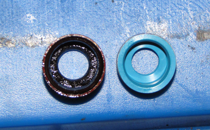

quick extra pic of when i did the valve seals old ones were stuffed and falling apart.

Re: The1's Daily
The1 wrote:he's some more info for interest sake.
excess is bled off into the sump via the relief valve. Nothing undesirable about that as that oil can not reach the bearings instead is picked up by the pickup and pumped again.
The only problem is that if we have a problem with too much pressure or suck open valve the oil recirculates through the oil pump unfiltered and say 300.000km later the oil pump is more worn than everything else due to the recirculating bleed oil.
Now the reason they install the relief valve before the oil filter is that in case the filter is blocked then the oil pressure can't be bled and the pressure will sky rocket and blow something so therefore it must be before the filter.
