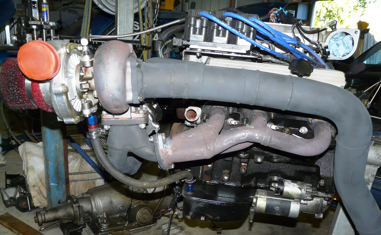

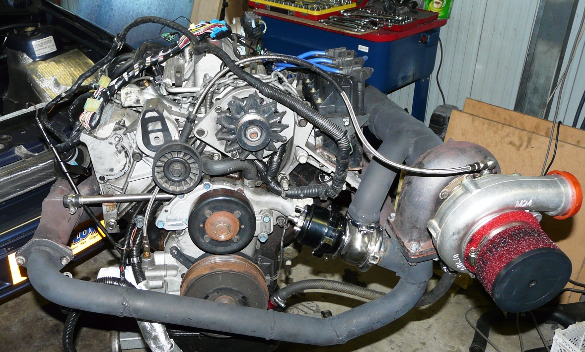

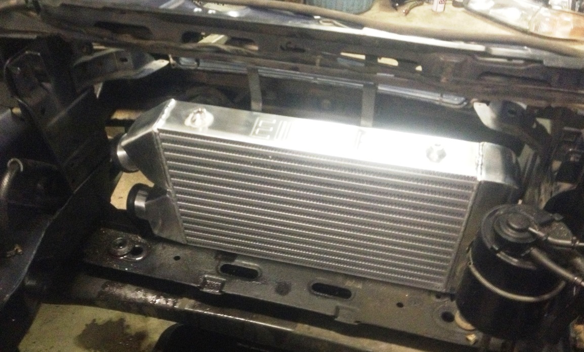

well the motor is back in the VP with the kitted T700 and hi stall converter, really just need to work out how to mount/fit in the intercooler then we're mostly done!!
so fitted the wastegate pipe plumbed back into the dump pipe (to help for legalness)
also fitted a speedflow weld on adaptor to the sump for the oil return
sort this out and then we're good to go!!
mick is keen to get to the dyno at the same time I take the Gemini down so we can get some numbers and also make sure the tune is ok so hopefully that will happen in the next few weeks if I can get the car done!!
Posts: 3676
Re: Mint VP V6 Sedan soon to be boosted!
That oil return line looks very close the the manifold?
Yeah it was in that pic, have since rotated the turbo centre section to fix the issue!
Posts: 5630
cool setup using the headers
