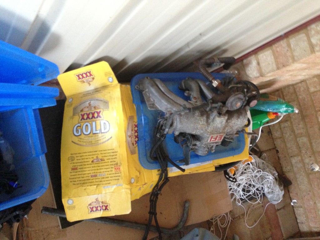

Update.
Parts laying around.
Under the carton is the head off the old 3fe.
Wideband rocked up.
