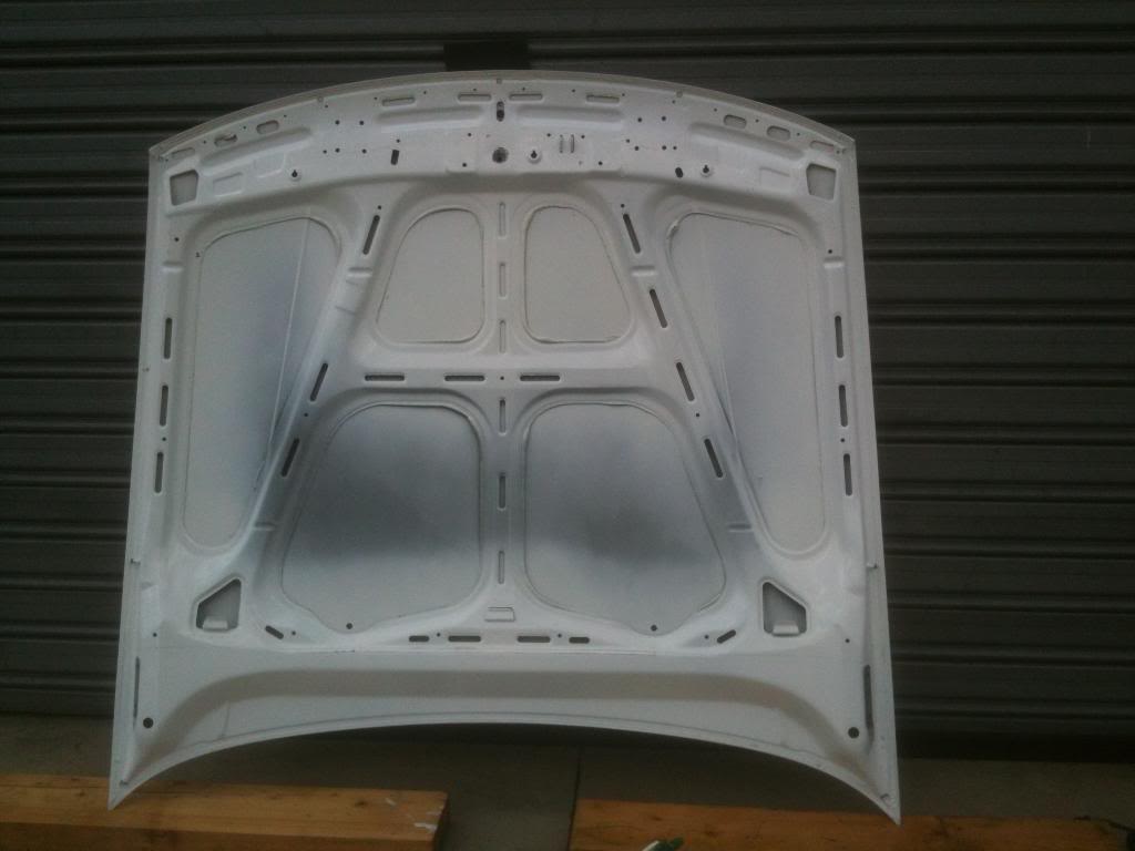

anyways some updates.
got a new bonnet today. put the old one on my vacationer and drove to the wreckers, bought the new one and they help me change it over while I was there and dump the old one.
Drove back wit the new bonnet, then put the vacationer one back on. 3 different colored bonnets in one day
gave it a clean inside and out real good with the degreaser from the car wash again.
This bonnet has one 20c coin sized dent and that is all. All original paint so there is no bog on this one nor excessive layers of paint.

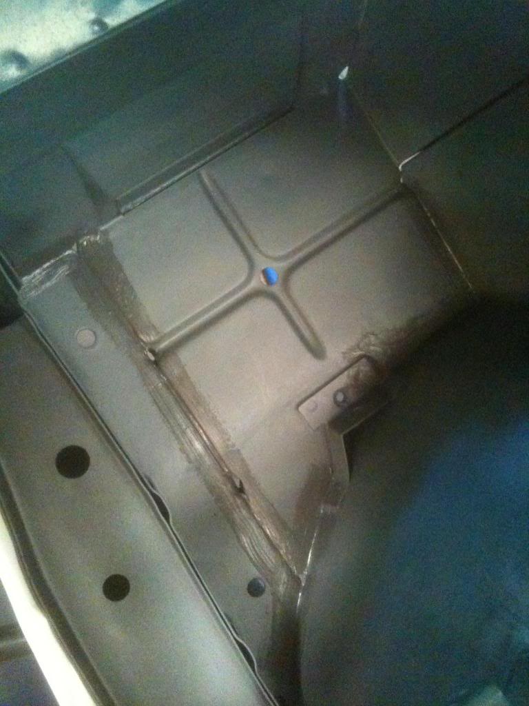

my battery tray has been sand blasted, degreased with water based pre paint degreaser, metal ready (phosphoric acid + zinc phosphate), POR15 rust preventative paint, etch primer and now seam sealer. just need to hit it once more with the seam sealer as it shrinks. then its ready for another coat of primer.

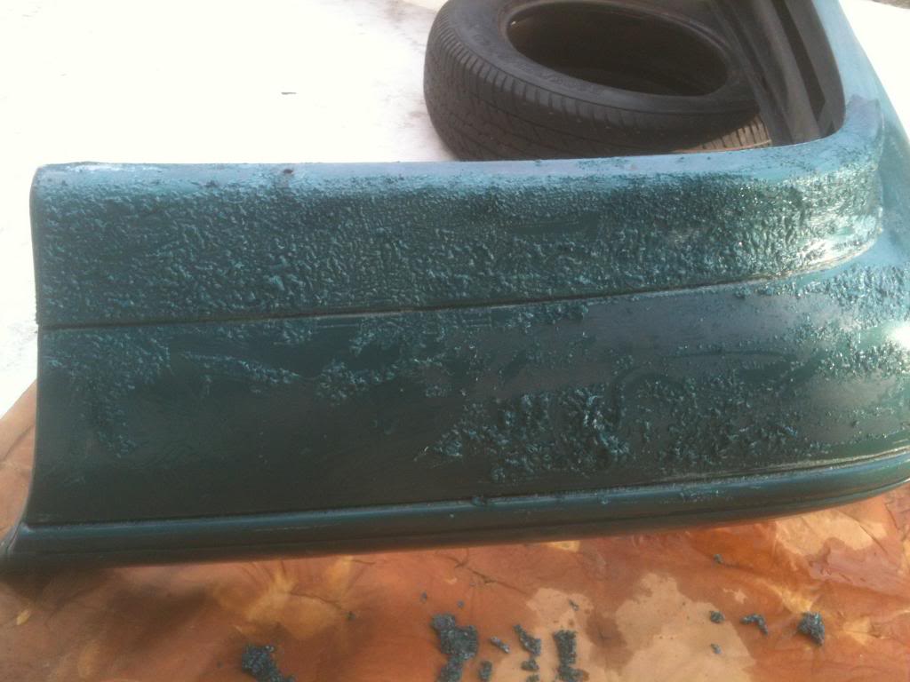

getting close to getting all the paint off the rear bumper.
Surprisingly its just about perfect under the old paint. only marks to worry about where those from me trying to scrap the paint off as its not dissolving easy with any of the paint strippers I have used. the diggers brand is working the best.
- Posts: 5709
Re: Vlad's VP executive
cover it in stripper and wrap it in gladwrap or any other type of plastic you can find will work real good
- Posts: 8548
digger brand stuff is working well enough for me, few minute and 2 to 3 applications gets it all off. As the bumper is plastic I don't want to leave it for long periods as I don't know what effect that will have on it.
last time I used paint stripper on a painted plastic part it melted it straight away

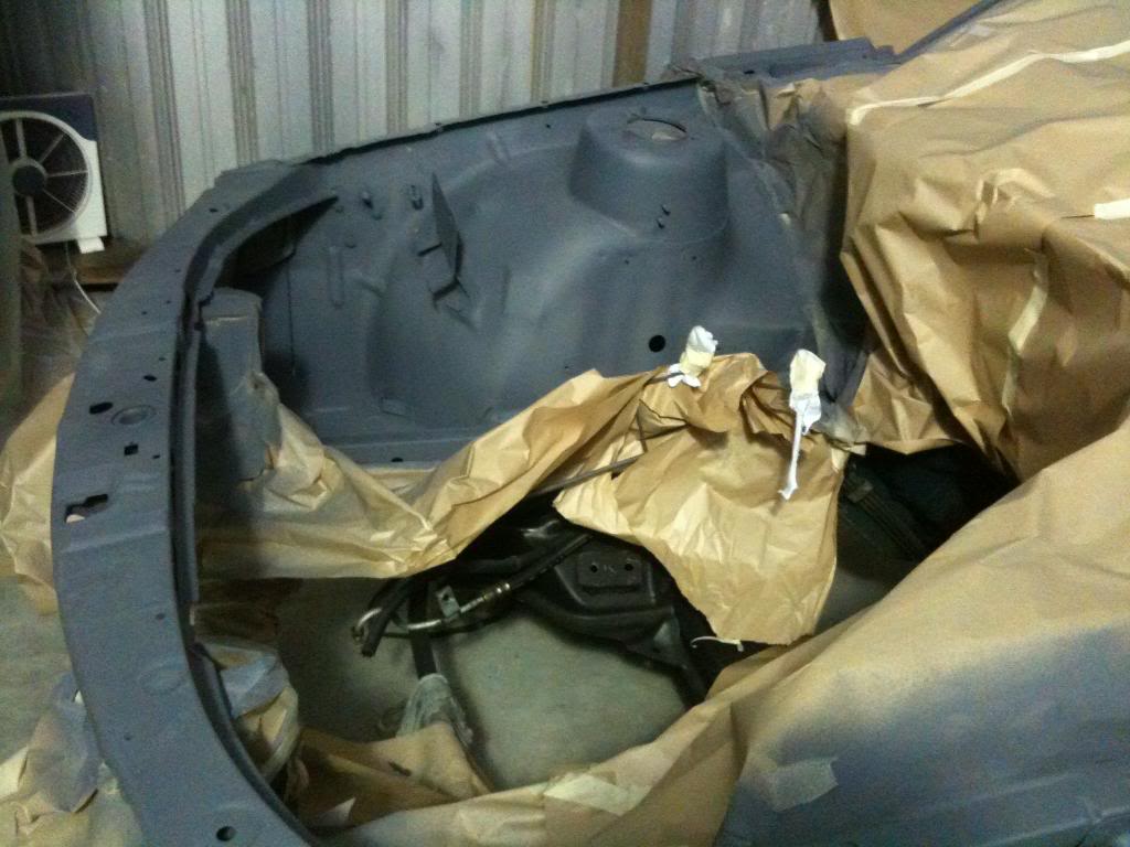

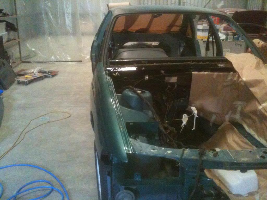

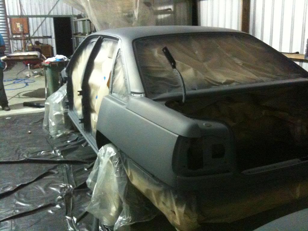

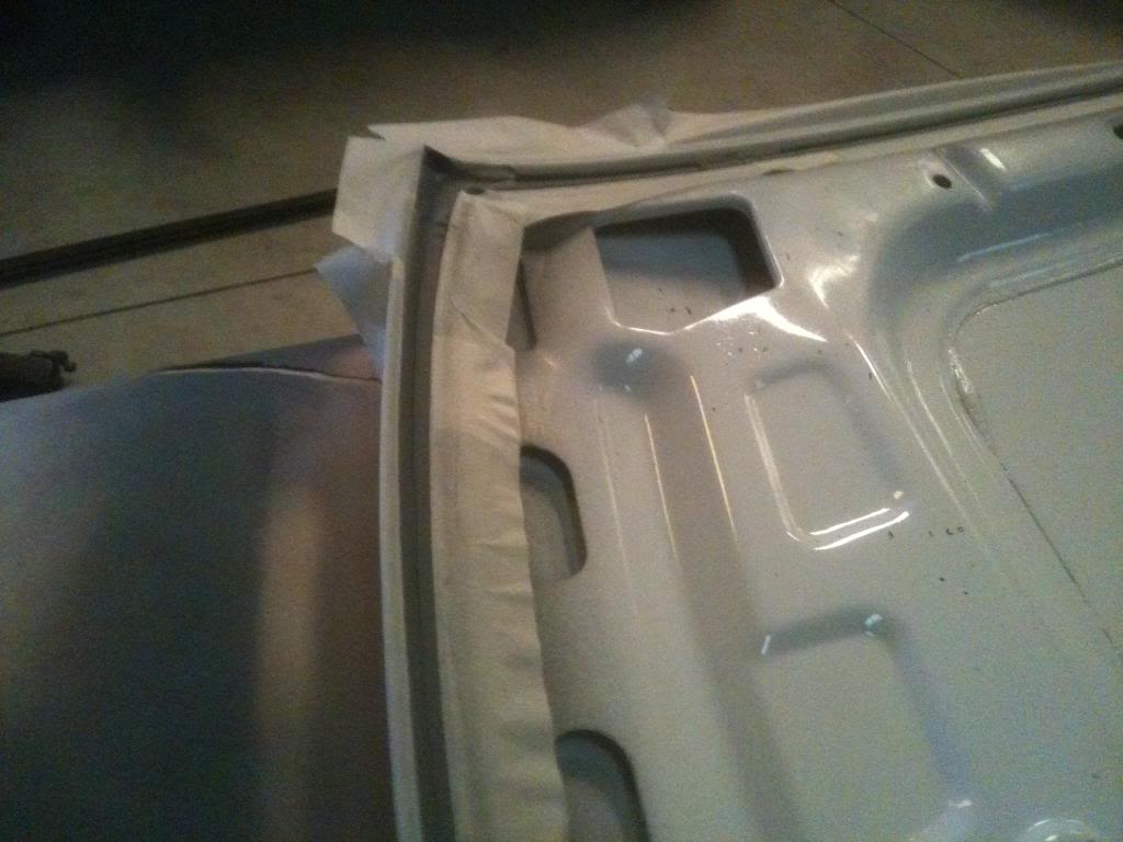

Ok some great news. just about everything is in primer now, just need prep the boot lid as I had to get a new one (the frame was cracked near the hinge brackets) , get a new front bumper and finish the rear bumper repairs.
I worked out how to restore factory seam sealer so it looks original.
for people's reference this is how its done.
Pick out all loose seam sealer
sand blast any rust out (i had none)
sand and scotch brite the shit out of those areas, even washing with thinner is a good idea to help the primer stick
prep wash it good many times
Prime it
Masking tape to the edges of the original seam sealer.
Apply seam sealer,
run finger to level it.
brush it smooth with a brush( can be damp with thinner to help smooth it better)
Rip off the masking tape right away while seam sealer is fresh.
This gives a smooth original look. mine turned out great and can barley tell its even been replaced as it seamlessly (no pun) blends from the new to the original sealer.
Now for the pics of the primer
