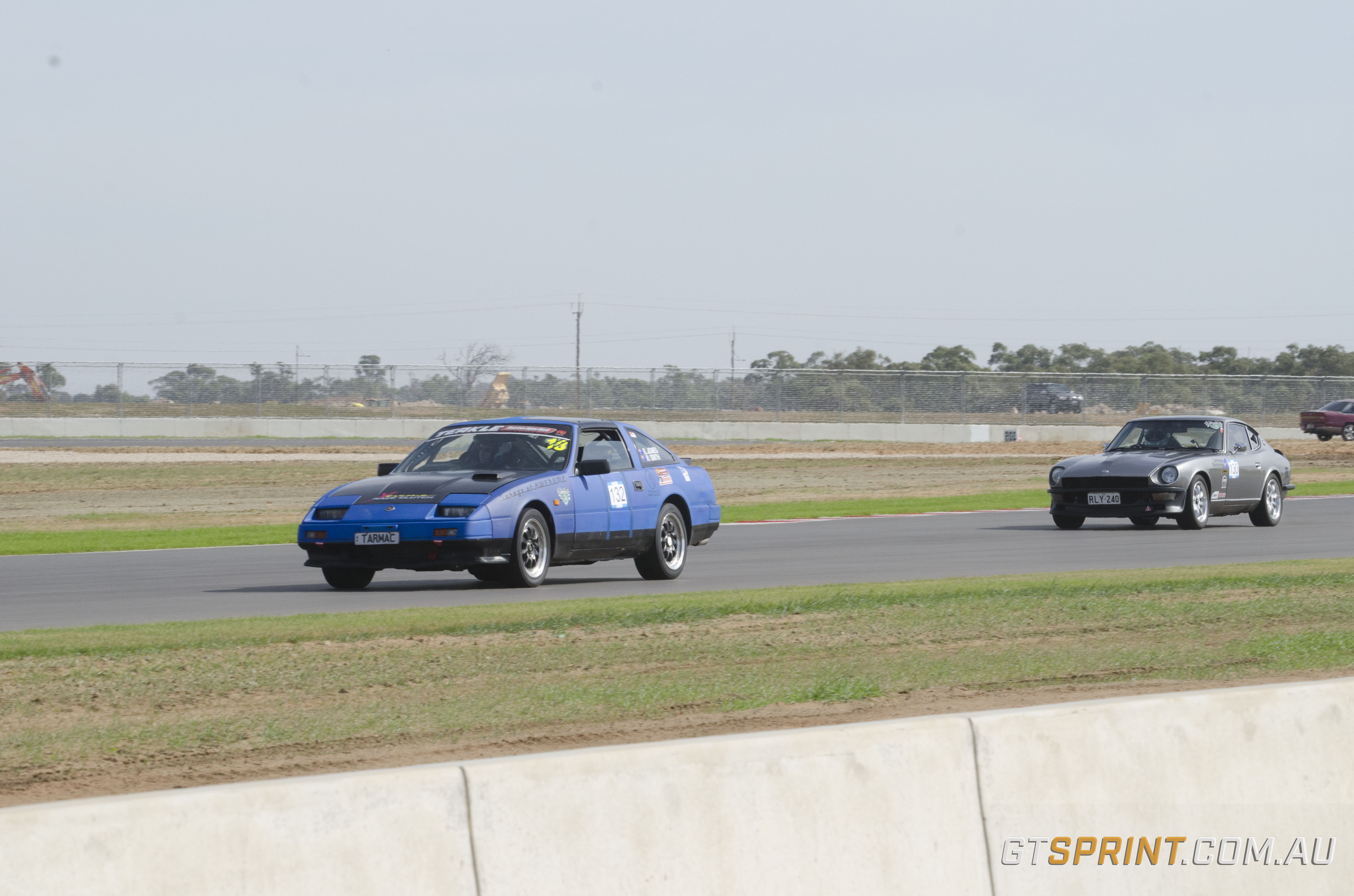

Re: Delco Nismo, 1984 300ZX VG30ET Turbo
And... we made Tailem Bend on the weekend for the GT sprint.
We weren't the slowest car there by a long shot and we had zero issues and just a great time had by all. Now running S13 coilovers and Nankang AR-1s which made for a much more dynamic package on the day if a little lacking in HP... NOW, it's time for the dyno
If anyone gets the chance to drive the long track at The Bend Motorsport Park, do it. It's like driving in Forza or GT. The track is wide and undulating and full of super cars
