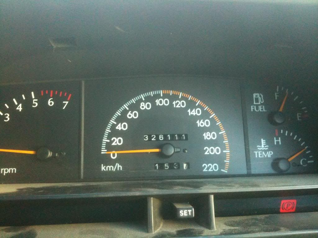

All good now with the fuel usage.
I clocked the trip meter when I filled it to the brim.
note the fuel gauge and trip meter, oh and also the temp gauge.

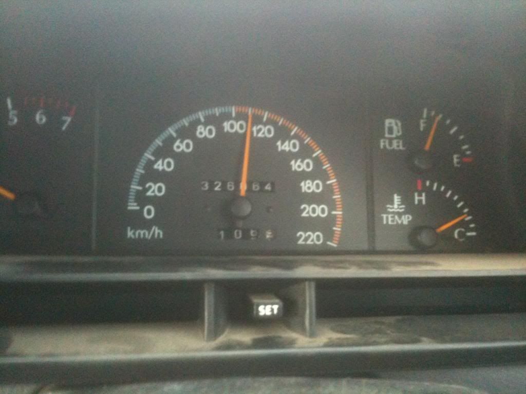

some 40 odd ks later.
