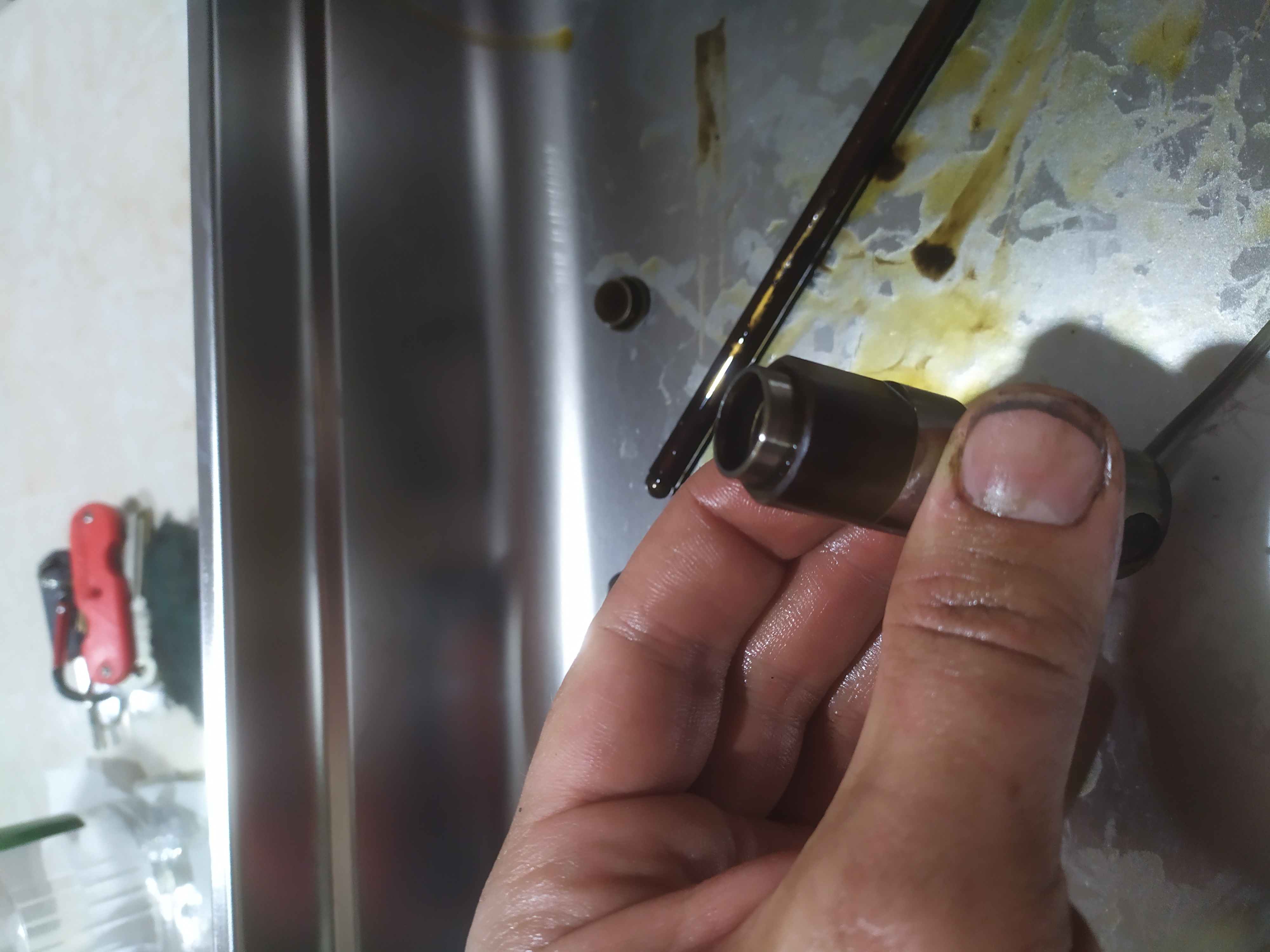

Well wagons ecotec got to 330,000km andd has a stuck lifter, pic shows it as far as I could get it out, it's jammed, funny enough that cam lobe it was sitting on was nearly fine and no wear on lifter roller lol, some of the other rollers and lobes are worn, #6 in picture was worn down with sharp edge, air check galleries seems ok, so will Chuck old cam and lifters in from old vt s/c engine I rebuilt for vs. what do you all reckon is that wear about normal for those KMS? Will prob source another lower km ecotec for future changeover

Re: Mrs The1 VX Berlina Wagon
Awe hell, it's got plenty of lift left, take a stone, polish off the edges a bit, throw it back in with another lifter and run'er!
She's good to go!
I have seen the wear on the last lobe on all engines from VN to VY and it's always on the last lobe.
I got 2 ideas what it could be, 1. defect in the casting process/bad case hardening. 2. valley drain hole is right above it, maybe possible normal wear debris is washed on to the lobe and lifter, gets run over by the roller and initiates the breakdown of the case hardening.
The stuck lifter was in #1 exhaust, other than that i prob wouldn't have known it was running quiet before with the occasional lifter tick at hot idle which was prob the start of the no1 going.
The earlier lifters are even worse, all of mine ended up sounding like a tin of marbles. Slowly over the years GM revised them half a dozen times or so till the ones we have now.
I use the direct replacement GM OEM lifters 17122490, they are really good, only thing is to watch out for is the preload, it's different from the older designs, it's 2.09mm.
