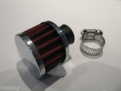

thought ide buy some more shit cause i can LOL fuel pressure gauge dodgy electric but i didnt really feel too keen on feeding a fuel hose into the car for now never mind the colour change i know its a little ricer but ill have it on white :punk: .and a couple of breather filters for the rocker covers so i can fit my VR inlet manifold without drilling passages in the heads for the PCV valve feeds also got a front facing thermostat housing for it so i have room down the drivers side for the cooler pipework also gives me the better fuel rails and regulator so i can fit my throttlebody out the other side :mrgreen: now just sit back and wait for the goodies to arrive in the mailbox ebayaholic nowdays :punk:

so whats the plan for attaching the breathers mate?

15mm alloy pipe welded in the covers i reckon probably straight up from the top corner so they are high and away from oil in the rocker covers since it wont be baffled in there could get a baffle welded in a corner for them dunno yet probably end up with a catch can at some stage just want them cause the vr inlet install is going to delete the PCV valve
