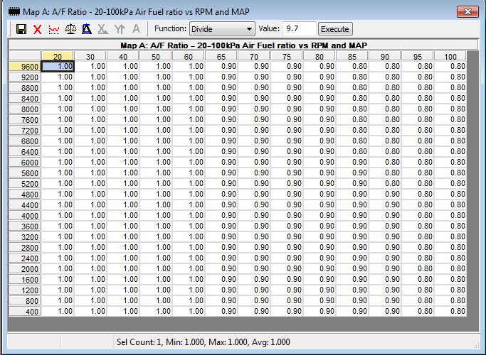

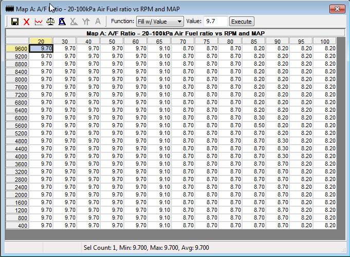

so what I have done below is showing firstly a E85 AFR table that I found in a tune .... its probably fairly similar to yours, and this is what your target AFR's are going to be in your data logs.
now this next picture is the same table divided by 9.7 (E85 Stoich Value) to show you the lambda equivalents which might help you understand it better.
you are correct that if you want to get the VE table to match the commanded you need to adjust it till the wideband reading matches target AFR ....
also just to confuse things a bit more for you
