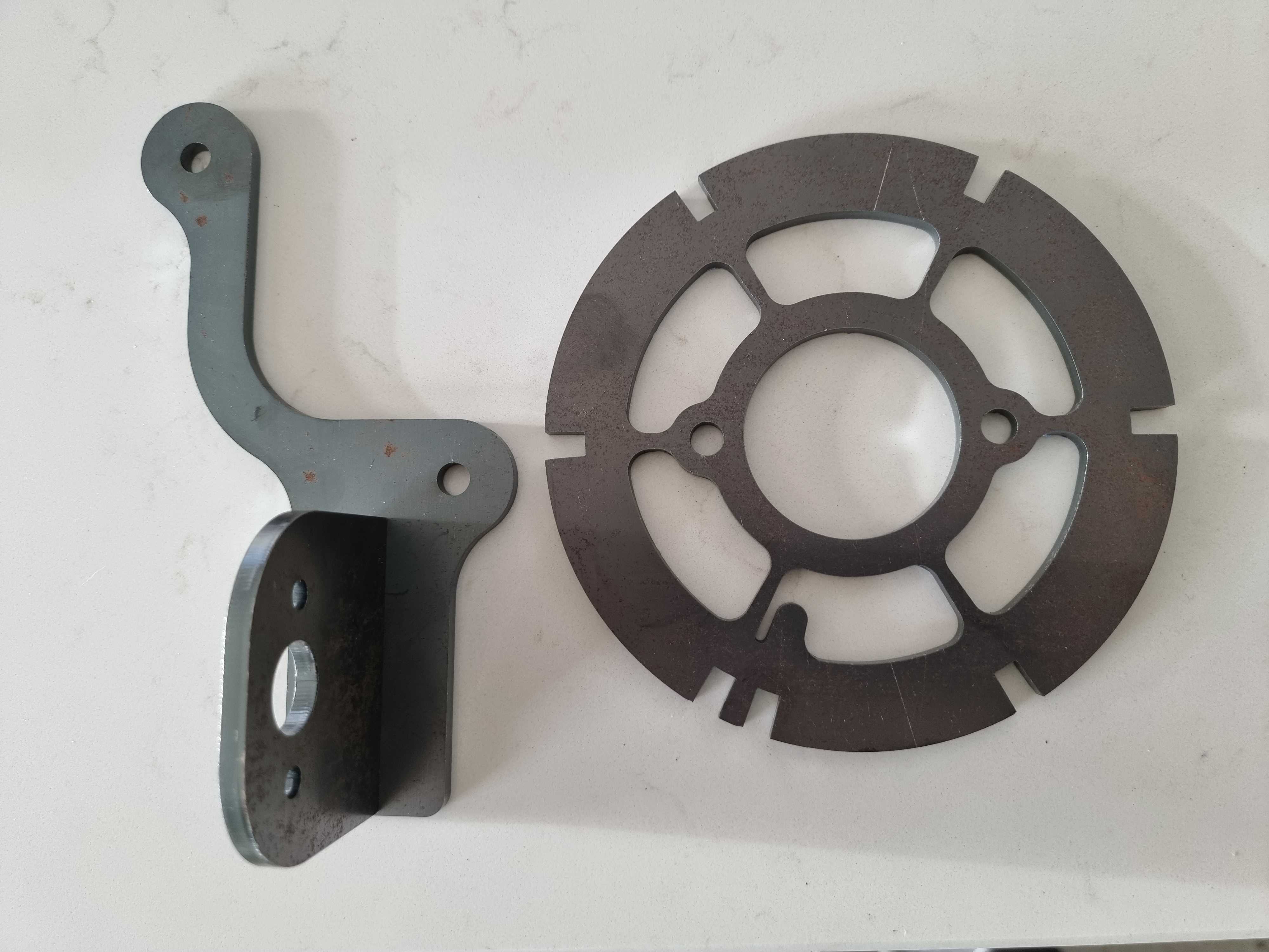

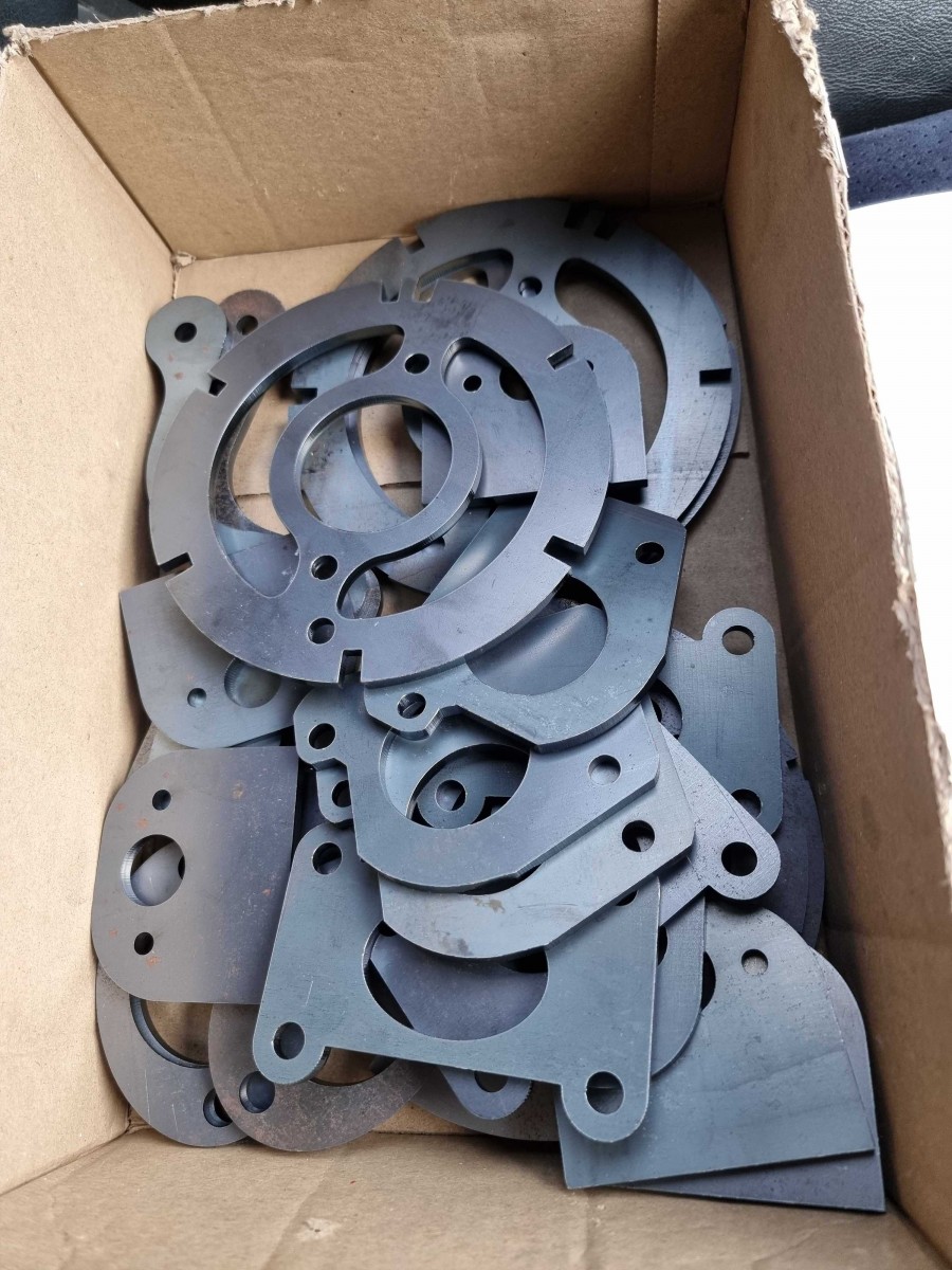

Hi Antus, where did you get your parts cut out ? how much ?
Posts: 9002
Re: Ants delco twin cam gemini
I think it was about $160 for 3 of each part. that was 3 of 3 each different types of trigger wheel and 3 each of a few sensor mount pieces all in 5mm mild steel. Not sure if thats normal price or just cheap because we got the cad side of it right and it was easy for them and didn't take time to just load it in to the machine for a small side job.
Posts: 2606
What their price and quality like?
Posts: 9002
As above. $160 for all that, quality was good.
Posts: 8118
Looks like they come up pretty good.
