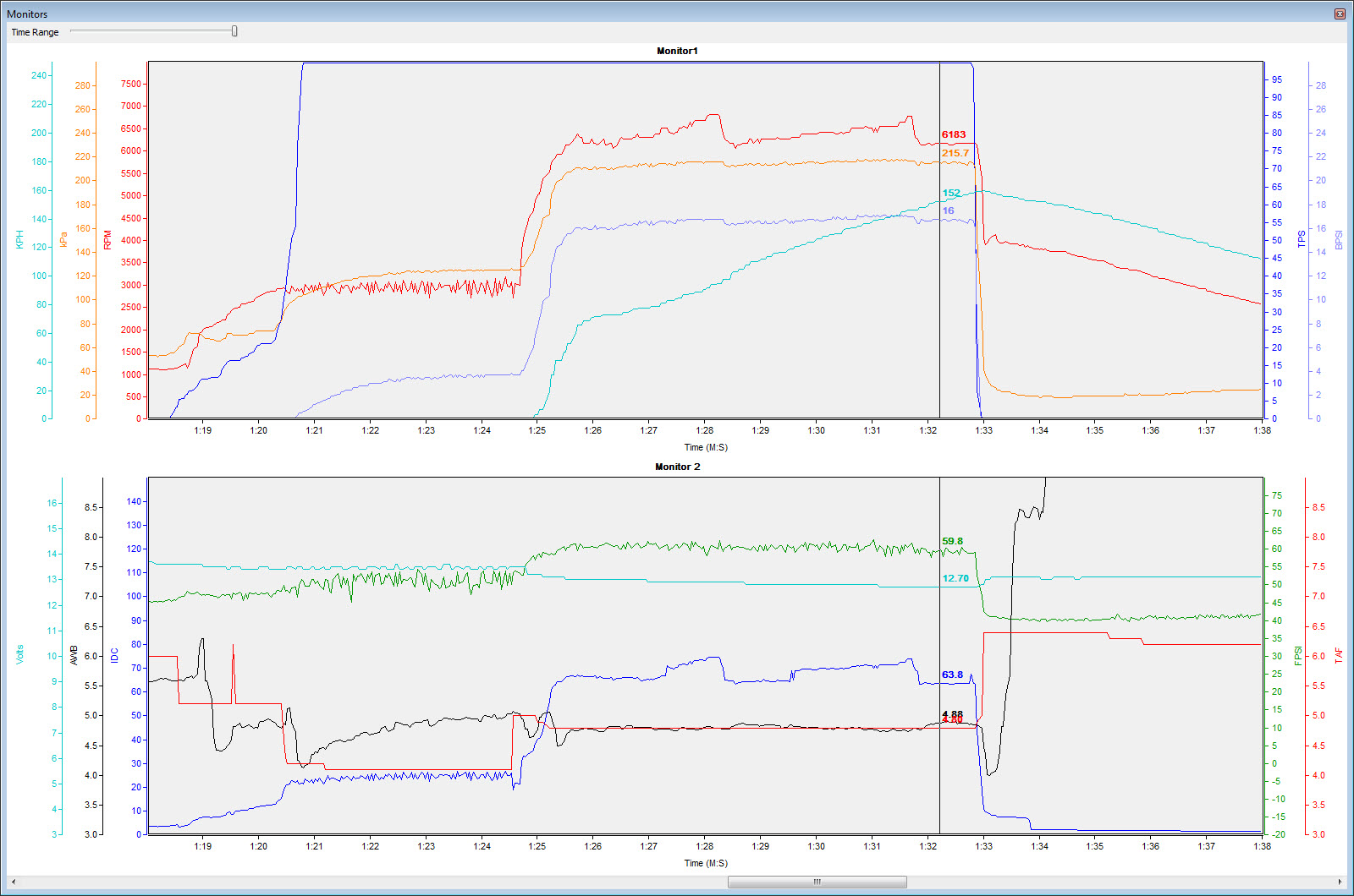

and here you can see the volts dropping a fair chunk when I get off the 2 step, I have set the second pump to activate on 4 psi boost, and I get 3psi on the 2 step, so just after launch it comes on and the volts drop .... anyways going to run it as it is with the new wire and see what results I get before I do anything else.
