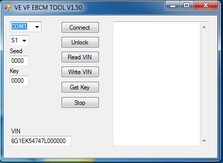

Although Holden say VE EBCM are one time programmable they can be reprogrammed as many times as you want , I wrote this app to do it.
EBCM TOOL.jpg (30.33 KiB) Viewed 6660 times
Posts: 2609
Re: TPMS For Non HSV VF Commodores
Niiicccceeeee :thumbup: :thumbup: :thumbup:
and where does one get a copy of this from?

Unfortunately its not for sale but if you need a ebcm vin changed let me know and I can get it sorted

vn5000 wrote:Although Holden say VE EBCM are one time programmable they can be reprogrammed as many times as you want , I wrote this app to do it.

Cobalt wrote:Do youhave seed keys for 2013/2014 Camaro it is not ve or veii
I have worked out the algo for ve s1 and 2 ebcm key , I need a few more samples of vf seed / key to work out vf ebcm algo , currently vf ebcm key is brute forced.
I have a customers Camaro ebcm on bench at the moment being unlocked via brute force method
