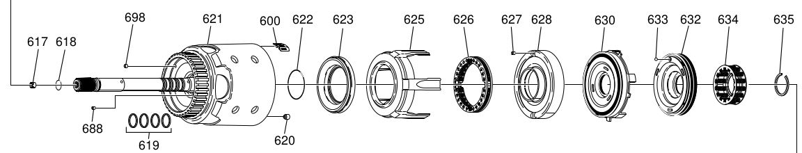

In my previous posts I mentioned the state of the clutches and seals were pretty much brand new, I believe as a result of a recent rebuild, so the only part that was replaced was the 2-4 band. Reassembly went perfectly with the exception of 1 hiccup. I spent a good hour trying to get the pump back on, and no matter what I did, it just would not drop into place. I eventually realized that this was because I had already put the turbine shaft "O" ring back onto the turbine shaft and this was stopping the pump from being lowered. Item 618 in the picture below. Removed the "O" ring and the pump literally drop into place.

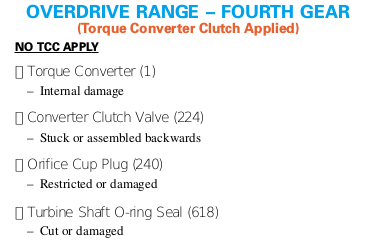

Never mind. I think I might have figured it out.Chuff wrote:I spent a good hour trying to get the pump back on, and no matter what I did, it just would not drop into place. I eventually realized that this was because I had already put the turbine shaft "O" ring back onto the turbine shaft and this was stopping the pump from being lowered. Item 618 in the picture below.
Taken from page 103 from the 4L60E Technical Guide:

Hmmm.. I guess with all that struggle getting it in might have damaged that O-ring seal?

Yeh, but hey, it's only a 5 second job to replace the O ringTazzi wrote:Hmmm.. I guess with all that struggle getting it in might have damaged that O-ring seal?

This time, however, I'm 97.5% certain that it's the turbine shaft "O" ring, so on an off chance, I went Googling, and found this:

If it takes longer than 2 hours to replace the O ring, or I break a sweat doing it, then I'm doing something wrong. And it's only going to cost $30.
