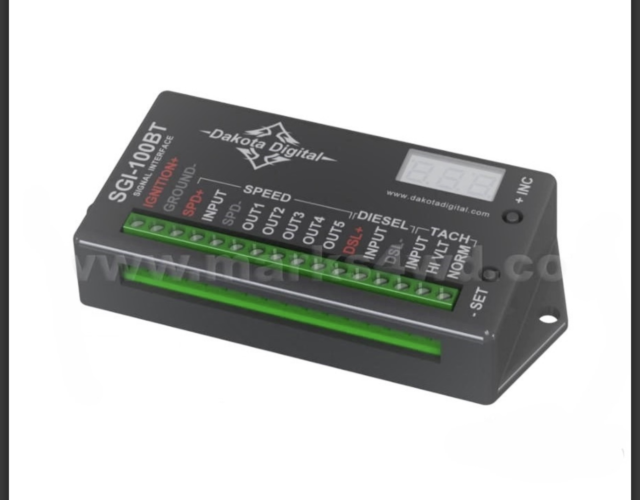

If you guys are talking about the little module to the lower left of the shifter thats the tach module mentioned in the initial image.

Madchuska wrote:If you guys are talking about the little module to the lower left of the shifter thats the tach module mentioned in the initial image.
Yeah, that’s what I was thinking, a Speedo/tacho corrector. Sort of looks like this.
I’ll let you know how he goes, so far he’s got the commands to my PIM sorted to get the dash to do what I need (eg. Cruise, fuel gauge, engine temp, so I’m guessing now he’s working on the interface side of it to pickup the VF GMLAN to rebroadcast the data that he knows needs to be sent.
