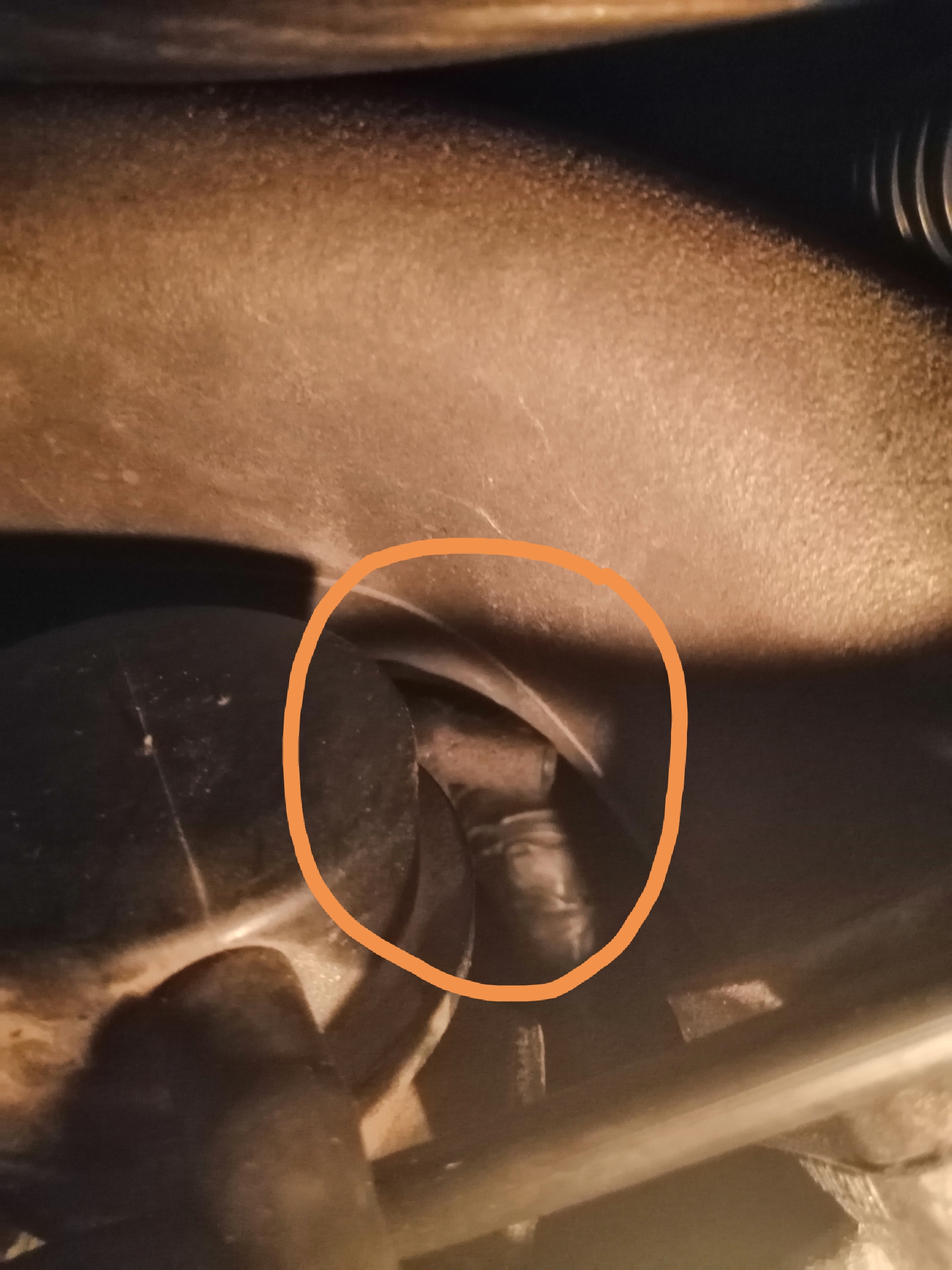

Mmm ok too easy thanks for your help it should be starting though there's obviously something wrong but what about that other hose ?

If you’re talking about the ones from the boost valve and the bottom of the actuator just leave them off

This one

That’s the elbow off the bottom port of the actuator. Just leave it

Where did that one originally go ?

Down behind the head to the boost solenoid
