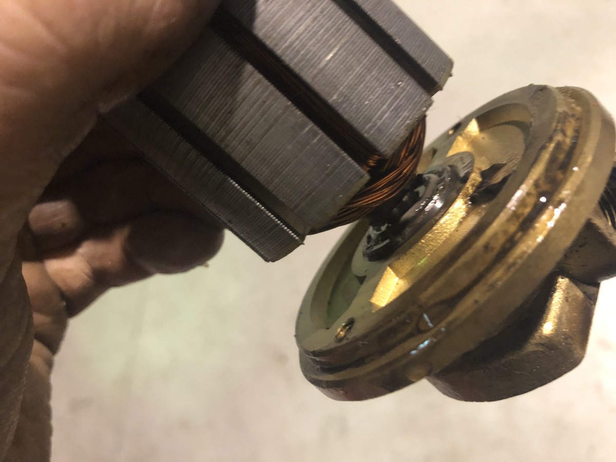

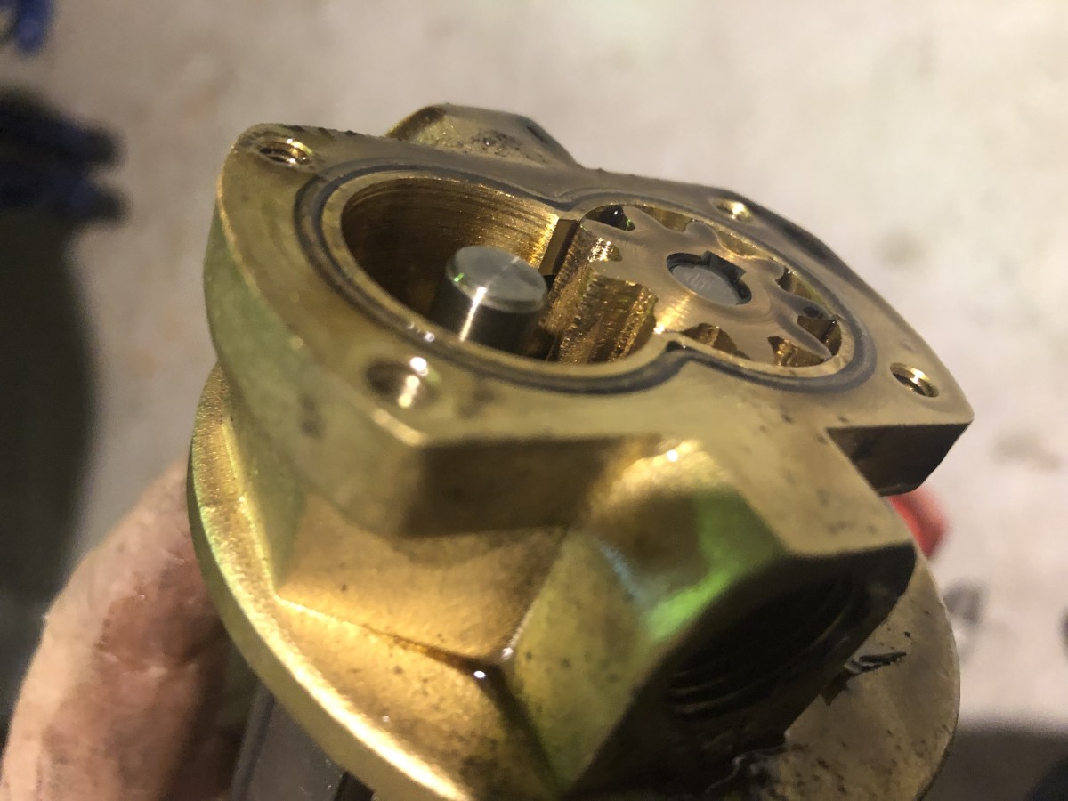

I just re-read this from the start, that oil scavenger pump is exactly the same type I have been using on my VE twin turbo. I have had nothing but drama with them, they don’t seem to cope long term with the oil temp. The seal between the pump and the electric motor dies, floods the motor with oil and burns everything...
Another thing to consider is the effect of blow-by on the returning oil to the crank case and its ability to stall the pump seeing it has no bypass valve.

wow those gears arnt loving it!
hopefully my pump lasts longer than i expect the trans to haha!
