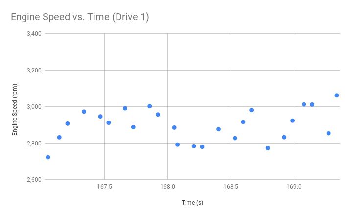

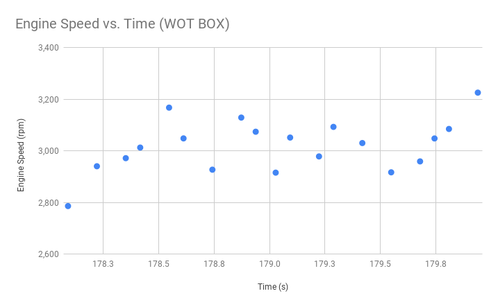

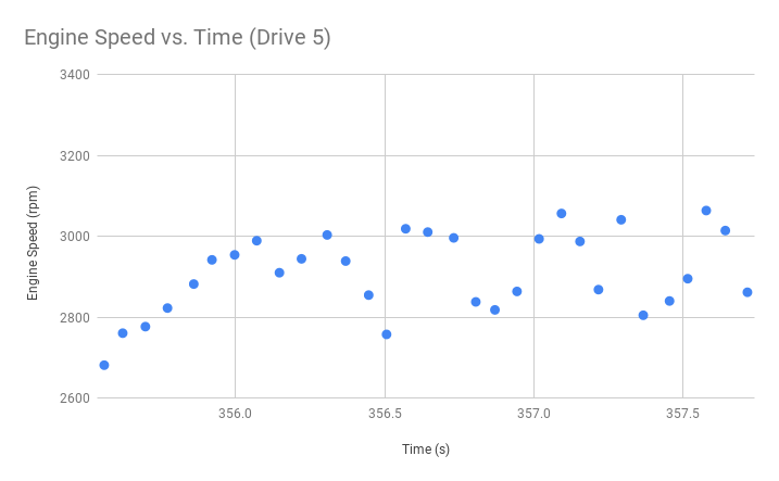

I did some more testing on my truck and the current logic isn't that bad as far as holding the RPM at the set point, but it definitely could be better.

Here are a couple tests in gear with the engine pushing up against the torque converter. It's barely going over the limit, and it falls pretty far from all the load.
Engine Speed vs. Time (Drive 1).png (14.56 KiB) Viewed 5270 times
Engine Speed vs. Time (Drive 5) .png (15 KiB) Viewed 5270 times
Here is a comparison of what the WOT BOX that I have used for this season.
Engine Speed vs. Time (WOT BOX) .png (15.37 KiB) Viewed 5270 times
So all in all it works fairly well, but I might try to do some sort of staged approach so that it doesn't cut all cylinders if it doesn't exceed the limit by much.

the difference here is timing retard and no timing retard. watch my test video again when i just manipulated the mapping to test the over all effect of it. if you want to be less aggressive and a more consistent cut you have to add timing retard into it with like -10 degress retard when the cut is active. just modifying dwell time alone and keeping timing wherever it is on the timing table gives slower chops.
