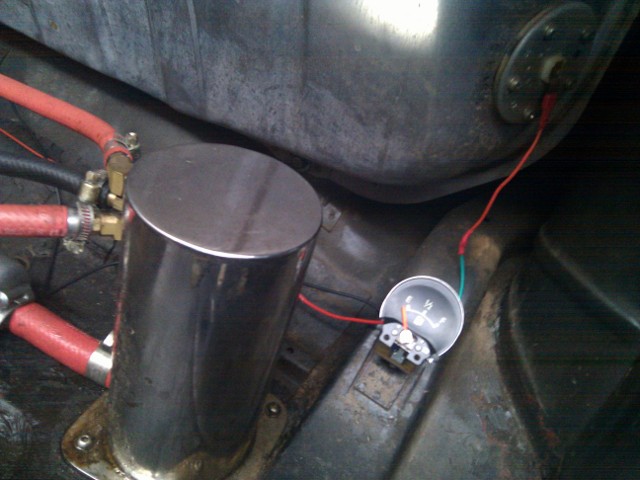

This pic is from when I mounted the dash guage in the boot (needed it to handle the 8v power supply from the in tank level meter!). It shows the current surge tank. The only issues are leaks from the old factory tank and a failing old factory pump.
So new tank and low pressure pump to feed the surge and it should be fine. This is the one my mate has recently installed in his track car, and im thinking along the same lines. Im not sure what pump yet, but im thinking something low pressure.
http://www.ebay.com.au/itm/151338971010
The current EFI pump was in the car when I bought it. Its unlabelled but the description is "500HP MERCEDES BENZ FUEL PUMP". I believe this one is still working fine.

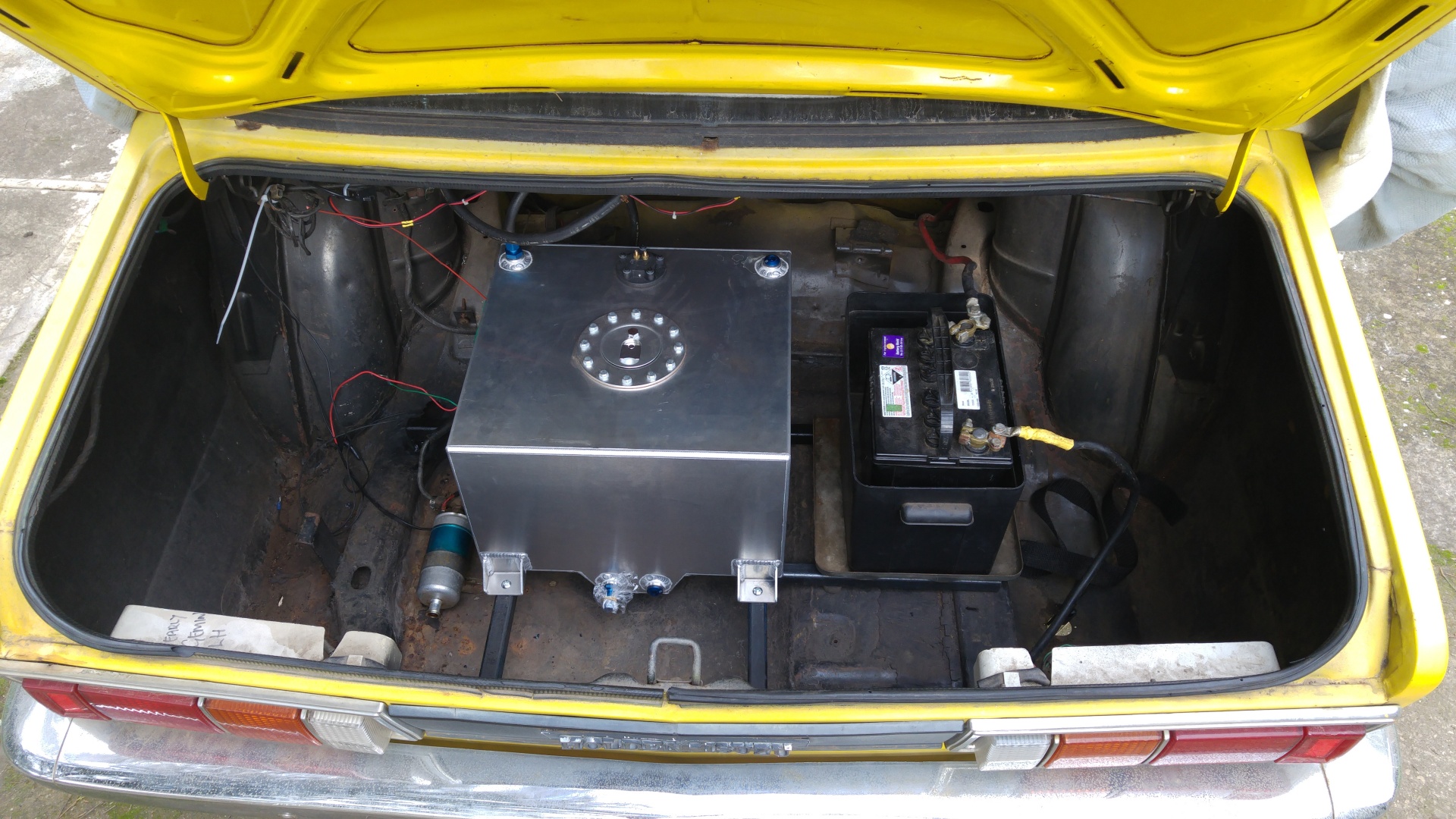

It was dry on the weekend and I had time so I got in to installing the new tank. I made up a frame that spans the chassis rails, and relocated the battery to the opposite side of the boot away from the fuel line boot entry. I picked a battery tray from the wreckers (mitsubishi starwagon :lol: ). Ive ordered a filter, some fittings and some hose to finish this off hopefully in the next few weeks.
Ive also re-routed the engine breather pipes in the engine bay. After analysing the flow diagram and learning that there is an oil separator under the rocker cover ive plumbed it so the expected blowby in the the sump is fed back in to the top of the engine where it passes through the oil separator before coming out the other side to the catch can. Hopefully thats oil problem solved but that'll be hard to test before driving it in anger.

That is the cell I'm looking at. Looks like it fits nicely. 8-)
Posts: 10436
Re: Ants SR20DET '75 Gemini track car
looks good man, whats that 30-40ltrs ?
