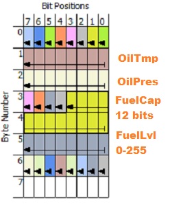

kur4o wrote: Thu Apr 25, 2024 10:37 pm If I counted correctly this is where bytes are stored from that message,
r31 is the offset they get stored in numerical order.
Now tracing down to individual bits will take some time, due to ppc crap code.
Here is how bits are copied for first byte , r4 is the bit position, some bits might get inversed

You seem to be headed in correct direction. The R3 values in Green are our Msg to Byte Positions 0-7. Further broken down to the bit level for split Bytes. Then there should be some scaling related math linked to our ADC values. But you're on it.
Maybe we should start a new topic on it. Looks like it might get petty deep.. :study:

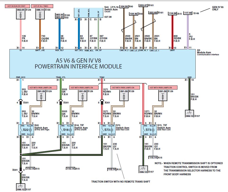

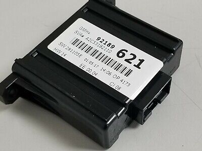

the vz 6lt was a special car, only produced for like 6-9 months because from jan 1 to september (slight production overlap with VE) they introduced euro 3 or 4 emissions at the start of the year & i suspect because holden had already worked all that shit out for the upcoming VE model, they used the engine powertrain setup from that, rather then continuing with the 5.7 LS1 controller.
PIM module does ALDL translation for BCM/Dash Cluster, Cruise control stalk also gets wired to PIM.
VZ pim.JPG (129.48 KiB) Viewed 4254 times
I'm going to start pulling the 4l65e out of the vz now & put the 6l80e in place. I'm just going to dummy up some wiring to the t42/NSBU wires before i modify the engine harness.

That is an interesting piece. Not a complete body control module, however it has 2 pair of canbus wires. GM had a tendency to do that with a few modules like the TCM's. Basically they were just daisy chaining some the nodes together to save wiring. However for that PIM module, I would like to see where those both run. Typically if you check for continuity between the matching colors, will tell you if they are linked on the board like all the rest. It's possible that has gateway duties, and if so, there will be no continuity between the 2 Tans and TN/Bk. I didn't see any single wire CANbus there like would go to a dash.
For your particular swap situation, I'd start looking for your preferred TCM OS that would have came in a Corvette up to 2014 I believe.. That should work with your Holden chassis straight outa the box. Anything later years, like a T87, ain't likely to work because to my knowledge GM scrapped all those ID's from all code.. So it limits the years, but opens up some hardware. Hope that helps..

kidturbo wrote: Fri Apr 26, 2024 6:01 pm That is an interesting piece. Not a complete body control module, however it has 2 pair of canbus wires. GM had a tendency to do that with a few modules like the TCM's. Basically they were just daisy chaining some the nodes together to save wiring. However for that PIM module, I would like to see where those both run. Typically if you check for continuity between the matching colors, will tell you if they are linked on the board like all the rest. It's possible that has gateway duties, and if so, there will be no continuity between the 2 Tans and TN/Bk. I didn't see any single wire CANbus there like would go to a dash.
Heres the factory diagram for the VZ Can bus.
I'm think i'll be good on this upgrade as holden released a ve commodore in 2006/07 with similar tune files that came with both the t43 & t42 to export to Saudi Arabia. I've already got the different switches defined/mapped out already.
I've now got the 6l80e box in, just need to do some temporary patching & runs the trans cooler lines before i can attempt to start it up again. then it's new tail shaft time.
forgot to mention im using an early 08 tcm which should still be compatible.
