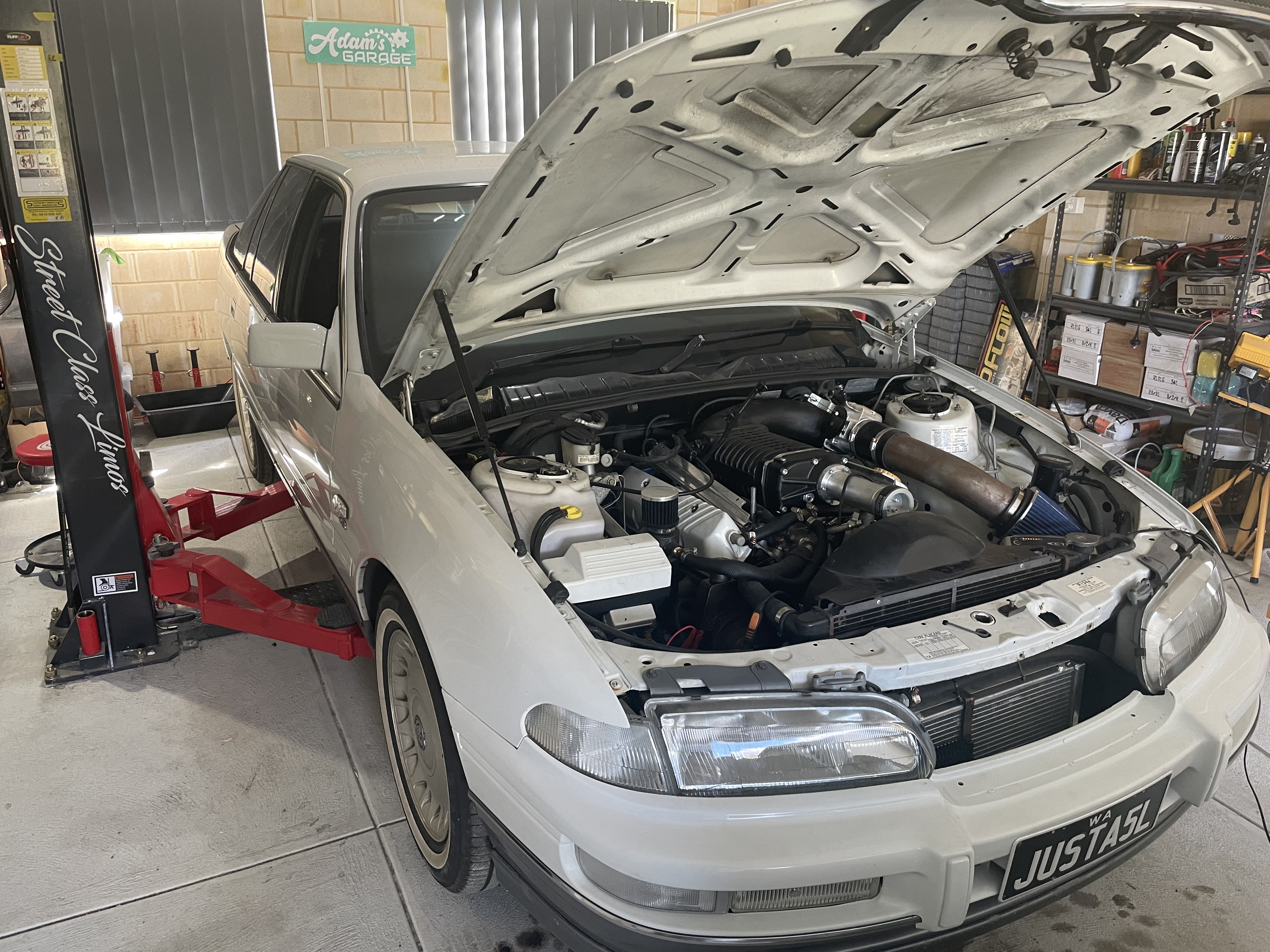

we have success now the throttle body was the reason for it not going into idle mode he bought a massive holley sniper billet unit and just couldnt get the blade to close enough and get the iac up so we're running a standard ls1 throttle body now with a a jerry rigged throttle cable with a piece of string until we get a new cable sorted :lol: . had a bit of a scare the other night though as it was doing great tuning up ok until we backed it out the drive it coughed and spluttered and wouldnt take any throttle and looked to be breathing out the catch can hard and oil smelt like a good portion of fuel. dropped the oil and cut the filter open all ok heaps of grey looking oil but no chunks. fresh set of plugs oil and compression test and we're sitting happy at about 155-160 psi 5 psi variance so happy with that we put the grey oil down to the break in lube and the fuel down to the old ebay injectors as it hasnt had an oil change since we put it in. not only that i decided to recheck all the vac lines and found that the compressor bypass valve had been plumbed into the underside of the charger so was always trying to create boost. got the vss sorted and we can now consistantly hit boost with no issues and the ve table is really starting to come together just little tweaks and fine tuning he’s already excited that much he thinking about party pulley mode but told him to wait until after the wedding :lol:
