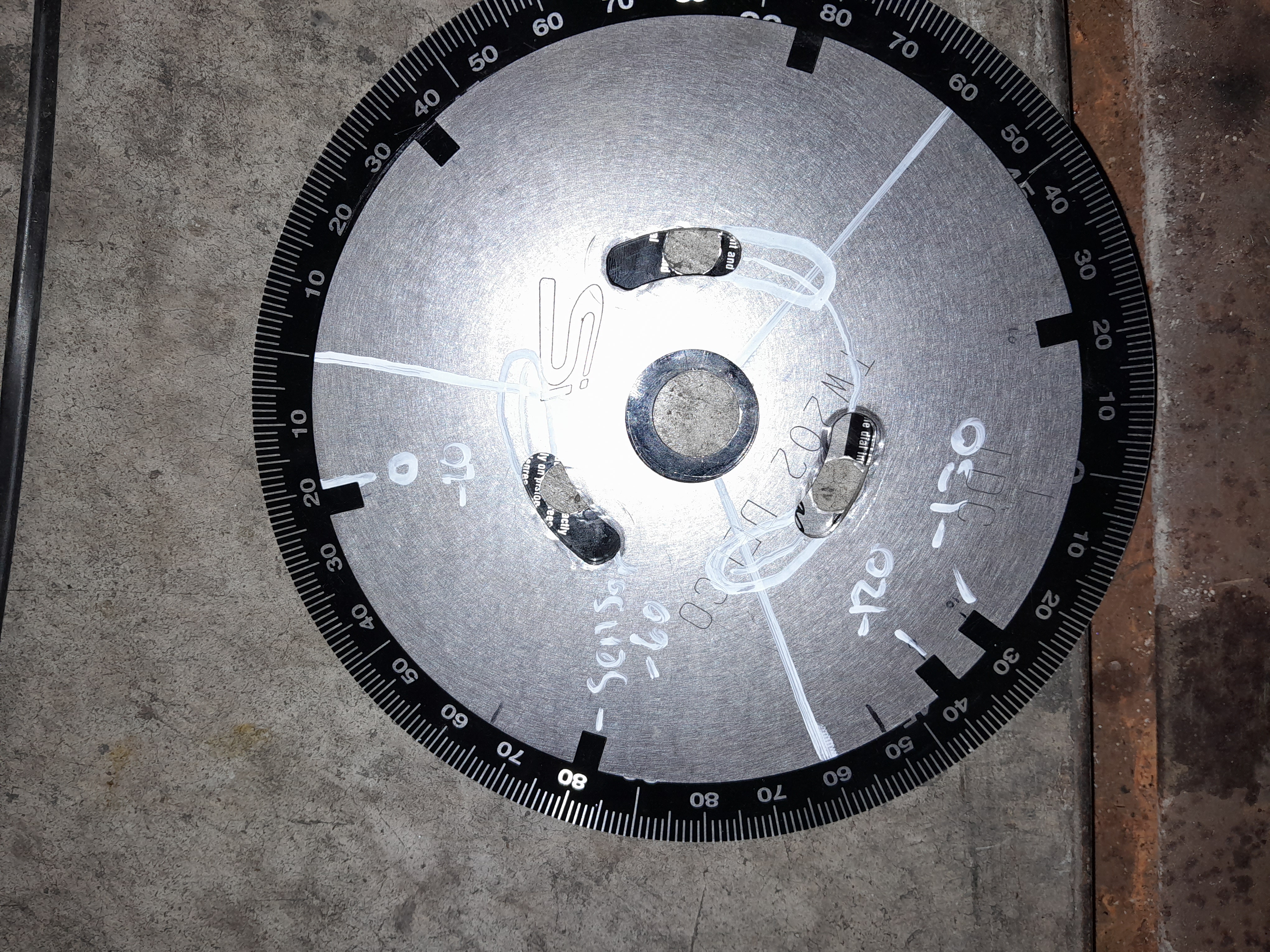

Re: Converting 202 to DIS
Wheel re installed.
Checked tdc while cranking and its firing at. 60 later than it should.
So looking at the picture it's firing on the notch lined up with the sensor when it reaches tdc and every second notch after that.
Would have thought it should be firing on the notches 60 earlier or before to line-up with engine timing

Just a thought... it definitely fires both leads attached to the coil at the same time??? If not I've made a massive false assumption
- Posts: 10111
Yes it fires the cylinder on the intake stroke and the exhaust stroke at the same time. The one that is on the exhaust stroke is known as the 'wasted spark' as it does nothing and is wasted. Its purpose is because the ECU cant tell which stroke its on without a cam trigger. So by firing both a crank trigger is then enough. That last photo looks correct to me, the sensor is on TDC and the +1 is at 70, which marks its partner (the one immediately before it) as the reference for the PCM which is at 60, as configured in software.
