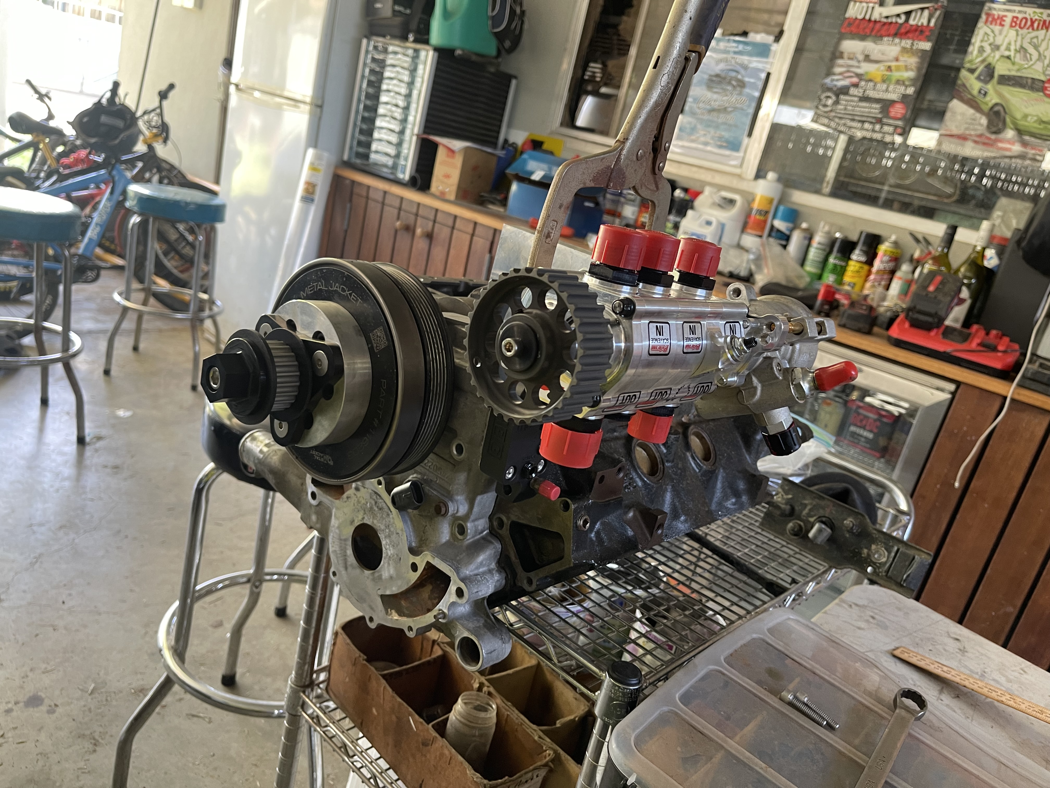

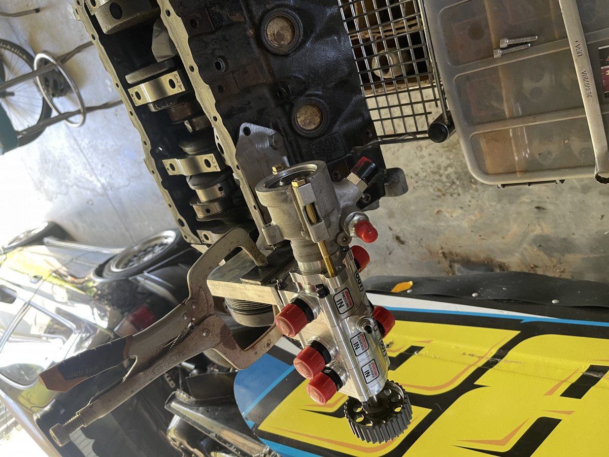

Also, I have a large amount of updating to do, I have all the parts now to finish this project with exception of the belt. The pump is dummied up to the old block, the tank is mounted in the rear of the car, pics to follow.
Posts: 2605
Re: Ecotec V6 Dry sump
Posts: 8114
Is that a PS pump at the rear?
Very nice setup so far! :thumbup:
Posts: 2605
Yep, they offer a power steering pump adapter to run off the rear. It makes it a nice setup
