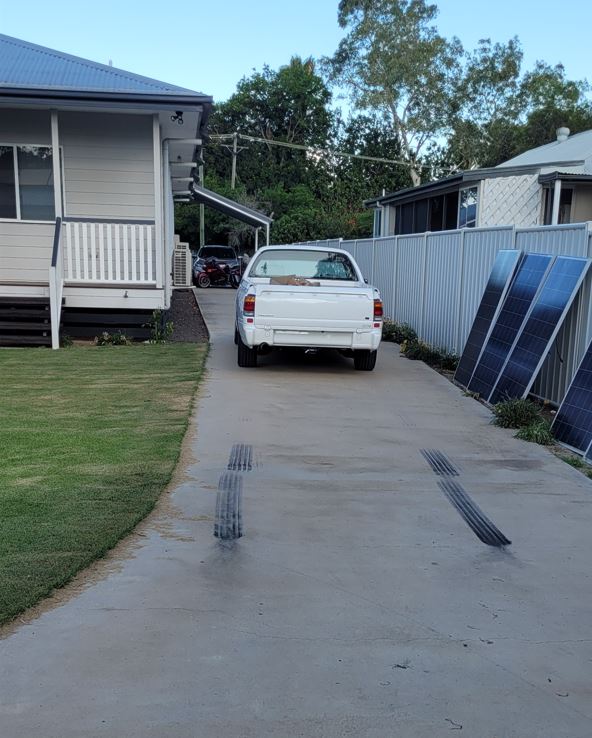

Managed to get it RWC and it has been registered and insured for a while now.
This is it on the freshly mowed zoysia. Needs a wash already. Yes it is bright and yes it does look a bit bland without the side mouldings. And no it won't be winning any car shows. But its not too low at FE2 height so it can be driven. And yes I need to adjust the bonnet alignment.
These are possibly the last photos of the ute with no dents.

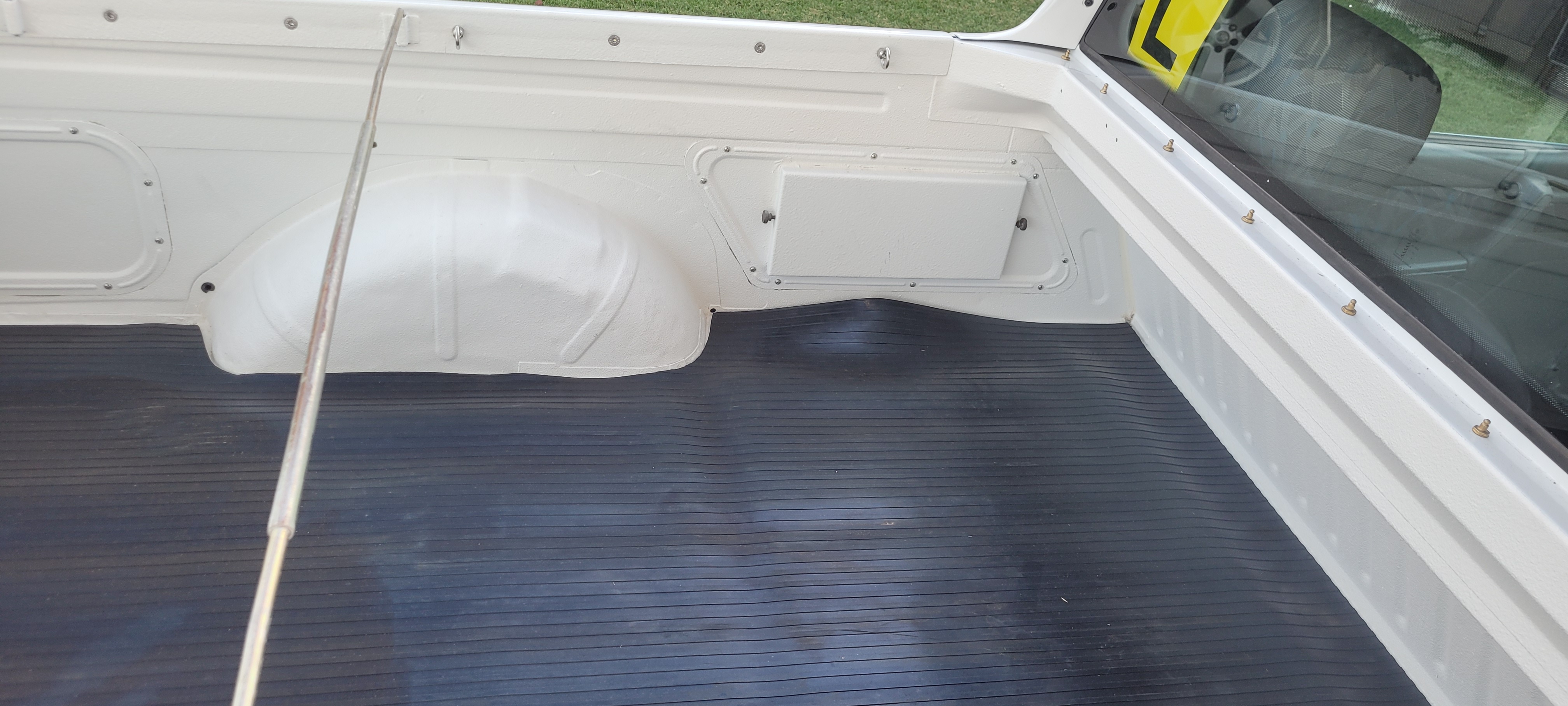

The toolbox in the tray has come up pretty neat too. Thinking a screw Toyota jack might be the go to put inside it, but just not sure they go low enough for a Commodore to change a flat tyre.
It's got provision for two tonneau cross bars but only have one in there at the moment. I've also fitted some tie down rings at the top of the tray
