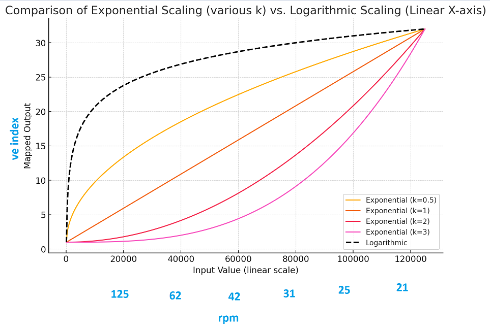

I knew RPM scaling for array would be bad at one end, but after sitting down and doing a little math, holy hell. 6,000 is already at one end of table.
Don't stress specific units.
AngelMarc
- Posts: 613
- Joined: Sat Apr 08, 2023 11:23 am
- cars: A CB450 running to 8,000RPM with a P59.
Re: Coding my own aftermarket ECU
Apparently I need logarithmic scaling or exponential with a tiny fractional k value.
Obnoxious.
The scale on the left should be output values 1-32, and the 'graph' section should be whatever input value.
Anyway, looks like exponential k=0.1 is good start. Maybe logarithmic is smarter.

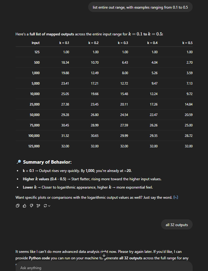

The "input" numbers are microseconds per 15 degrees. That's where that divide by 2,500,000 came from.
Since that's what's counted to get sync, that's what the rest of the code uses. Minimal conversion math, minimal of... doing the same thing.
You either have 2 timers per cylinder and reset each of them per event to avoid timer overflow, plus whatever you need for the sync logic, or you have one timer with such a large overflow value that it isn't a problem, and just count your offset each cycle.
Those graphs are about measured microseconds per 15 degrees (RPMtime) pointing to which row of VE table. Need fancy scaling for that to not be... bad.
The conversion math.
https://chatgpt.com/share/6847ba68-6228 ... b7015287f4
The result of that divided by 24, because 1 tooth vs an entire revolution.
A layman's loose summary would be, one thing doubles while the other is just plus 1. Those 2 things can't line up well without a little extra work.
