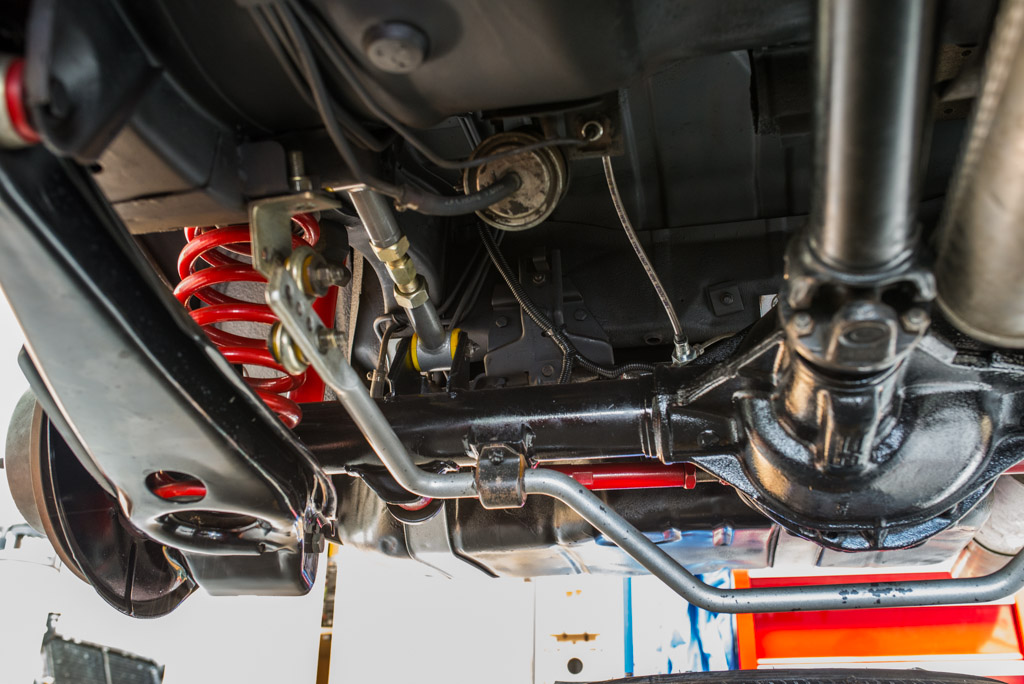

Been a long time with no updates, progress has been slow but all the suspension, brakes and under body is now finally finished....

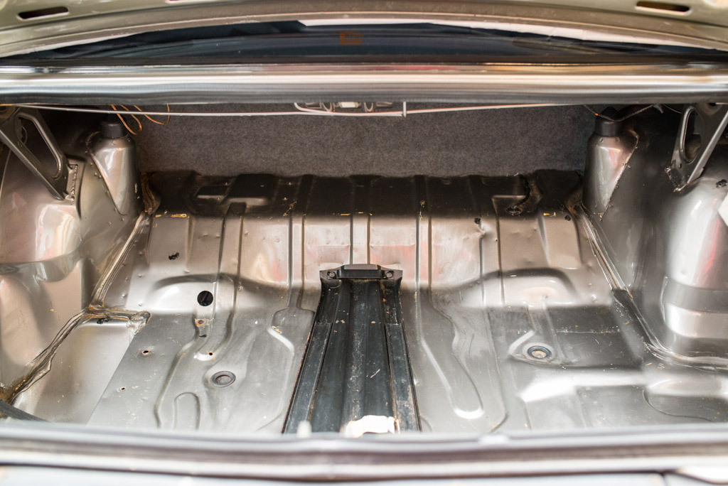

Few things to finish on the interior (changed the dash colour slightly) and a few small engine bay bits but its all pretty much complete. Next job is to fill this area up....

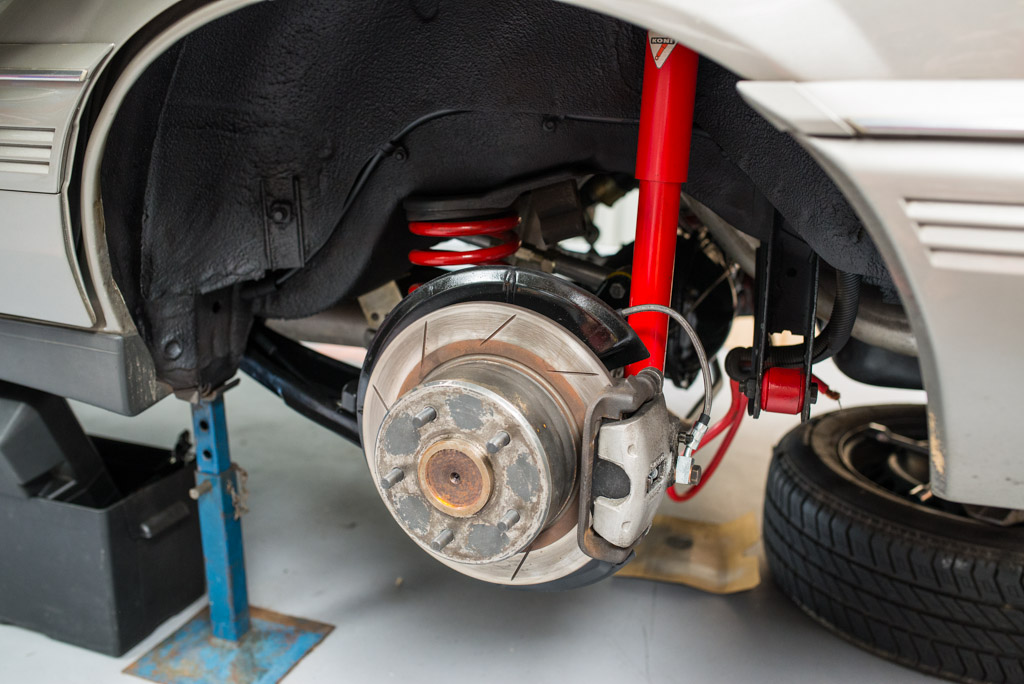

Good work noticed the brake upgrade, any plans for the rears?
Re: Toyota Powered VL Calais
Nah no upgrade at this stage, they work ok with standard rears on the street and occasional track use. Both ends have QFM pads which help.

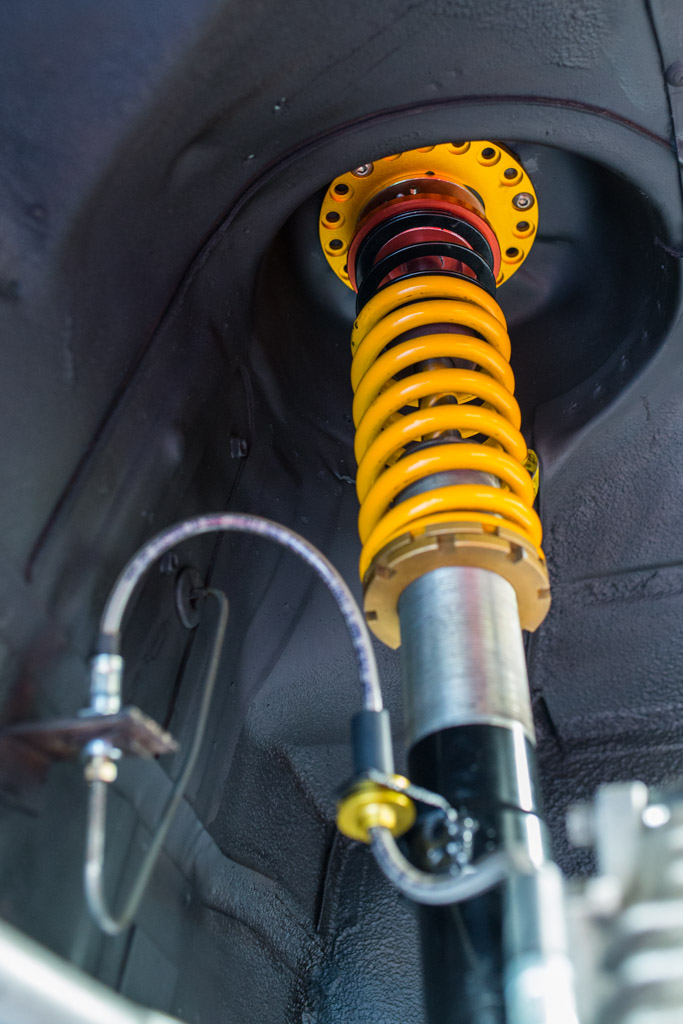

You will love the coil overs best idea ever.

Dylan wrote:You will love the coil overs best idea ever.
Have been in the car for over 5 years now, and yep much improved handling having access to different spring rates :thumbup:
Had to replace the strut tops as the old Noltec ones had fallen to bits. They were made using the old crumbly poly, had a heap of other bushes in the car that did the same :( All replaced now though.

Vt twin piston caliper, DBA T2 rotors, conversion hubs, safe brake braided hoses, coil overs, koni shocks?
nice!
white line sway bar nolthane bushes?

:lol: looks good, whats the coil overs you have there?
may i suggest using superpro bushes. They will shit all over those in durability and functionality.
I have had my mine since 09 with over 150k of rough as guts terrain and they are still going good.
