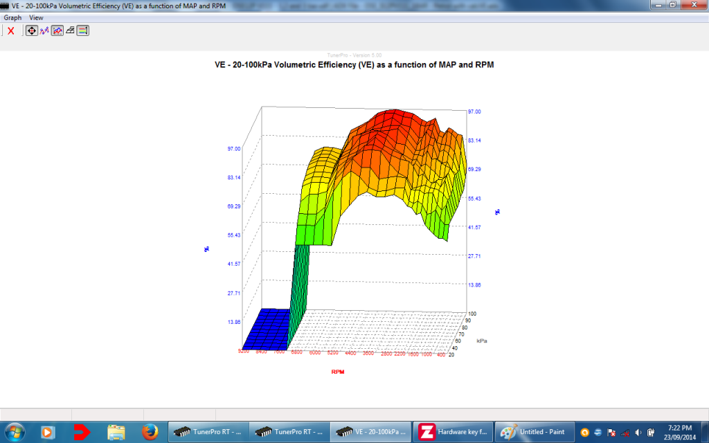

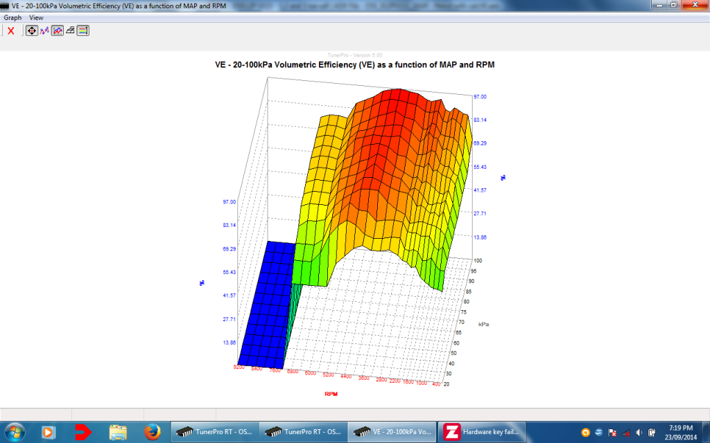

Yeah dyno time is what I need. VE table has been updated yesterday and is looking very close now.

So a new log with the fatter VE and the monitor shows the target follows the WB just about perfect where yesterday it was a bit leaner in high revs.

VE getting nailed though.
