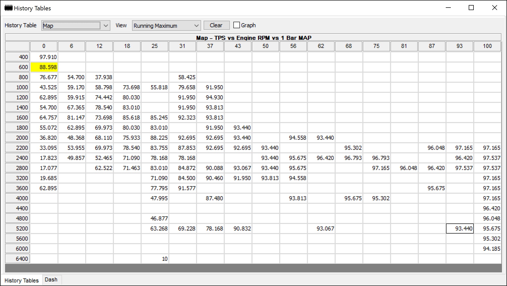

How's te MAP code running? Any others testing it to?
Re: The1's Daily
is that just logging to get map data ?
Re: The1's Daily
yes it's just logging the map sensor, i havn't yet ported my code to vs.
Re: The1's Daily
can't hurt to have plenty of data for when the time comes
Re: The1's Daily

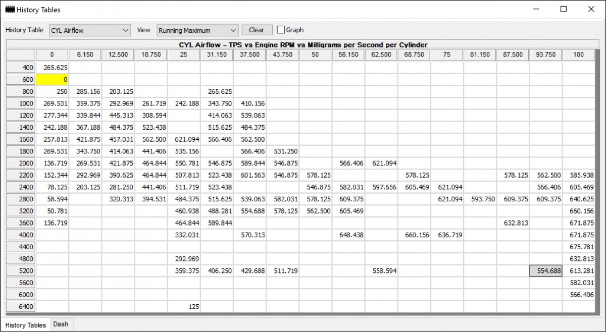

Out of interest is there a way you can calculate a VE value from the MAP data and the MAF readings you have now?

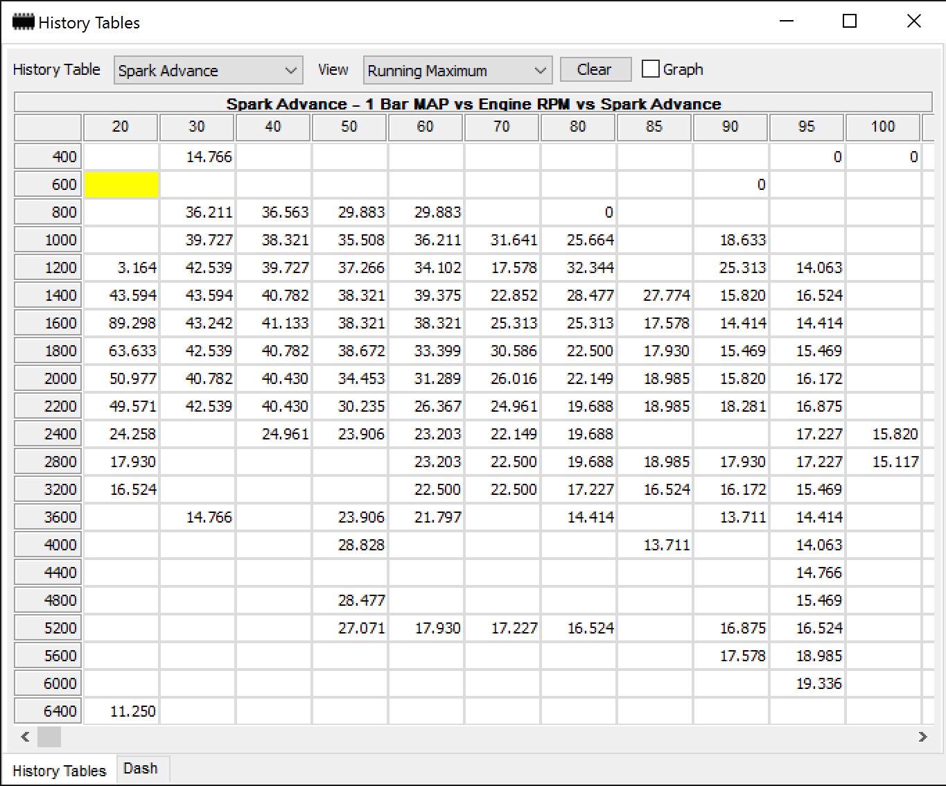

That timing figure of 89.298 degrees at 1600 rpm cant be right.
